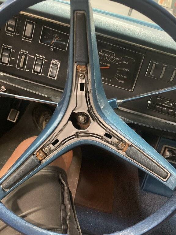

How do I get to the steering wheel nut? It appears that the front cover is snapped in place.
it appears that this one snaps in but may interface to the steering wheel differently.
Any help will be appreciated.

Got the cover off and will proceed with the horn buttons.

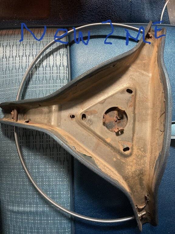

I had purchased a different horn button (see below - scrawled new to me) and it appears that I am missing at least one more piece to attach the new to me part?

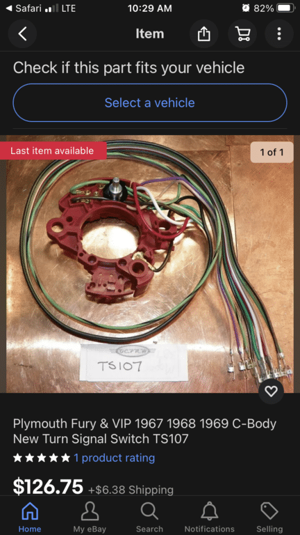

If anyone has a definitive answer for the replacement turn signal switch, I would be grateful for a link.
I believe that the replacement is red and covers 67-69 like the picture below:

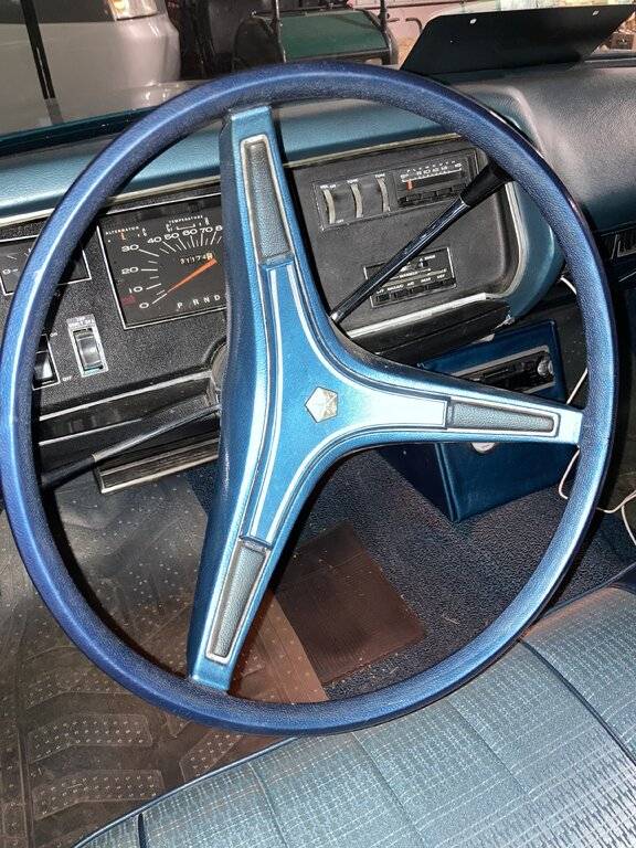

I think your issue is, your car had been retrofit with a 71-73 style steering wheel and the one you bought is a correct 69 style.
when I get home from work I can take a photo of the style of steering wheel you need for the 69 style. I'm fairly sure I have one in my shed still.
Nick
Nick
I wouldn’t be surprised if the wheel is non standard. I am discovering additional modifications that make my head hurt.

I just finished putting in a new switch in my 69. Fury. The one in your picture is for telescopic columns. Mine is not and I used this
When I pulled my original I found 1 wire had worn thru the casing to bare metal. Sometimes it would ground out, sometimes not. Plus one of the cancel cams was cracked. I'll warn you though that this replacement works fine but does NOT seem robust. The plastic seems thinner and the wires a smaller gauge. I would have just patched up the exposed wire if I didn't think the old plastic was going to break anyway.

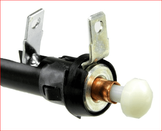

If its just brake lights dont forget to check this switch at the base of the column. For me it had just slipped from its mount and the plunger was sliding off the pedal when pushed.
Brake light switch has been checked out and is good.

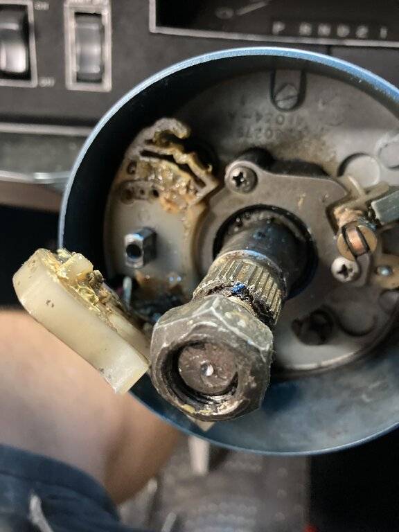

My suspicion is that the turn signal switch is garbage and I fully expect that I will find a cobbled mess inside the column. Just bought a wheel puller, so the surprise is forthcoming…

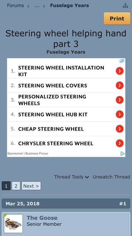

Check out this post I did a while back. Pretty good picks of removal and install of the replacement 69 Fury wheel. Kind of exactly what you’re doing...
I took the turn signal switch apart and it looks well used. I was able to get the passenger side brake lights to work after bending the wire that’s riveted to the directional portion of the switch. However, no joy on the driver’s side, except when I jumpered both sides.
I ordered a replacement switch from Classic Industries Classic Industries | Restoration Parts | Mopar Parts | Camaro Parts | Firebird Parts | Nova Parts | Impala Parts | Chevy C10 Parts | Tri-Five Chevy Parts, part number MD2139.
I suspect that much will straighten out upon installation of the replacement switch.
