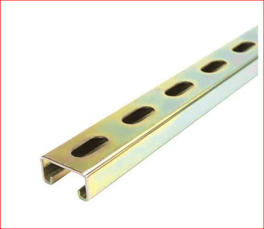

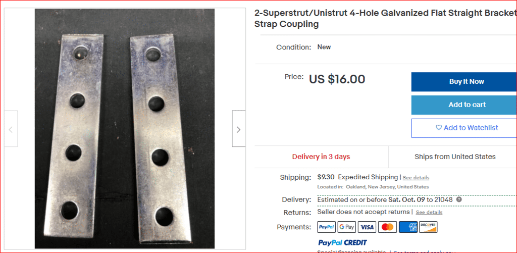

Perhaps something like this to keep both floor and seat track holes where they are but provide some adjustability. This Superstrut stuff is heavy 14 gauge steel and uses 1/2" mounting hardware.
Or the channel itself but it will raise the seat a bit.

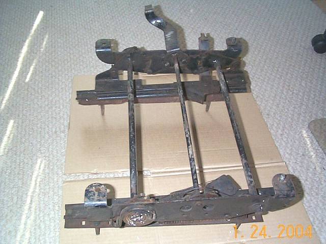

I guess I didn't make myself fully clear. I thought there was a separate set of holes further forward on the actual seat frame, which would put the seat back by some 2-3 more inches. No modifications would ever be made to the actual floorpan.
I know on my 67 Barracuda (buckets) and my 69 Polara (bench) if you take the seat out and look at the studs on the bottom of he seat you will see a couple other mounting points to move the studs on the seat adjusters. I think the default location is the middle, you might gain an inch, not sure if you can drill more.
On the bottom edge of this picture you can see the mounting studs, the holes on each side are the alternate mounting locations.
Alan
Apr 27, 2021
87
39
Minneapolis
Alan
This exactly what I was talking about...
HWYCRZR
May 13, 2015
4,128
5,709
Fargo, ND
‘68 Polara bench rails have three mounting holes. As stated above you can press out the studs and move them to the next hole. May give another 1”-1-1/2” movement back.
