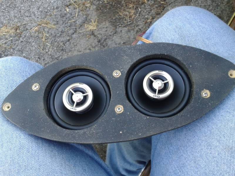

    Here's what I did with my '70 300 convertible.

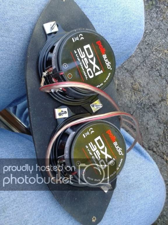

    Front speakers are two Polk Audio mounted on a piece of MDF that I cut to fit the front speaker location. You can also buy these adapters, but I don't have a source.

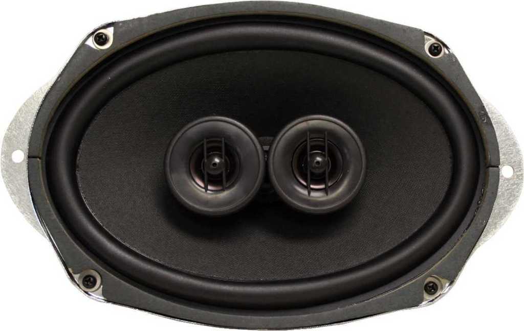

    Rear speaker is a 6 x 9 dual voice coil Custom Autosound speaker. Mounts in the stock location.
    CUSTOM-AUTOSOUND.COM
    This basically serves as two speakers. Left channel feeds one small mid-range/tweeter and right channel feeds the other. The larger part is the woofer and that's fed by both channels. Retrosound also makes these, but my experience with them has been abysmal at best. They don't seem to last, can't take their rated power and don't sound as good as the Custom Autosound speakers.
    BTW, they also make this in a 4 X 10 that will bolt directly into your front dash. Same thing, dual voice coil, 2 channel speaker.

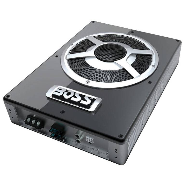

    For some added bass, I use a Boss Audio Bass800 powered subwooofer. BASS800 - Boss Audio Systems
    This is also mounted under the rear seat.

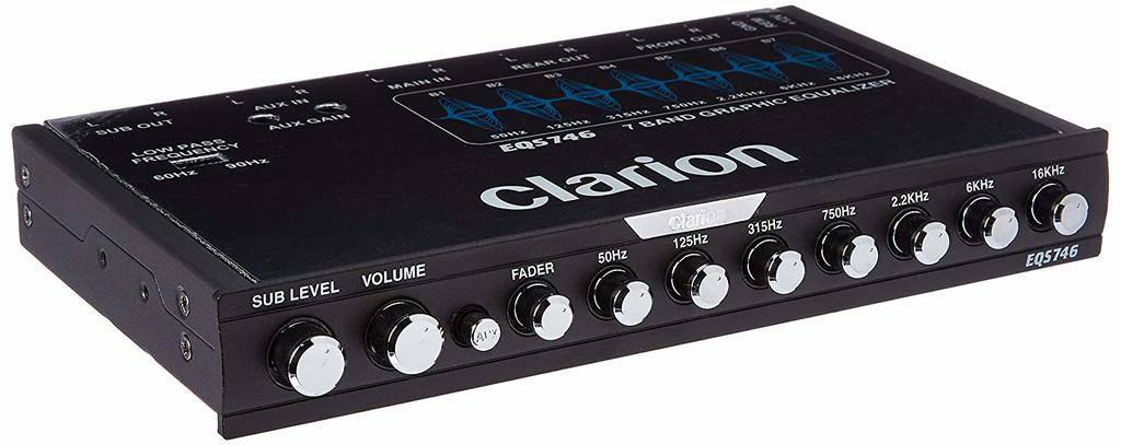

    I use a Clarion graphic equalizer EQS746 to control everything.

    The EQ is mounted vertically in the console. I cut a slot in the compartment and you open the lid to access it.
    My console was already cut up and repaired, so it wasn't too hard a choice to do this. My XM radio is in there along with an additional power point and a USB for input to the radio. But, in hindsight, I wouldn't recommend mounting the EQ there.

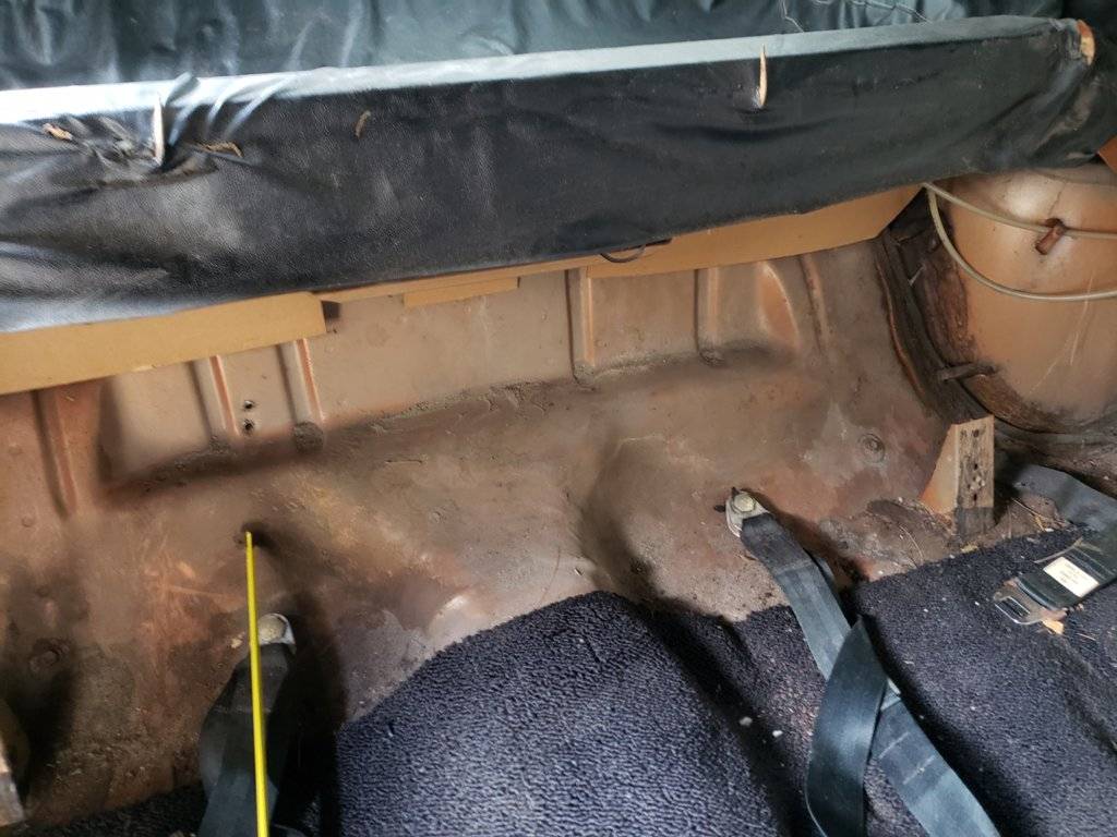

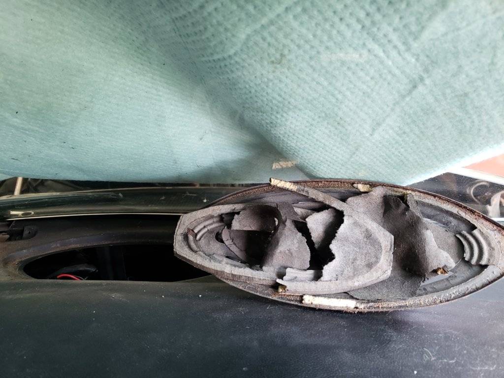

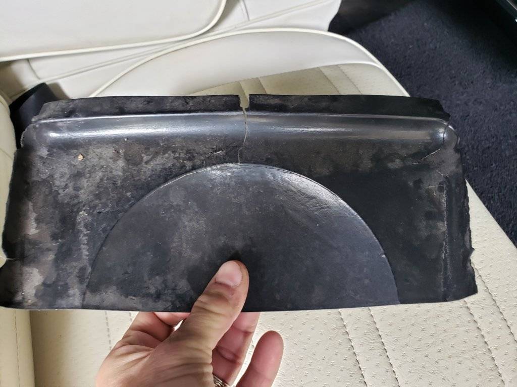

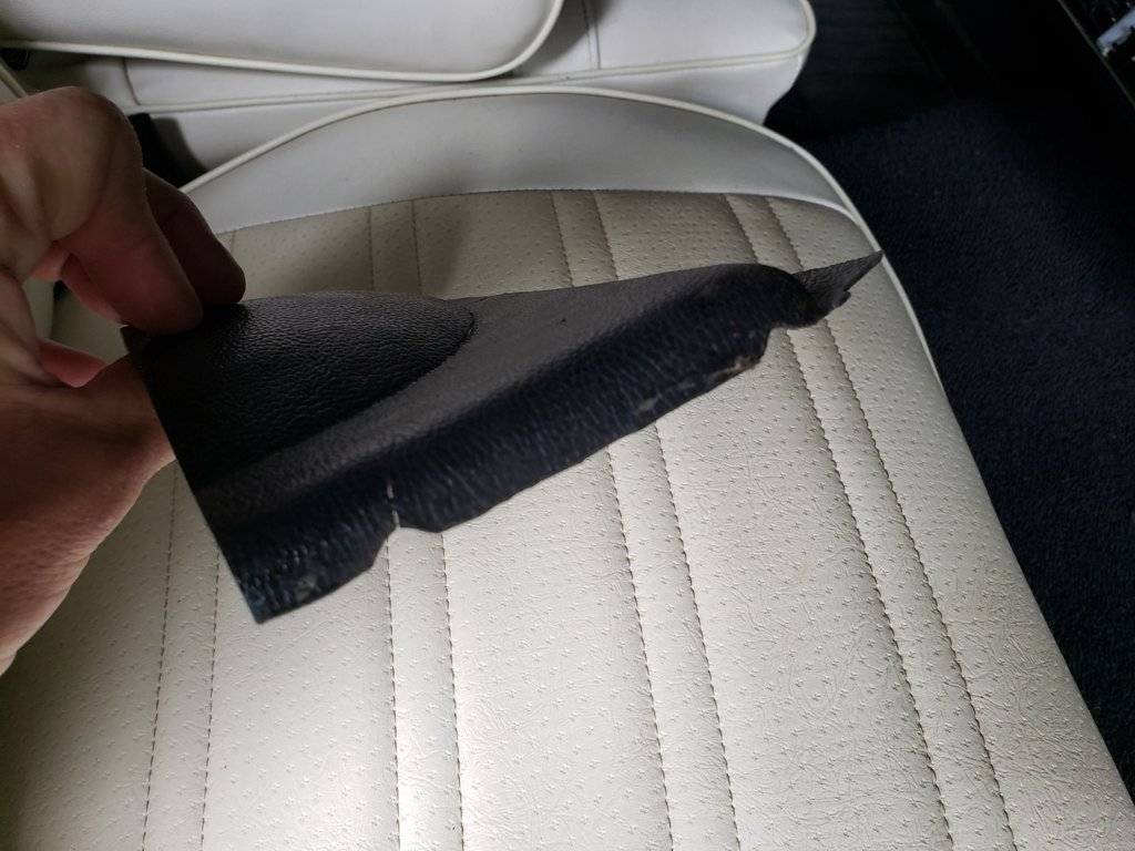

    Thanks!!!! I knew I had seen a 'single speaker' that had stereo output. I will put that in the rear opening. As far as the front speaker...when I was installing my AC evap and gauges, I saw up under the dash a center speaker, (big oval thing). Does that dash speaker go in from the top, or do I have to fish my way from under the dash to remove and install a setup like BigJohn has in the dash? I'm hoping from the top...seems easier.
    For back seat bottom....how hard is it to remove the bottom so I can put the amp and sub under there? Its raining today, so not going to mess with anything today.

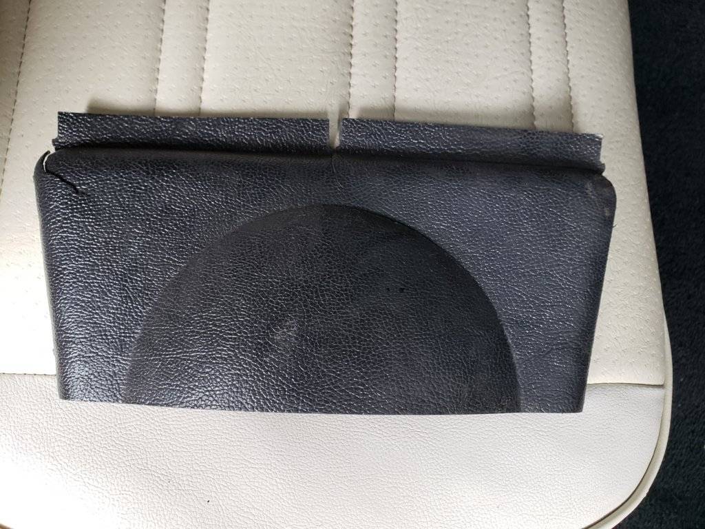

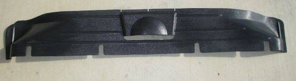

    Here are the pics of this plastic cover, which I will have to repair. Is this an OEM piece? I didn't see any markings. I held the piece up in place, but I don't see away to fasten in place. Maybe some tabs broke off??

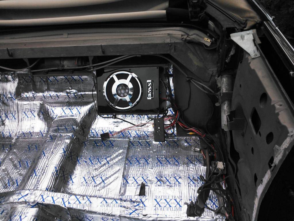

    Bottom of seat comes out by pushing down and towards the rear of the car to unlatch, then comes up from the front.
    Here's where my amps are mounted. This was taken before installing the 4 channel amp.

    There's a lot of room in there! WoW!! Thanks for the pic!! I was worried about space...looks like plenty!

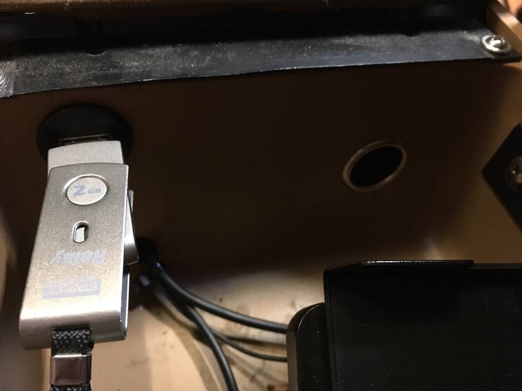

    EQ mounted in console. Note XM mount, memory stick for tunes and SPF 60 sun screen for when my pale self has the top down.
    USB and power point (we use to call these cigar lighter plugs) Power point was done before XM mount, so not in the best spot.

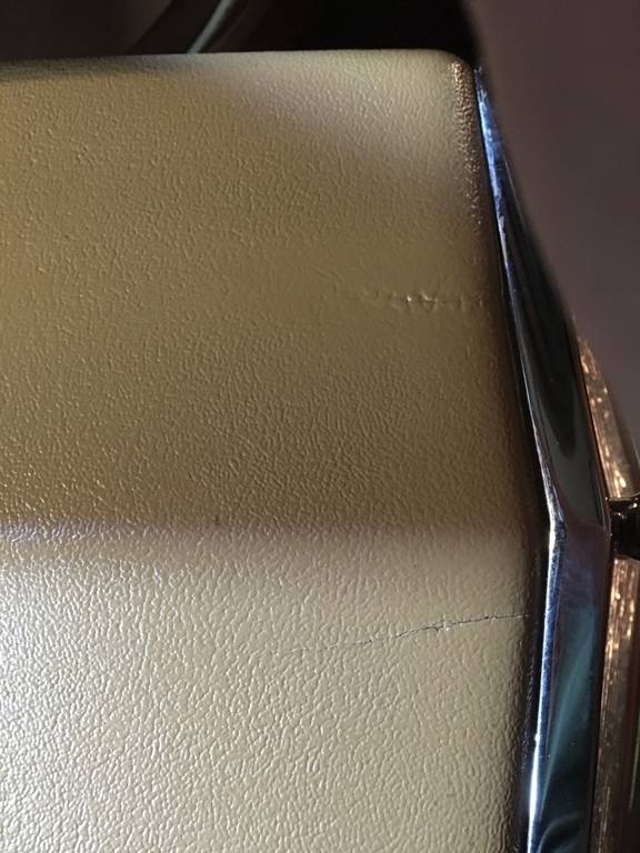

    Crack to fix near old repair. This is gonna take some research to find out how to do the texture correctly.

    Rain stopped, Indy on hold...so since BigJohn said rear seat and dash speaker were easy to get to, I yanked 'em! Poor speaker! Couldn't even touch it without it falling apart.

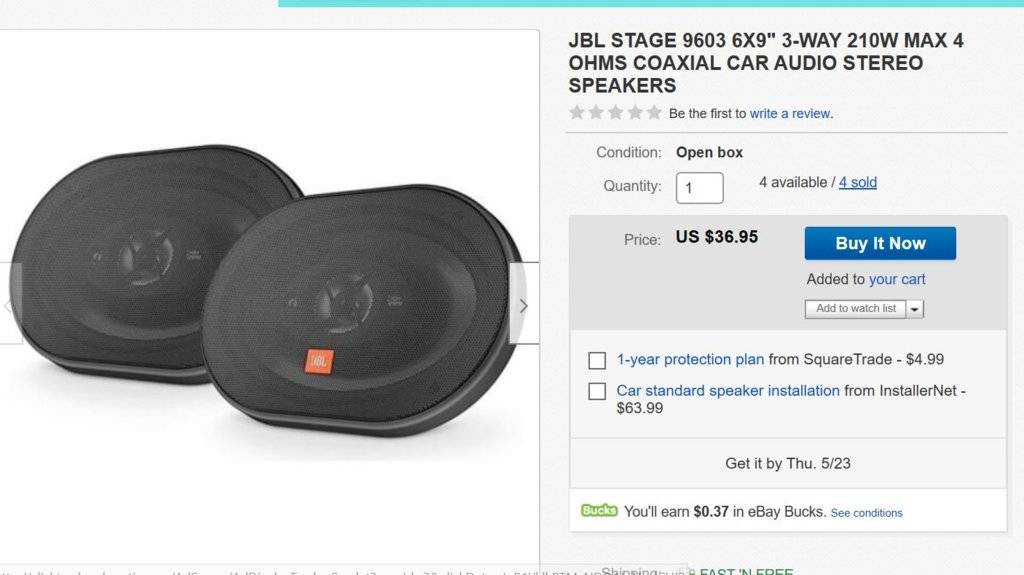

    Alright...went with Custom AutoSound 4x10 DVC for dash, and their 6x9 DVC for back. CarID has the speakers at 36 bucks each, plus tax, (cheapest I found anywhere), and free shipping. Got the Pyle amp for 55 bucks/shipped. It's only a 4x100watt channel unit, so can't drive a subwoofer. My understanding is that these speakers take 2 channels each from the amp, so cant do any bridging to a sub. Better than nothing, and speakers are now in factory locations, (no cutting), and amp will be under rear seat.
    So 135 for hard parts, wiring 25-30 bucks. Not bad, and should have some decent sounds now.
