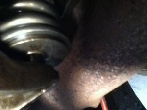

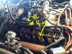

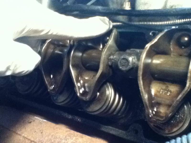

Found a collapsed lifter on the pass side....which explains the slight tapping sound I can hear. I can push one of the rocker arms on cyl #4 up and down ever so slightly. I'm gonna remove it and replace it and the rest with a fresh set for standard Chrysler "b" engine.....can I get away with keeping the same cam? Its barely a year old...it would suck if I have to replace it...really don't want to get into pulling the a/c components and everything else to get to the cam if it can be avoided. I don't expect to find bent push rods or anything either, the motor runs pretty good aside from the sticking lifter.

I grabbed a few pair from the hospital,:wtg:...figured they would come in handy,lol.So it's relatively simple then, pull out the existing lifters, lube up the new ones, set the preload and drop em' in place...excluding any problems like bent rods or egg shaped rockers arm holes?
Yes, just swap the lifters, unless you've been doing some serious RPMs with that 383 and you think the cam needs replacing. If it's only been ticking for a short time, then there should be no ill effects to the cam. O doubt you'll have a bent push rod or badly worn lifter bore...in my experience these engines are pretty well bullet proof in stock iterations if you keep oil in them. If you get radical in the modifications (alterered valve spring geometry and radical cam profiles) then they can have failures like anything alse (but then again you're flogging the engine and probably racing if you do those mods).
Since you engine looks pretty stock to me, I think you'll have no problems. I had a 78 NYB that developed a lifter tick and I did the lifter transplant and it ran perfectly thereafter for the remainder of the time I had the car.

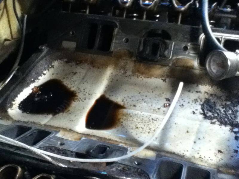

Ever see pools of oil form on top of the valley pan? Last time I had the intake off it was clean as a whistle - you could almost eat off it. This time, not so much.
How's your oil pressure sending unit...wet? Looks like its starting to go.
So what made you decide to pull the intake?
Starting to go..... If it is squirting oil that high up and under the intake.. It's already gone. :drowning:
