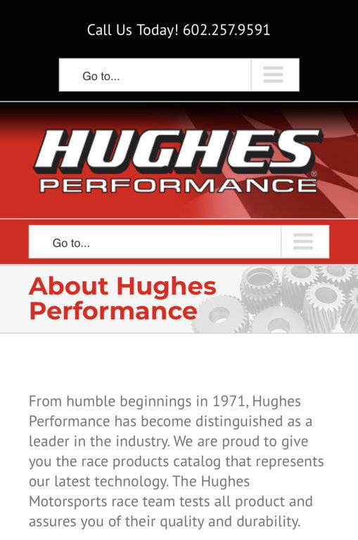

The best place you can possibly go to for all things torque converter is Hughes in Phoenix. FCA might have them but can the guy that answers the phone really help and advise you?
318 to 340 or 360, all things big block & full race, internal vs external balance whatever combo you can come up with these guys know it all. They also specialize in conversion flex plates so you can mix and match just about anything. Give them a try, these guys have never failed me. Satisfied customer since 1984. Good luck bud.
hughesperformance.com
