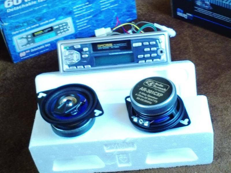

I can't tell you what's in the dash of a '66, but the in-dash speaker in my '71 appears to be a 4"x10". I was considering cutting a piece of sheet metal, plexiglass or even "Masonite" to fit the opening and then mounting a pair of 3.5" Co-Axials that I own in that 4"x10" opening.
Just an idea that I thought I'd share. :)
The '71 also has two openings in the rear shelf. The openings appear to be for 6"x9" speakers. My car never had speakers installed there though.

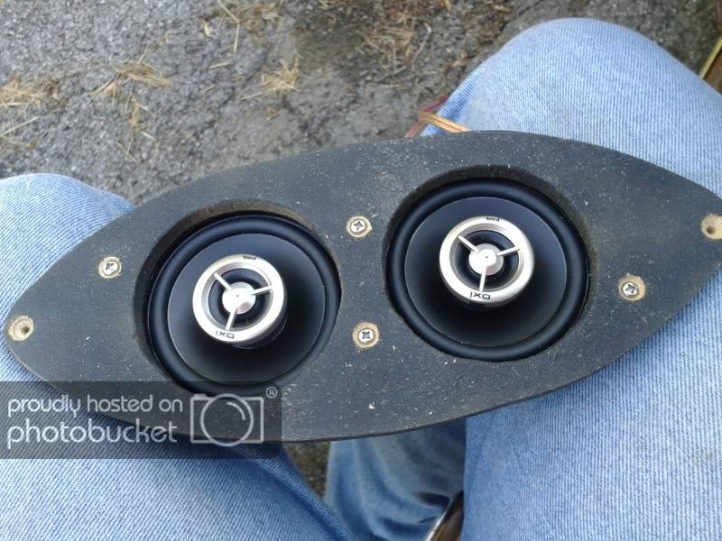

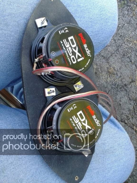

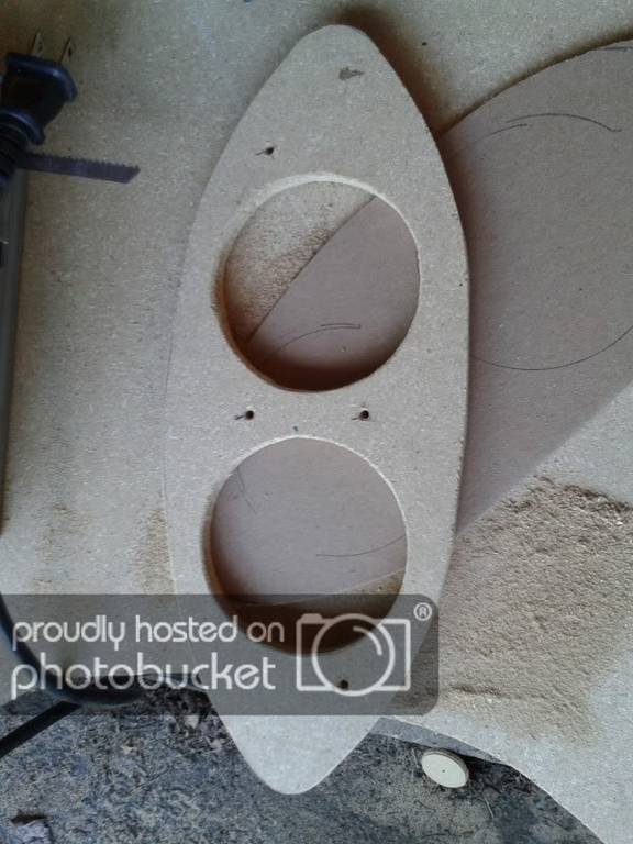

Here's what I did. I made this from a MDF crate I found on the shipping dock. I had some cheap Polk Audio speakers that I used.
Yup, that's it. Thanks Big John! That looks very nice, by the way.
I haven't gotten around to installing tunes yet. Are you using these speakers by themselves or do you have other speakers in your car too?
