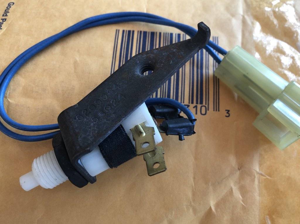

Was hoping someone could help me identify this switch. I was told it's for a '68 w/cruise. However, I can't find pictures online to verify. The number on the bracket is 5209964. That number isn't in my parts book. I checked Marty's site, and he doesn't show that number but the sequence appears to be for later model cars. Not even sure the number on the bracket is the part number. Any help would be appreciated.
1980-84 L-body or van.
I had a 68 NYer with cruise and that is not the switch.
1968 had a one year only cruise st up and it had its own separate cancel switch not related to the brake light switch.

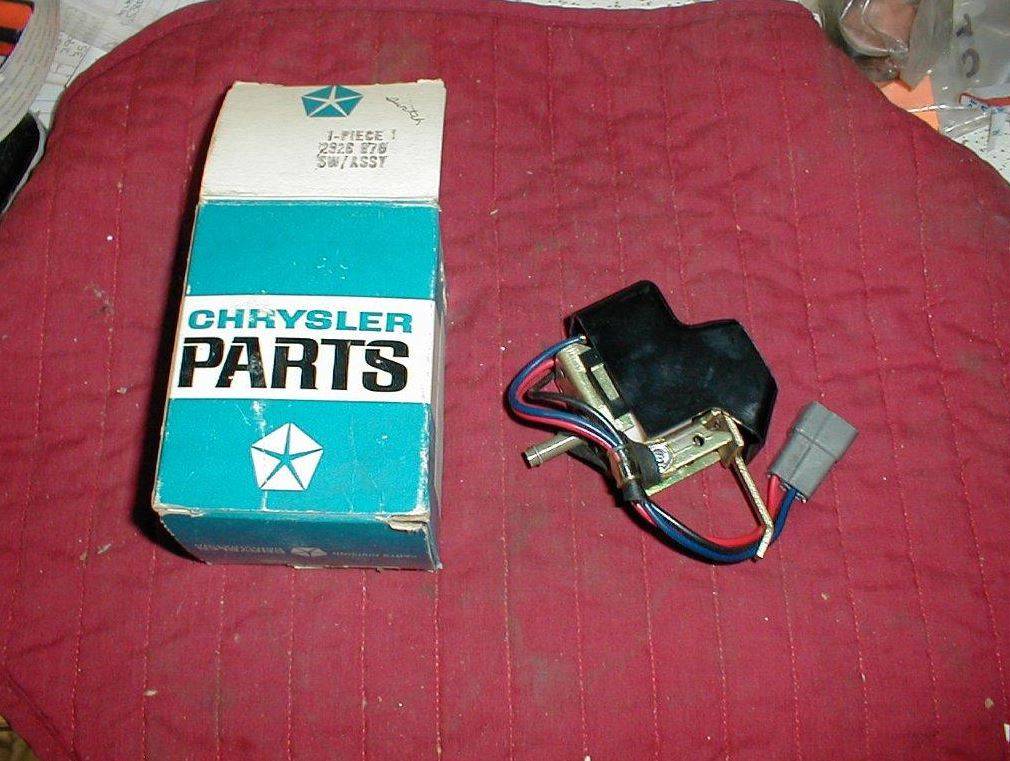

Here's what you're looking for, specific to '68 & '69 w/ cruise. Part number 2926676. Note the vacuum fitting. There's a separate bracket to mount it to the column, you'll never get it mounted without that bracket, I tried...:BangHead: before I knew the bracket existed.

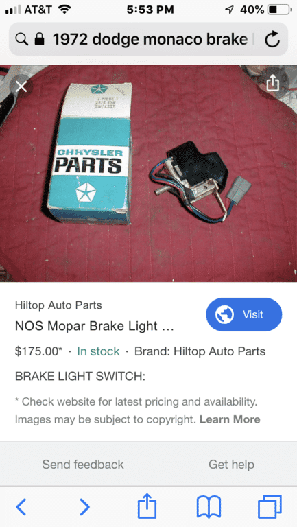

I recall buying one of those for a 72 Monaco wagon I owned or similar and they were quite pricey. Be prepared.
I think I bought mine from NAPA and it was still close to $200
