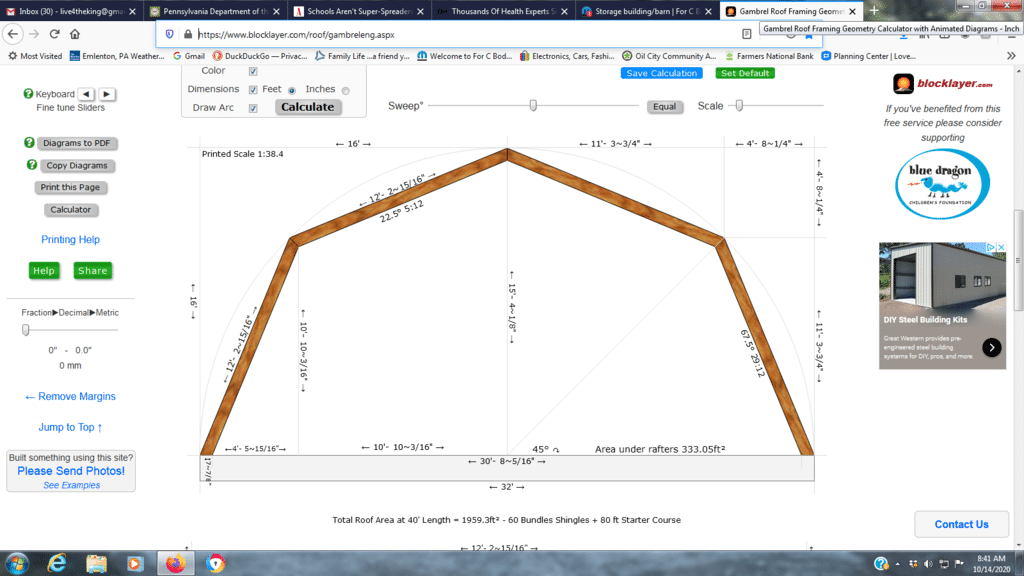

I hope to build a garage/barn in the future. I say barn because I'd like to pattern it after a Dutch barn. I want to pattern after one so that I'll have overheard storage. I built my 10x16 shed this way and I've got tires, a fender, trunk lid, lumber... stored up there. This is just a picture of a shed just encase you're not sure what I'm talking about.
If I did this with a garage that was 32x40 I'd probably end up with a space overhead that would be almost 22x40 that you'd be able to walk around in, with lots of head room. Gambrel Roof Calculator. This is a fun tool to play with.
Before I was married I wanted to build like this, but I was going to live upstairs and have the downstairs to play in. I think the upstairs now would be for a wood working shop.
As others mentioned I would most likely use Amish or Mennonite builders. I may even use rough cut from one of their mills to help save on the cost.
My home is a Dutch Colonial so it has a barn elevation. When I was planning my garage I strongly considered the plan you mention.
I chose the 12' ceilings with a 4/12 roof pitch because I didn’t want the garage to eclipse the house. I do have attic storage but its minimal. If the house was positioned differently I probably would have done it similarly to your plan .
Point is there are plenty of things to consider when planning these things out, many unforseen. A forum like this can pose a lot of questions for Nick to consider when planning.

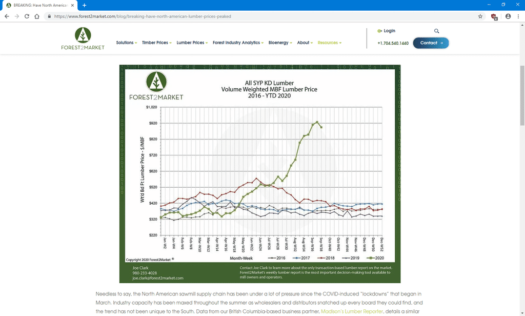

Lumber prices reached an all time unsustainable high price last month. Prices are coming down and hopefully by the time you are ready to build they will be back to normal. An $8 sheet of OSB at the beginning of the year is now about $20. Like others have said, build bigger than what you think you need. If you don't the day will come when you wish you did. I added another 14'×84' to my original plans and am glad I have it now.
Last weekend 4 x 8 OSB was $23.98 at the local Lowes. 12- 18 months ago it was $7.49. :realcrazy:
They are having trouble obtaining treated dimensional lumber. Kid there said they get one truck in every 8-10 weeks and its mostly gone within a few days.
It's the same story here. I've heard lumber prices are up around 200% since April and one of the local building materials businesses can only get a (1) truck in every other week. I rode by a few days ago and their visible storage was empty.
Of course I chose to push off rebuilding my shed last year hoping to do it this Fall. :BangHead: What's another 6 months....
