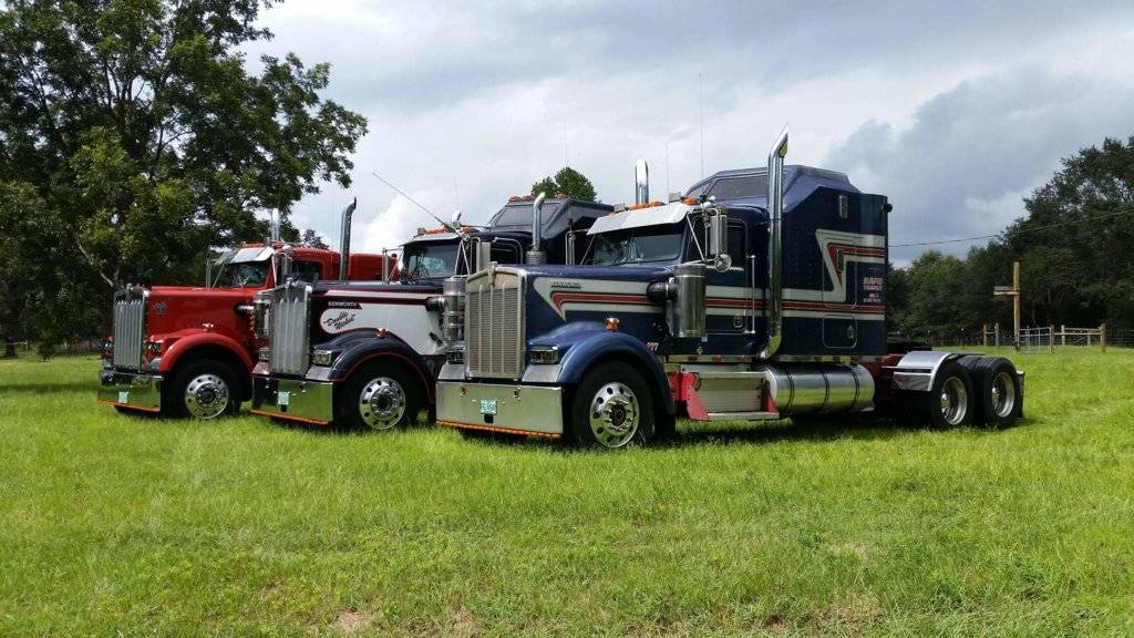

Your welcome. I polish the stainless on my semis (air cleaners, sunvisors, grill, etc. with sandpaper, lol. Mind you I start with 800 grit and finish with 5000. Its like looking in a mirror.
It must look awesome I barely had the guts to use the buffing wheel but I tell you the parts that I had to sand out some dents I went up to 2500 grit and it polished out well.. Your trucks must look awesome
1984, '97, and a '96
Thank you for the pictures they sure are beautiful and all the work you have done is obvious and well worth it.
