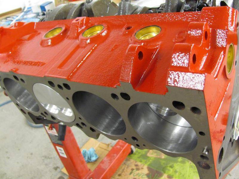

I finally got time to get after one of my projects with clear light at the end of the tunnel after finishing my port work on the heads and manifolds, however when I put the short block together I found out that the machine shop ruined my block by decking it too far... way too far, and tapered even deeper to the rear... Yay ... :BangHead:
You can see the piston is above the deck when they belong .018" down @ TDC....
Nice... Better luck next year I guess... :gah:
I sure hope they compensated you for their disastrous mistake!
They obviously never quite grasped the term "zero decking".
It would have been salvagable without the taper.
They owe you something towards a new block.

Wow, that's terrible. Where you been?
That machine shop should of been too embarrassed to give that block back to you!

It is really frustrating as he is not a bad guy and he is a good friend of one of my co-workers, and he didn't know that he screwed up until I put the short block together. He showed up at 11:30 at night on a weekday and offered to get me a new block and redo the machine work, but after asking several questions I don't think he has the proper equipment or training to properly deck a block. My co-worker was very worried about me being pissed off, but truly I wasn't angry, just sick. The engine is for my boat and it will not see the water again this year and I have about 6K in the engine as it is, plus now the added expence of having to replace the roller cam block ('89-'91 only) cleaning, boring and decking it, along with new cam bearings, frost plugs etc.... Not to mention any machine shop with a solid reputation for doing precision work is at least 3 months behind... :sad11:

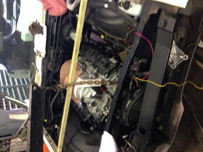

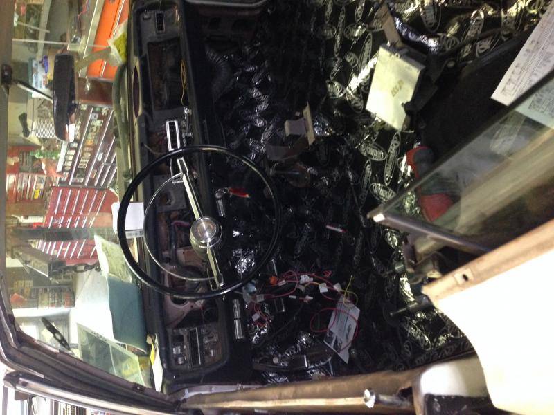

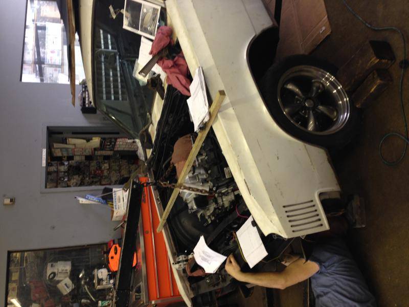

Like a glove.....
Can you believe that Miloden actually makes a middle sump oil pan just so you can jam a modern Hemi in a C body? Well, they do.....
