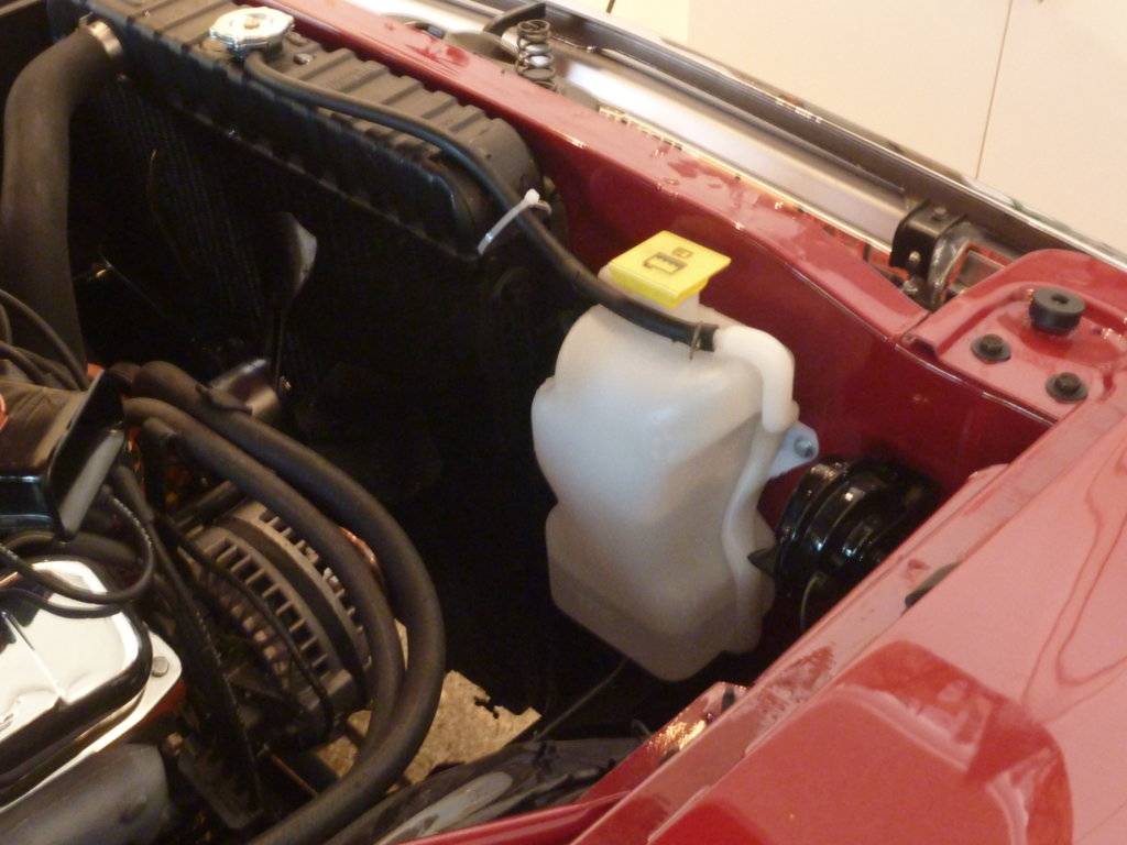

  11. Fury440
    Fury440 At my age everything's a good idea
    Messages:
    2,640
    Likes Received:
    2046
    Joined:
    Jan 15, 2011
    Location:
    Calgary, Alberta
    I had the same after boil problem. I added an overflow bottle like this.

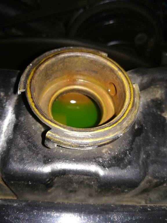

    I have just been to the Garage to check the fluid level today (I refilled yesterday)
    I really appreciate your hints.. I'll start to work the hints you gave me. The previous owner just used an orange juice plastic bottle to collect the overflow. The underhood picture from @Fury440 looks pretty nice. I'll check on RockAuto for that.
    And here is a pic of the fluid level where you can see a bit of the rad. Since this is my first car with 50+ I am not sure if the rad looks 100% ok in comparison to it's age.. the inside colour looks rusty

    You will need to convert to a closed system rad cap if you go this route

  19. stubs300
    stubs300 Senior Member
    Messages:
    3,149
    Likes Received:
    1285
    Joined:
    Oct 30, 2011
    Location:
    Free America
    On a cold motor, all your junk is going to be sitting in the bottom of the tanks and block. Your coolant looks fair, who knows what it looks like hot & stirred up, but like I said. You don't know the condition let alone the freeze point of it. Just do it before it get to cold and the snow fly's that could make your matters worse if that stuff freezes. You can thank us later. Good Luck
