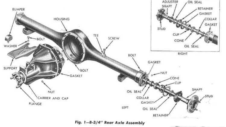

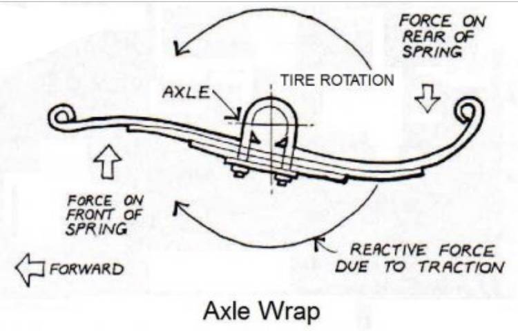

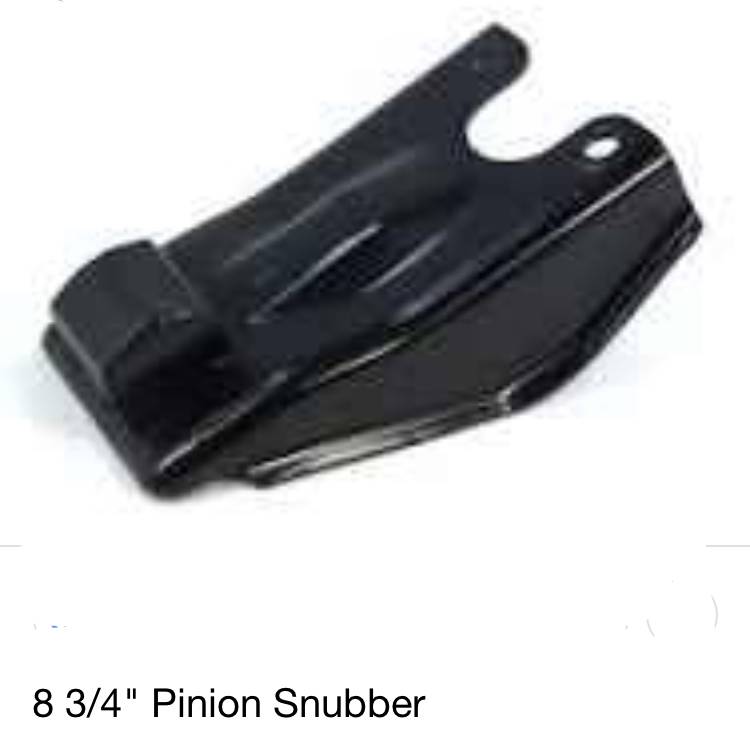

    I’m assuming you have a 8 3/4 rear end with a factory pinion snubber mounted on the top of your pumpkin .when you punch your car hard from a stop the snubber turns upward with the rear end and hits your floor boards and stops your rear end from turning upwards from torque . I know this noise because my car does it when I hammer it hard from a stand still . I attached a few pictures to help explain what I’m talking about . To to truly diagnose the issue , you would have to record the noise in a video or something and post it. This noise is more of a thumping noise on the floor boards coming from the back end of the car only when you punch it from a stop. You can look under the car for a shiny or worn spot on the floor boards where the rubber bumper of the snubber was hitting it just above the rear end . If you find that spot of contact , that’s probably your noise. Good luck E2288E9A-1DBF-4FB3-83CC-EFC746CFF8C0.jpeg 30A23924-A986-46DE-A355-C825C8DED5C7.jpeg 9400F5A2-1269-4507-A3F7-75AFCD40810F.jpeg
