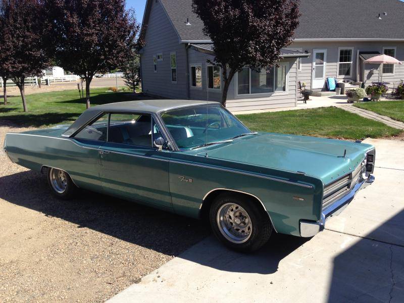

Ok this morning my battery was too low to start my 67 Fury III so I put he charger on the battery for 45 minutes? It started and was charging ok. Run some errands and at the last place I stopped i went to leave after the car set for30 minutes and there was no current not a thing , like the whole electric system was disconnected. I got a jumper and put on but could not start with key, I had to cross the solenoid terminals to activate the starter . It then started. Hot home turned of engine an restarted and it was fine checked battery, it was fine. Does the 67 Plymouth have a fuseable link or auto circuit breaker ? Why did I loose all the electrical power , even the clocked quit ? Would appreciate some advise. I did not intend to write book sorry.
