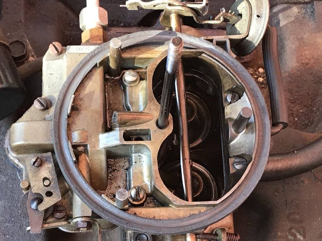

Hi there, me again ...
My ‘67 Monaco looks to have its original Bendix Stromberg 3-276 WWC and I was wondering if any of you had any home tuneup, adjustment advice for best performance, mpg, mixture, idle, kickdown operation, & Cold-start.

Is it doing anything particularly bad? I ask because (to my knowledge) those carbs don't offer or require a lot with regards to tuning. If it's original it may just be time for a rebuild.
So, is your wagon a 67 with a 68 front end or?
Hi, nothing too bad other than I have a suspicion the mixture isn’t quite right or something. Exhaust fumes smell pretty strong but not at all visible, chrome slotted exhaust tips blacken up after a run. She starts fine when hot but takes about 16 pumps of the gas pedal when cold & stays running after about four tries. Seems a bit uneven at higher speeds & pops a bit on deceleration.
Regarding the front end I think it may be a ‘68 Polara grille someone fitted in the past (with fencing wire!) but I kinda like the look of it even if it’s not original.
I’ve owned a 67 and a 68... love em both!
With regards to the carb, I’ve basically just rebuilt them when I got cars as a rule especially if they sat for an extended period. There’s a lot of stuff to gum up in there and based on how long it sat and even the pictures of the body, I’d say that could be a rather large part of your issues.
In general, not a lot to go wrong with those carbs. Set the idle mixture, starting at 1.5 turns outward on the idle mixture screws, with a hot idle rpm of about 600rpm or so, as I recall.
Make sure the base plate nuts are snugged-down nicely.
As far as the cold starting issues, when the engine is cold, make sure the automatic choke flap closes fully, then is pulled open a bit as the engine starts by the choke pull-off diaphragm. With the engine cold and everything at an ambient air temp of 70 degrees F, the choke flap should just close, easily and gently, if it's got more "pressure" than that, then the choke thermostat in the intake manifold probably needs to be backed-off a notch or two. With age, those thermostatic springe tighten-up, so if you set it to factory specs, or it is still at factory specs, it'll not let the choke open soon enough to not over-choke the engine.
Back when the cars were newer and we still had leaded fuels, it was common to see the light gray coloring at the end of the exhaust pipes. Which indicated a normal carb mixture situation. BUT when the lead left, the pipes would color "black" and fluffy, typically. As my '77 Camaro did when it was new. So, what you might perceive is a too-rich mixture, from the rear pipe coloring, might be completely normal for unleaded gasoline (ethanol'd or not).
A better check might be to look at the spark plugs instead.
But do ensure that the hot base idle timing is correct for the car. That the idle mixture is set to specs. That the spark plugs are gapped correctly and reasonably clean, as to accumulation or deposits on the insulator and ground electrode.
Also look for vacuum leaks, including the vacuum advance can.
You can set the accel pump arm in the long slot for a bit longer accel pump shot, but generally, the center slot will work just as well, from my own experiences in seeking a bit more performance on out '66 Newport 383 2bbl when it was new (and I was in high school).
Do the carb "kit" AFTER you've done everything else to make sure things are adjusted right and such. By observation, unless the innards are really gunked-up, the carb "kit" deal gave us more peace-of-mind that all was well, with little improvement in performance, if any at all, back then.
It will not hurt to spray the carb with a good carb cleaner, in the venture area and on the outside. When we'd get the '66 Newport tuned-up at the local Chrysler dealer, back then, the tech would get a can of solvent and splash it around onto and into the carb. "Solvize" is what they termed it. This would easily wash the accumulated varnish and such off of the carb venturis and clean up the choke flap to make sure it was free to move.
DO also make sure those well plugs in the bottom are tight and do not leak. They plug passages which go to the float bowl, so when they leak, it can get "firey" under there. On some, which use a staked-in ball bearing surrounded by a sealing solder, modern ethanol'd fuels degrade the solder and the balls can fall out. Not good! Just spray everything down to get it clean and watch that area, for good measure.
Just some thoughts,

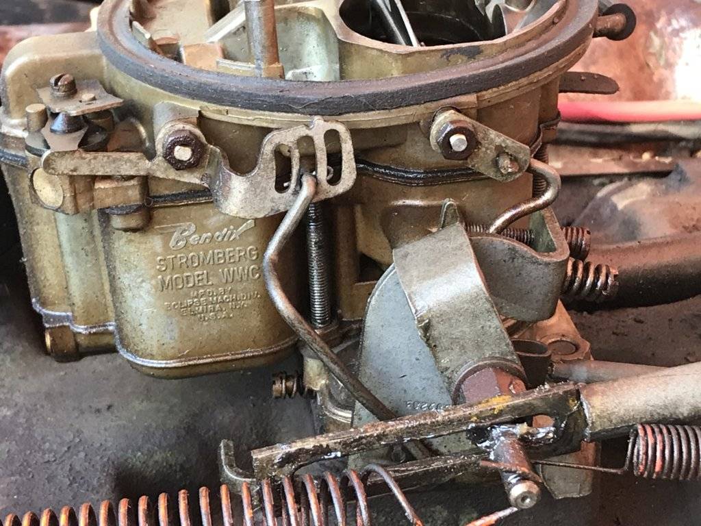

Thanks very much for this - I’ll do these things. Meanwhile, not sure about where the horizontal push slide slotted rod in the foreground should be adjusted to & what it actually does.
Also, where the rod that pushes up through one of the three vertical slots (what do they even do?) in that plate should be set by bending... confused & feeling stoooopid!

That is your throttle linkage. It basically tells your engine when and how hard to shift. It also triggers downshift at wide open throttle. You REALLY don't want to mess with that without a factory service manual.... it'll show you how to set it and basically everything else you'd need to do to that thing .... in fact, you REALLY need to get a factory service manual. There's a PDF version for free here:

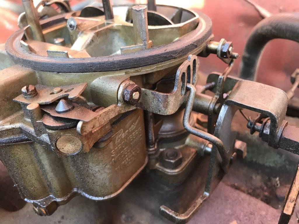

Any pointers would be much appreciated. The setting for the lever that has connects to the three slotted lever that opens that bowl thing at full throttle also is causing confusion - if you know what I mean?
