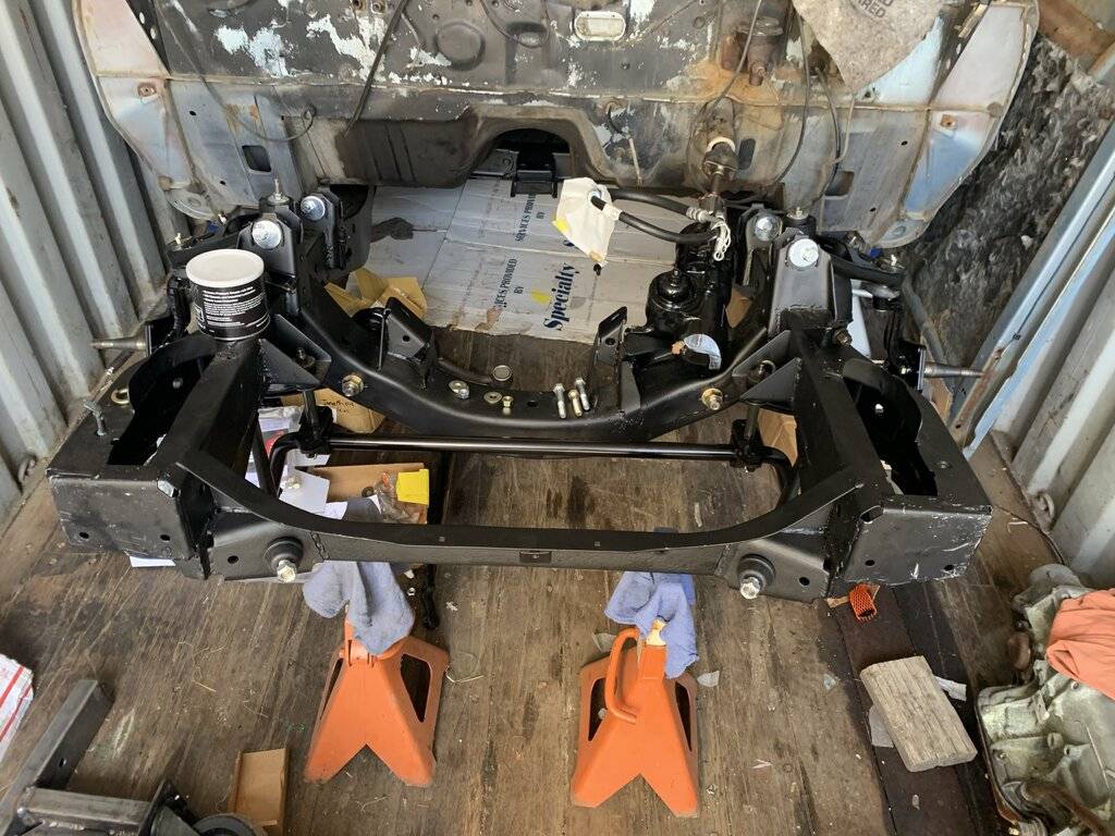

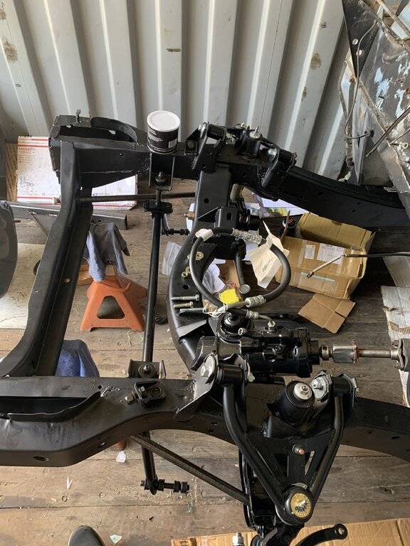

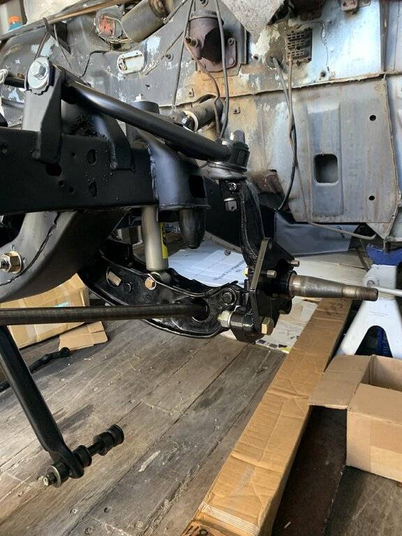

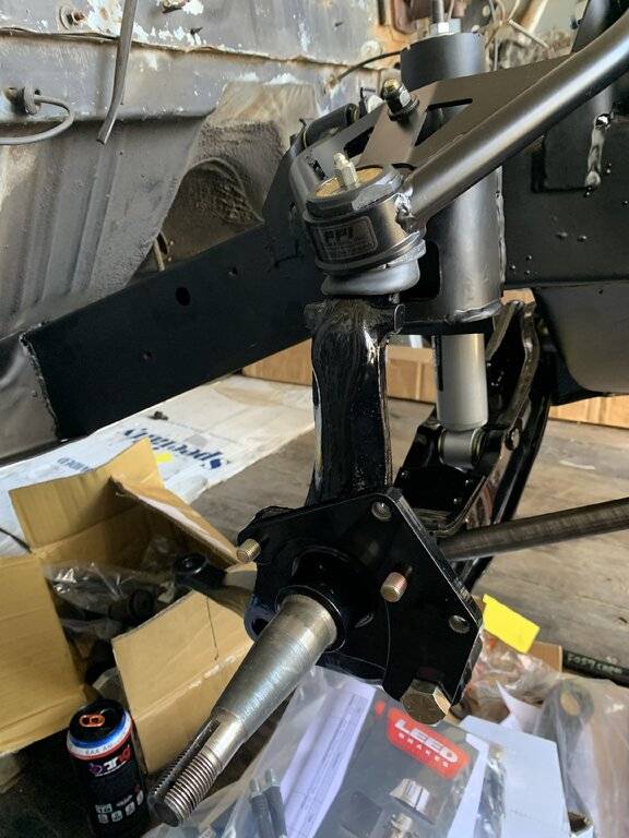

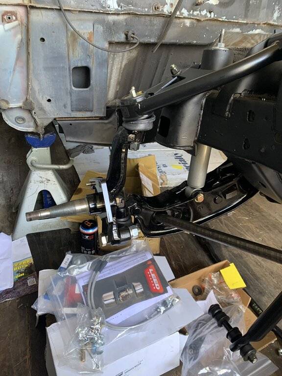

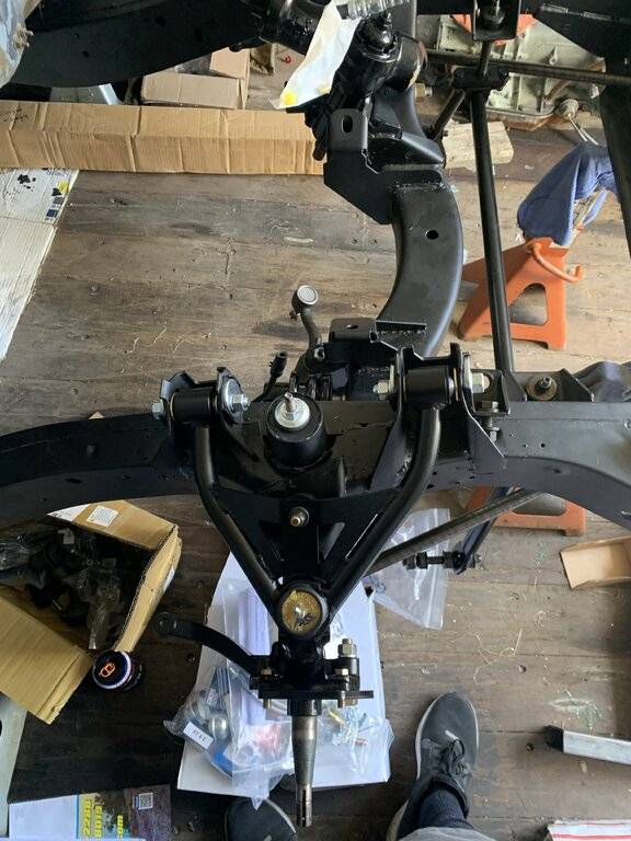

Hey guys putting my stub together years later after sitting. I put my struts in realizing I’m missing strut bushing shell/washer. Can’t seem to find a kit, my old ones are shot, question is will b/c/e body bushing kit work? Thanks . Also here’s some pics as well.
Just an observation, you caliper brackets need to be towards the rear of the spindle, not the front.
Maybe so, but this is a Chrysler product and the calipers go to the rear. This way you won't mess up your brake hoses.
Thanks for responses, not knowing suspension kit to come with out strut shell and washer trying to find a source that still has them. When I put brackets on I thought similar but Leed has it this way in conversion kit.

traintech55 is right about the brake lines for stock. My SSBC kit used KH calipers, also, and they are forward, too. But, the braided lines that came with them were long/flexible enough. My nit is that the angle of the inlet is back toward the spindle arm. I'm almost tempted to use a banjo.
Did you use or do you have any spacers between the caliper mounting and the spindle? 'Just asking. I imagine you don't know, yet(?) if you will need spacers on the caliper to mounting bracket?
I have the same kit. It does use a spacer between the caliper and mount. It is an ordinary flat washer.
