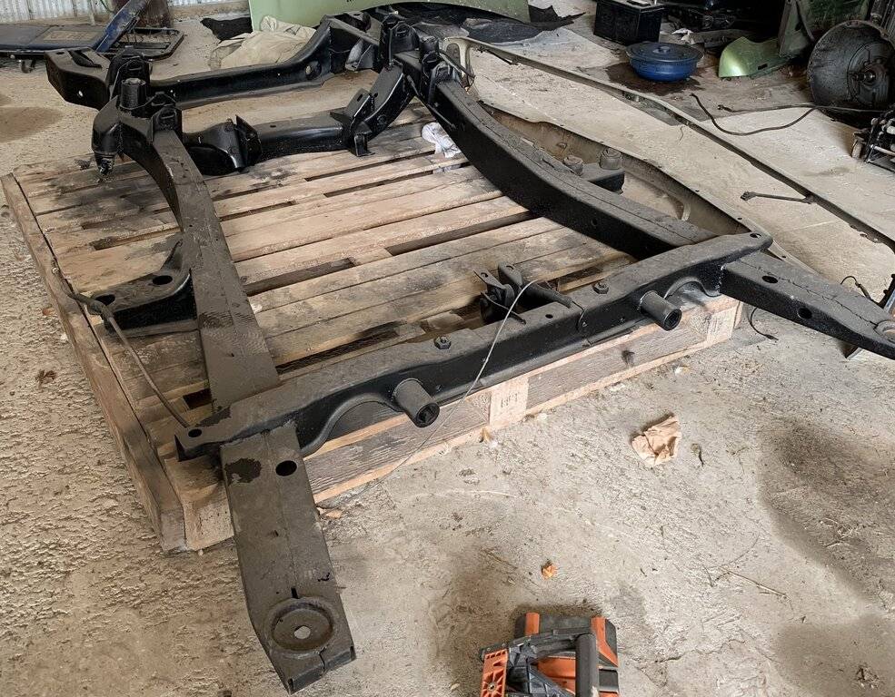

I have a stub frame ( isolated) out of a 70 Monaco for sale….perfect condition…it’s been sandblasted a couple coats of epoxy primer applies….will ship $350

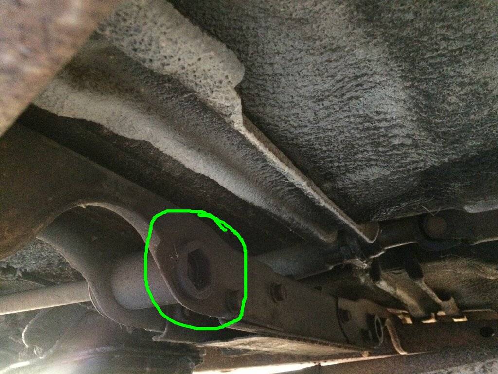

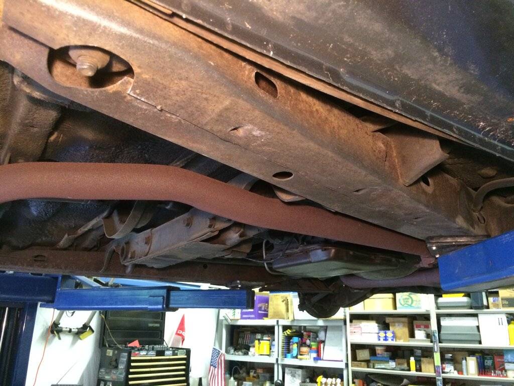

Actually, it's super simple:
The bars extend past the crossmember on the Chrysler and Dodge.
The bars are flush with the crossmember on Plymouths.
The torsion bar sockets are the only difference between the frames.
