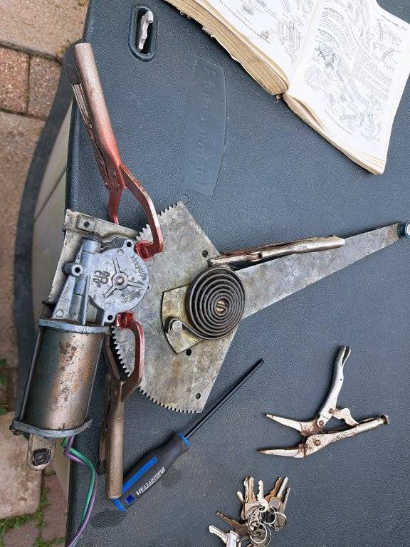

Passengers window is stuck 2/3's down.
My first plan is to remove the zip tie around the green and purple wires that go to the motor. I am hoping to hook a 12V battery up to the motor to try to get it to go to the up position. Will this work?
If not, what would be my first steps to getting the window back to the rolled up position?
Do I remove the entire motor? Just the cover over the gear for the window?
Pretty tight in there.

I personally prefer removing the regulator and motor out from the door as 1 piece.
The regulator is under a LOT of tension from the spring.
So I clamp it down and replace the motor.
I get to keep all 8 fingers and 2 thumbs.
1" cut off wheels and a Dremel tool work to make the access holes as well.
While I do agree that the springs should be treated with caution, my experience is that with the regulator and the glass in place in the car, things don't move much. The spring wants to push up, gravity wants to pull the glass down, and the general friction of the mechanism tends to dampen any movement.
Out of the car is a different story, before removing the motor from the regulator, clamp it as many ways as you can see and then look for some more. That will go off like a bear trap.

Apparently window regulators are sided. The spare that was in the trunk was for the drivers side and would not fit up to the passengers side.
I did remove the bad regulator and get the window to at least be up keeping the weather out.
I will add more pictures when I find a regulator and put this back together.

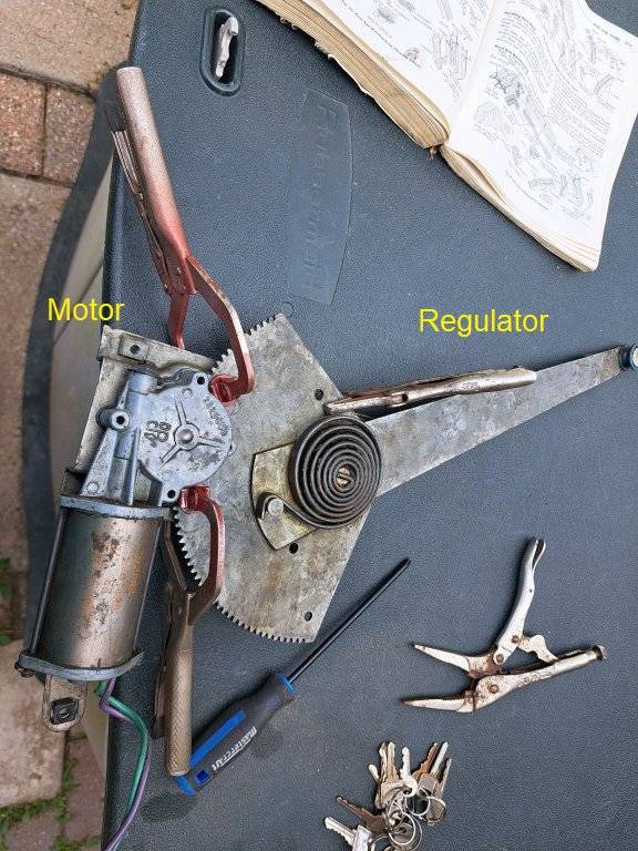

Did you test the one in the trunk? The drivers side motor usually goes first, as it is used the most. The motor for the passenger window will be the one with the even number. Odd number for drivers side. Let me know if your passenger window motor is toast, I have a bunch, and can help you out. Cam Shaft.

Do you need a regulator, or do you need a motor?
The regulator being the mechanism that the motor attaches to.
Thank you Big John, I need the motor. Not the regulator.
Regulator is in good shape with no missing teeth.
