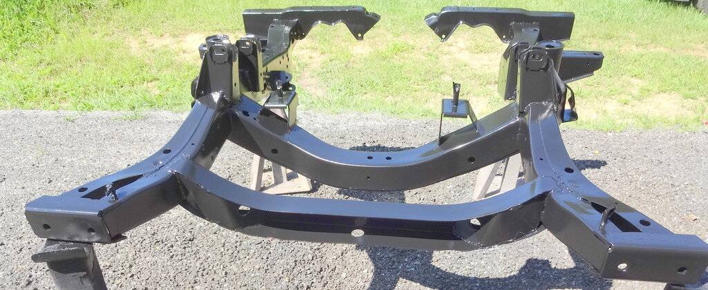

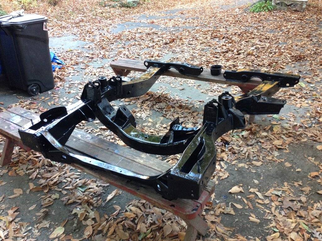

First power wash the crap out of it, literally. There are areas that have collected dirt that you can’t see until you run high pressure water through it. Let it dry on end then wire wheel, grind and clean the surface best you can. I used a coat of POR-15 (or use the chassis coating of your choice) and then before it dried to the touch (about an hour) I sprayed semi-gloss rattle can black. Use rags tied to the end of a rod to get as much POR on the inside as you can. The resulting finish for me was super tough and still looks great after many years. As for bushings, there are no re-pros, but some have been very creative in making replacements, keep searching for ideas.
Before:
After:

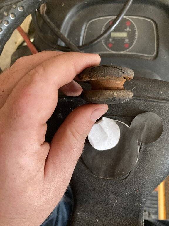

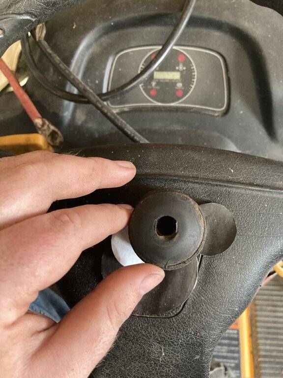

I checked my stash of NOS Moog parts I bought (almost everything I need and including an extra set of ball joints which are reserved for Wyatt). I did find new shock tower bushings, but the ones for the sway bar hinge weren’t provided in K7061. Here are what they look like when I got them out.

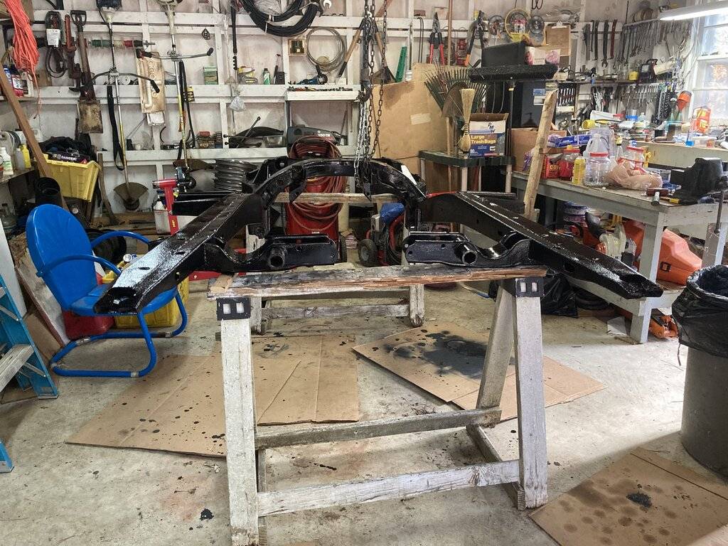

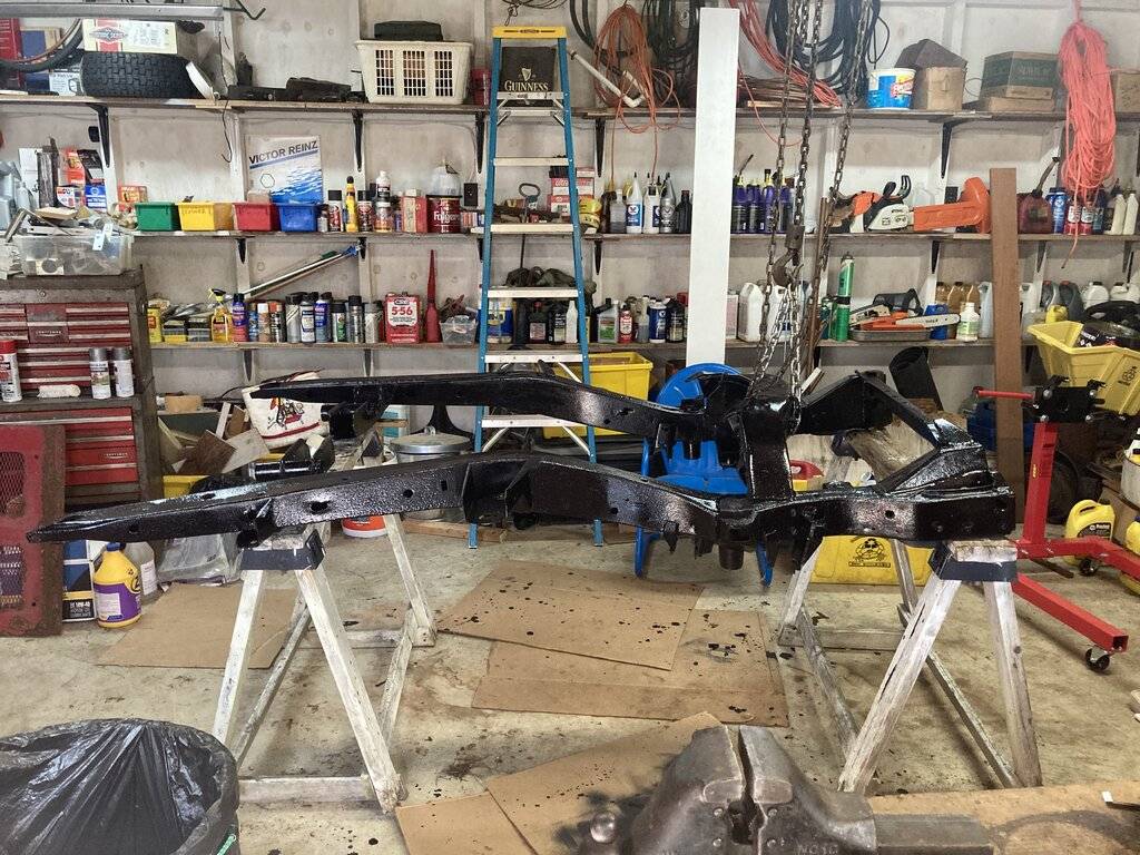

After two coats, this was my end result. It looks infinitely better than it did, but I did lay it on too thick so it’s more glossy than I had hoped. But I’m happy it stuck, and surprisingly got minimal paint on me (yes I wore gloves).
