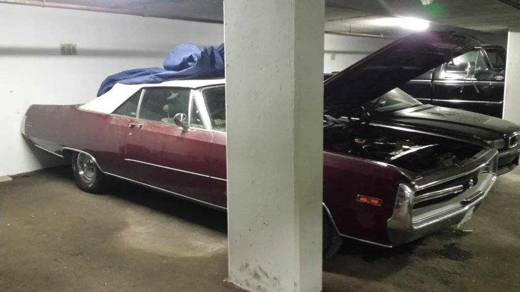

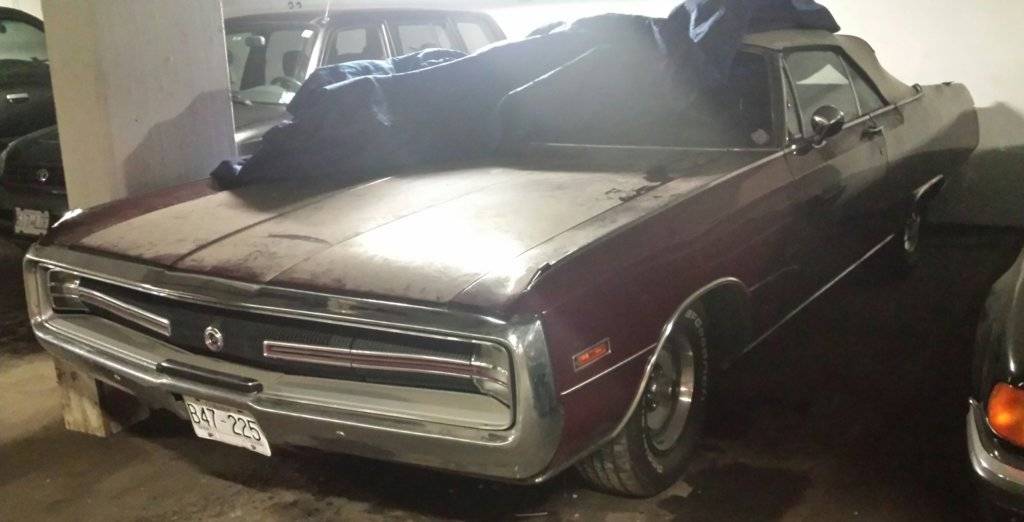

Post a pic of the car, Mark!
I had a car matching that description and it sold to a guy in Canada. (or, is your car green?)

the car is a 70 300 TNT convertible.
ive known it since 1996
i will post more about the car very soon in the fuselarge section.....
