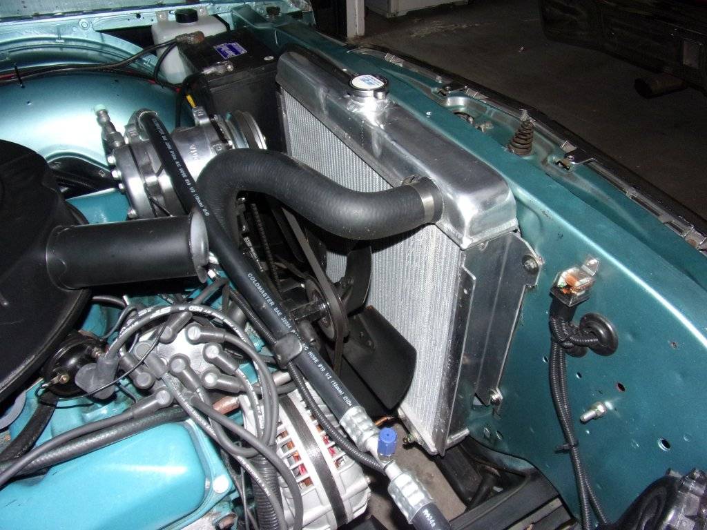

Cbarge recommended this company, so I bought a 22" unit for my 65 Town Sedan. Works great. I paid less than $400 US for the unit. Interesting story as well. ECP | No Gimmick Cooling

Champion radiators. All aluminum and doesn't look factory. Buy, they are less than $250. I've had 1 in my Monaco for almost 7 years with absolutely zero cooling issues.
