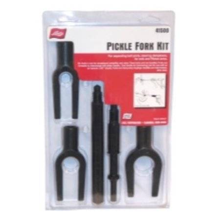

If you have to work on your front end again in the future, what you'll need is a pickle fork kit. You can tear the entire steering system apart with one of these. I have this exact kit, and for 20 years, I have been using it for precisely that purpose.
I had to unbolt the idler in the end! The long pickle fork i have that usually does well just didn't. Cut it on this occasion! .....it is a particularly stuck joint on the centre link and working on the garage floor i couldn't swing the lump hammer hard enough!! Future new centre link and idler will be a good idea me thinks!
