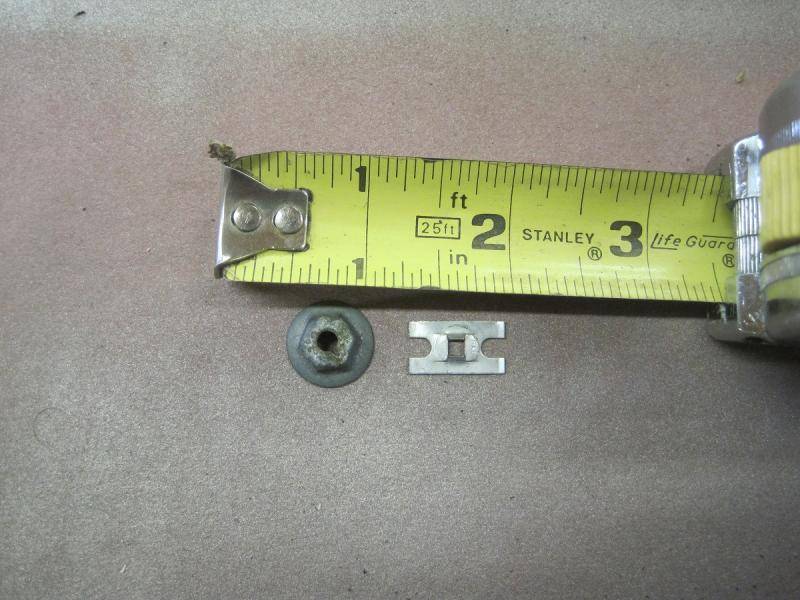

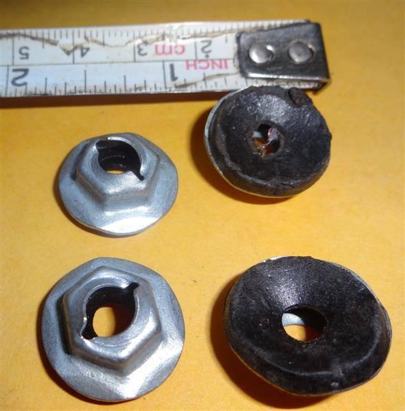

I am looking for a supplier for Pal nut with seal or rubber gasket. The flat speed nut in the picture looks like I can buy in several places. I bought some a Mopar trade show but the ones I bought are too big.
Just in case you just could take the one in the pic and stuff it with the "chewing gum" you use underneath bolted on fenders; some of these nuts came that way even from the factory.
1/4" stud size.....? I can help with that... PM with your mailing address if you can use these..... I'll send a dozen.
You are the man, but my studs aren't that big. Thanks for the offer that is what make this a great place.:eek:ccasion14:
I thought about doing something like that or cut out some chunks of rubber.

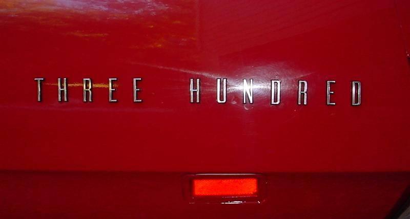

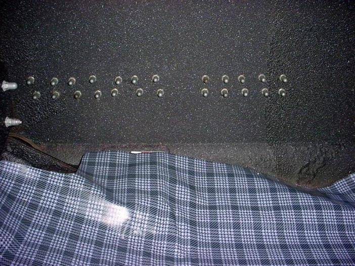

I installed the "THREE HUNDRED" letters on my 69 today. Each letter uses two PAL nuts. I placed a drop of "seal all" on each nut and turned them down just until snug. Once the seal all sets up everything will stay in place.
