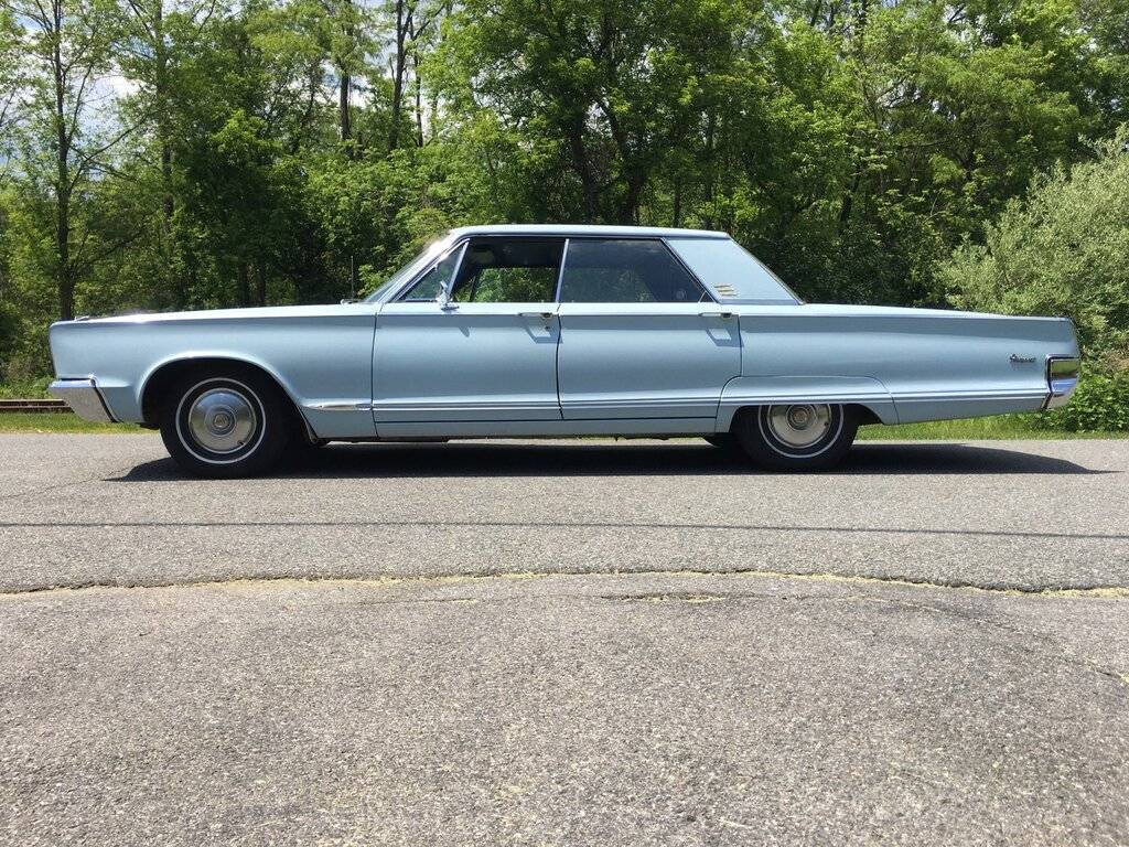

    You can raise or lower your front simply by adjusting the main nuts on your torsion bars. Forgot their actual name. You can just see that nut at the bottom of my control arm in this picture, if you expand the picture.
