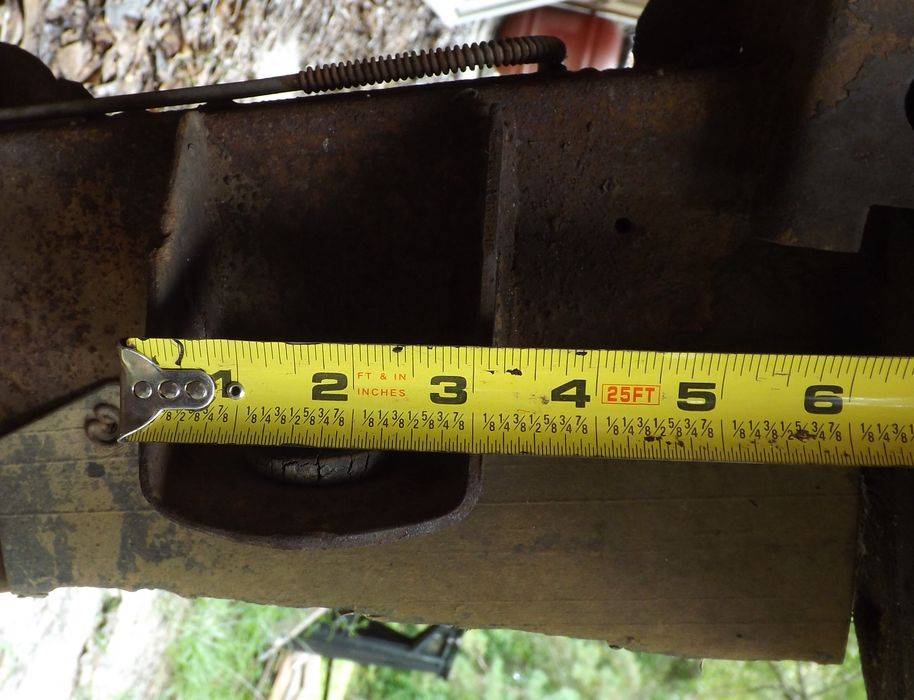

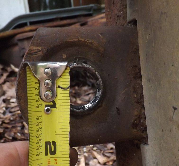

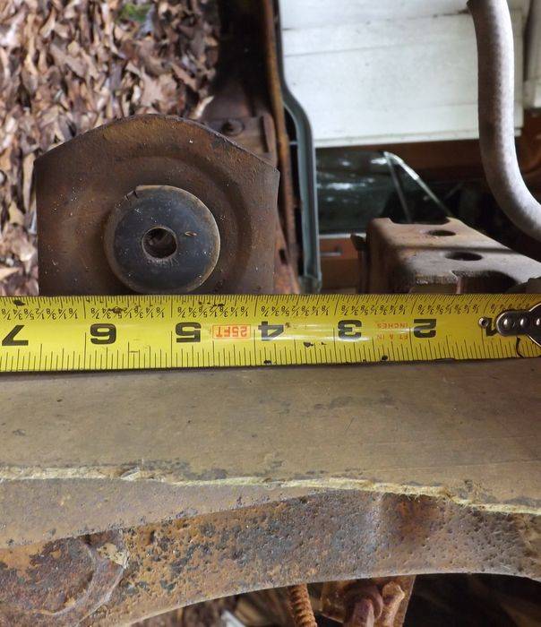

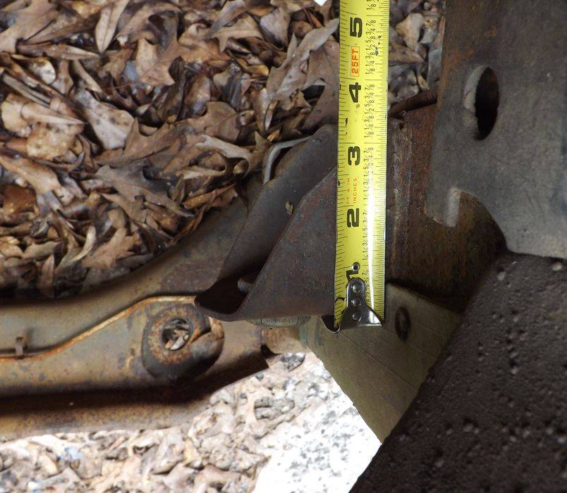

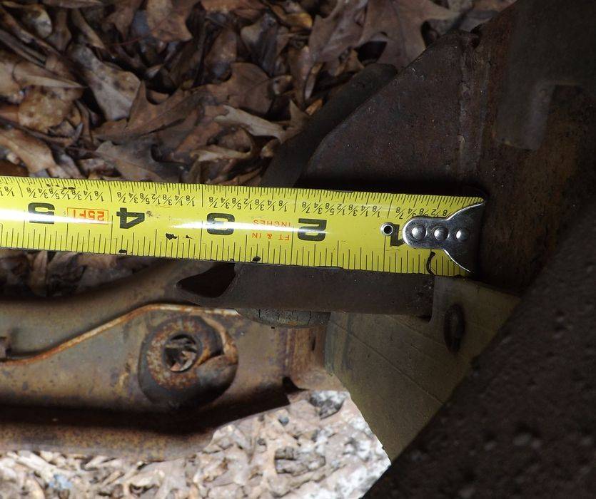

Here are the pics of the bracket, it is the same both sides. The first measurement is from the lower frame that the lower control arms bolt through to the bracket of 3.75in. (photo taken from underneath) Second photo shows the height of the bracket of 3.75in and flush with the top edge of the side chassis rail. Third photo length of bracket is 3.5in. Fourth photo, width of bracket is 3in. Hole is approx 7/8in diameter and is 1.5in in from the edge.
