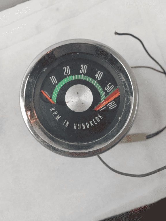

...does it require a sending unit?
Any info on the aftermarket unit pictured below would be appreciated.
Great, thanks!
So, if I were to want to test it, hook up to the coil and ground it? Can't remember... negative side I think...
Not exactly sure how those work. It appears that there's no battery power required.
Brown goes to coil negative.
Black to chassis ground.
Gray is power for the light bulb.
