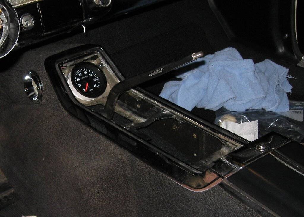

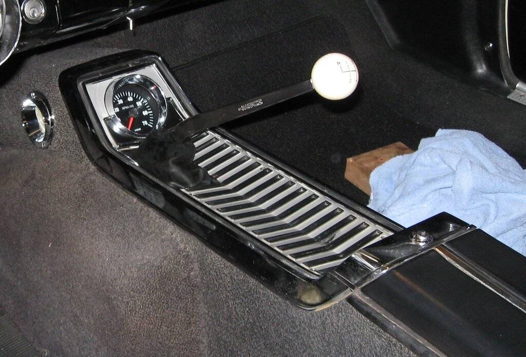

Believe your car's a '65? They used to make a repro bolt-in tach that was expensive & had a face that didn't match the original. A 3-3/8" panel mount tach can be made to work but you'll need to fab a bracket to hold it in. What you want is one that has a minimal bezel so that it can fit as flush to the factory chrome bezel as possible. I used a VDO 333155 but it appears that's obsolete.

View attachment 489420 View attachment 489421

wow that looks so clean , thank you I will look for that tach I have the same console .
