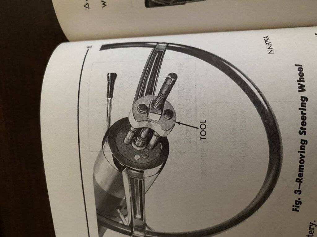

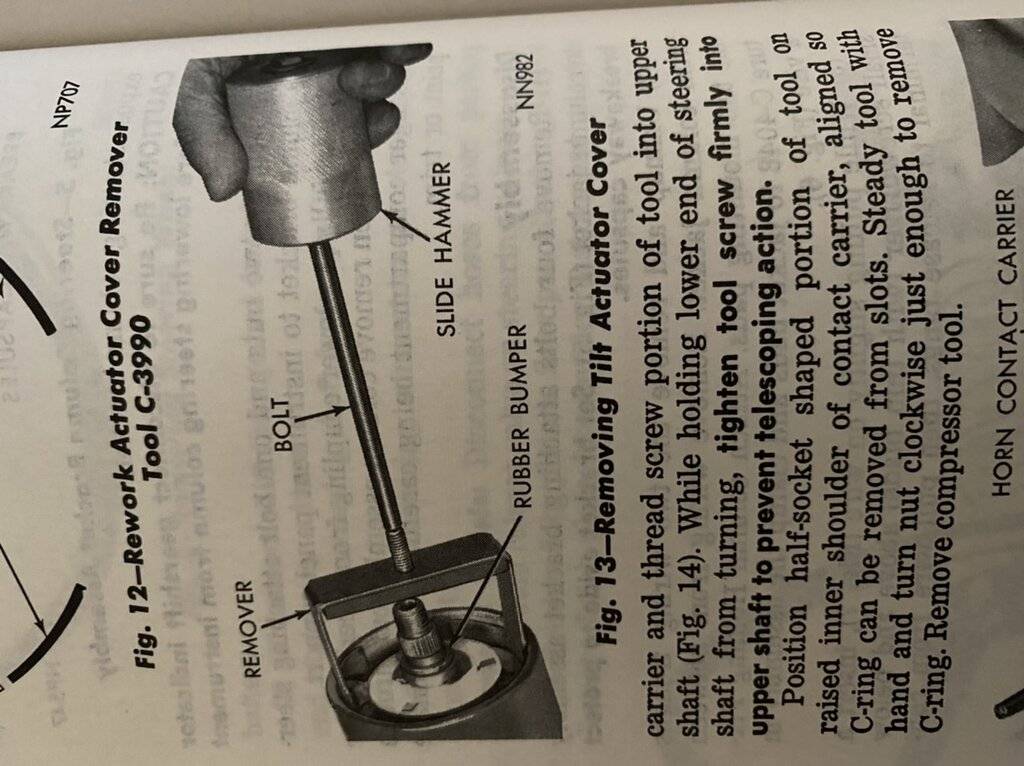

I am studying the manual. From what I can tell I’ll need a couple of pulling tools. One for the steering wheel and one for the tilt cover.
anyone have any pics of what they’ve used? Anything similar available from harbor freight??
