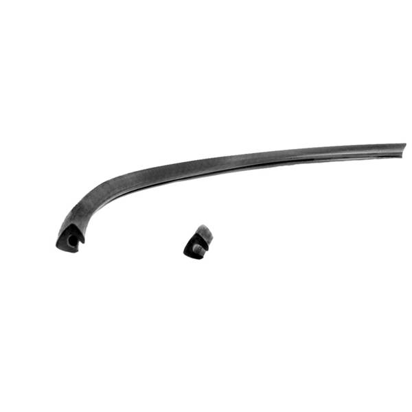

After working so tail light gaskets for several weeks and which is “almost” done, the next project is the Weather Stripping for the taillights. This is MOLDED weather stripping between the body and the tail light housing so this maybe the impossible but I”lol give it a shot. Does anybody have or know if and where this can be procured? With regard to the tail light gaskets, since I could procure, I roamed the aisles at the hardware store until I found similar material and as to the foam gaskets, you can buy a 8’ x 4’ sheet of polyurethane at Home Depot for $12 and make gaskets to who laid the tail! Again, need weather stripping. Thanks.

Metro Rubber has a lot of universal type seals like this. Metro Moulded Parts
Tail-Light Housing Seal - LP 107-A​
