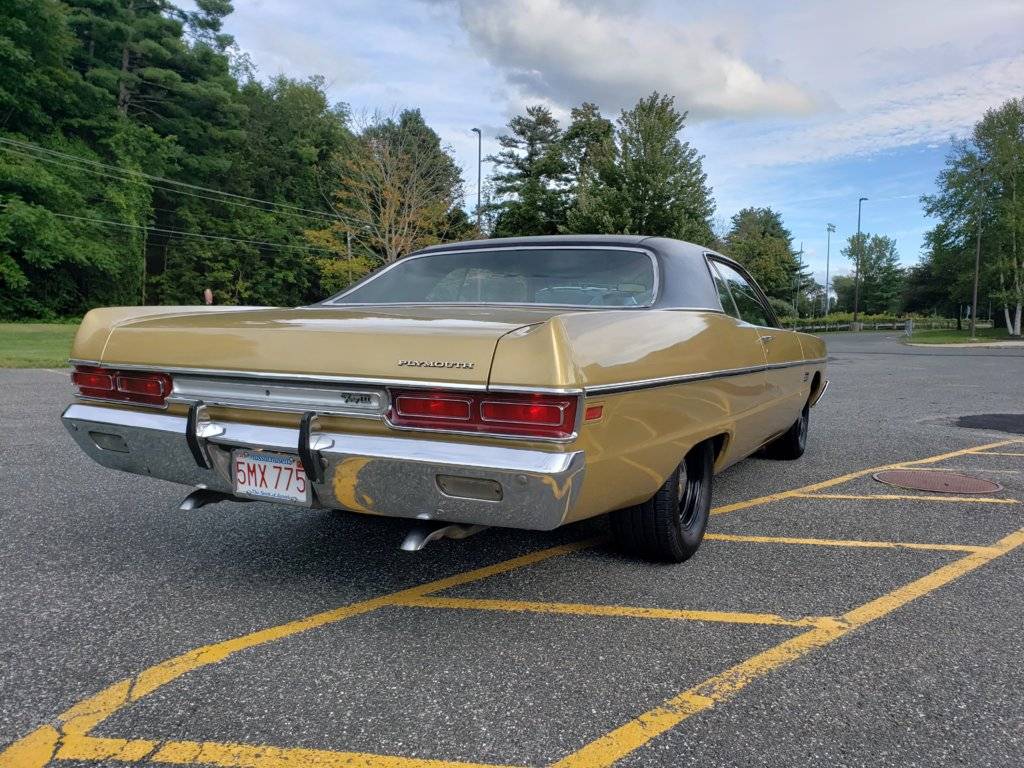

In my opinion 2 inch will look too small and 2 1/4 will look almost big enough as with my 69 Fury. 2 1/2 would be yummy.
pick up a couple of 2 1/4" to 2" reducers and temporarily fasten them under the bumper to see which looks best to you.
