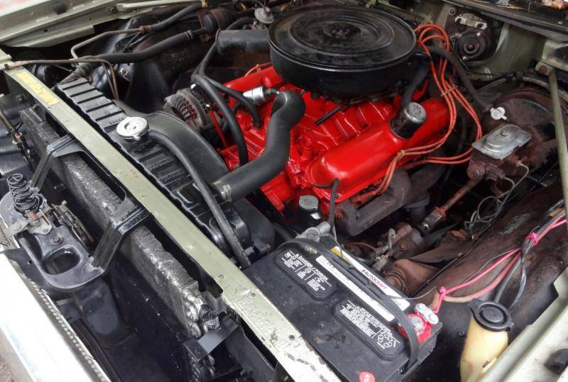

The 318 got a new double roller timing set, water pump, thermostat, rad cap, gas line & filter, Trans cooler, Oil & filter and fresh anti-freeze. Plus a little spiffing up.

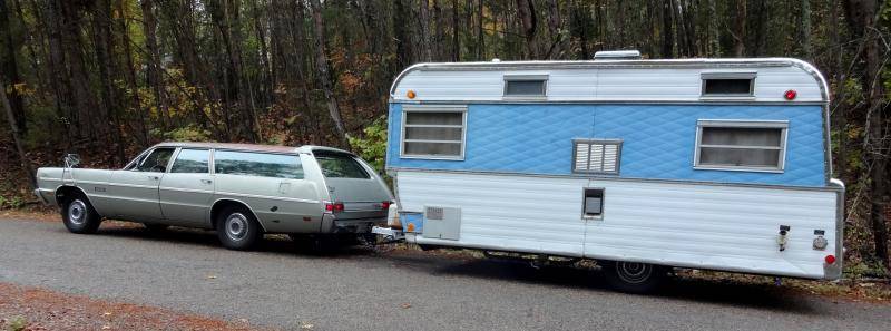

Looks great! Hard to see in the photo's if you have an equalizer hitch, if you do crank it up a bit to level out the wagon and keep the headlights out of the trees. If don't have an equalizer hitch, get one, you won't regret the purchase.
There is a set of equalizers on it. I'll wait until I have everything loaded and make the final adjustments...... :icon_thumright:
It may not be pretty this trip, but by next summer both the Admiral and Connie will be sporting new finishes.
Look at that. . . A correct radiator cap and a molded top radiator hose. Where is thr rest of the A/C ?
I removed the factory brackets and idler because the compressor was already off. Plan is to convert to the Sanden compressor before next summer.
Thanks Joetrucker. Look close, there is a factory tow package trans cooler just in front of the A/C condenser. I installed that last Saturday.
