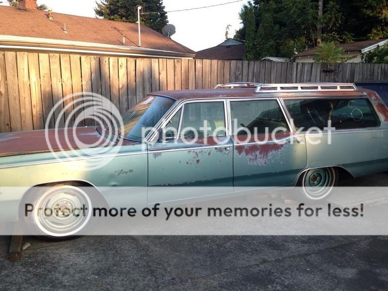

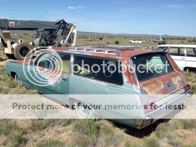

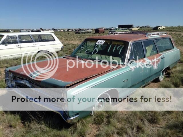

    Now that I've made my official introduction, here's the thread documenting the resto of my 1967 Fury III station wagon.
    It was found in Oregon by a friend of mine (I believe on Craiglist), so maybe some of you will have already seen it. I found the ad back via another site:
    http://www.2040-cars.com/Plymouth/G...ne-passenger-wagon-with-great-patina-1139561/
    [​IMG]
    I am selling a !967 Plymouth Fury III Nine Passenger Wagon. The car has a 383 big block backed by an automatic transmission. The car was originally purchased in the Redmond Oregon area and spent its entire existence in that area. The previous owner to me bought the car in 1988. He then drove it to his property in the Prineville Oregon area parked it and never drove it again. The car had been sitting in the same spot for 26 years until I purchased it recently.
    Her is what I know. The front end has some damage. The hood, grill, cowl, filler valance, one headlight bezel and the hood latch bracket have all been damaged. I believe the filler valance and the bracket as well as the cowl can all be repaired and used. The hood may also be possibly saved to protect the original patina of the car. I have had the motor running and it sounds good. The brakes are currently inoperable. The gauges and lights all seem to work. The factory a/c components are all there but I'm sure it will need serviced. The interior needs a complete restoration with the exception of the third seat which looks as if has never been sat in. The glass is all good with no cracks or chips, all the windows roll up and down, even the power rear window. There is no rust in the floors or body panels. The spare tire well has 4 pin holes and a thin area of surface rust on the inside of the tail gate. I would consider this car rust as rust free as it could get. I have described the vehicle as best as possible. If you have any questions or would like more pics please contact me.
    As I found out, it was originally part of the 'Charles Kee collection', which was discussed on this very site some time ago :
    http://www.forcbodiesonly.com/mopar...ard-Up-For-Sale-In-Oregon!!&highlight=charles
    http://moparblog.com/charles-kee-collection-in-brothers-oregon/
    Charles Kee was apparently a car collector/hoarder that had amassed several hundred cars on his property in Brothers, Oregon. A lot were sold during the years (mainly A and B-bodies I think), and only the less popular C-Bodies remained ? When he died, they were all auctioned off.
    http://www.forcbodiesonly.com/mopar-forum/showthread.php?11488-None-of-Them-Went-With-Him
    http://murphyauction.com/Auction/Details/578
    The funny thing is that, even though I have pictures of the car in the yard, it was not part of the auction. The 66 that was parked next to it was, so I suppose some fl!pper bought it between the day the pictures were taken and the day of the auction.

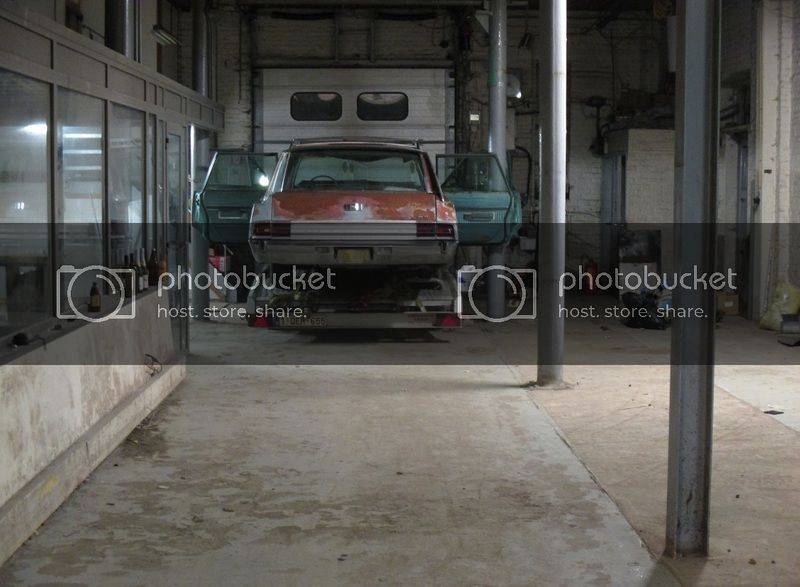

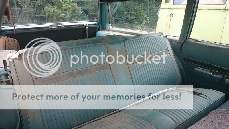

    The car has now been shipped to Belgium, and is still at the shipper's yard. As I have no place to store it at the moment, it will get transported to the shop of the guy who sold me the car, and I'll try to make it running there.
    Here's my plan:
    1. Redo the whole brake system. In the beginning, I thought about going the 69-73 disc route, but if I understand correctly only an ECI/Scarebird kit with 11' rotors would allow me to keep the stock wheels (if somebody could confirm...?)
    2. Go through engine and gearbox to make it running
    3. Redo the whole interior & find the missing/damaged parts (dashpad, spare wheel cover, steering wheel, ...)
    4. Lower it and probably fit some 17in/18in wheels (I know, I know, but I'm ready for the bashing...)
    5. Drive it !
    I'll post pics as I go, but it will probably take another year, year and a half before it's actually running.

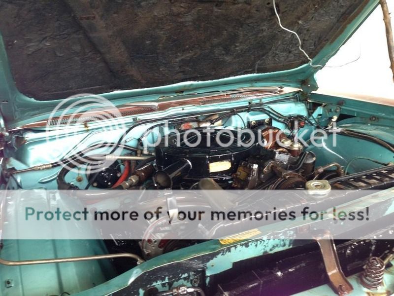

    It appears from the one upside down engine pic that it is a factory disc brake car already? Although that 4 piston caliper set-up can be very costly to redo. I restored one a set-up on a 68 Coronet yeas ago...was into that set-up for about $1500 when all was said and done.

    I'm ashamed to say I completely forgot to check the rim size when I went to look at the car. How can you see it from the engine compartment?
    [​IMG]
    • Like Like x 1

    he is looking at the brake boosty probably
  13. yvre
    yvre New Member
    Messages:
    47
    Likes Received:
    48
    Joined:
    Aug 29, 2012
    Location:
    Belgium
    Or the Master Cylinder. I had a look in the manual and it looks like a drum MC to me (disc MC has the longer reservoir near the booster).

    Yes the Bendix brake booster was specific to disc brake cars.
    Yes that is most likely a 4 wheel drum brake master cylinder...but I have seen that swapped on many times before. The correct cast iron disc brake MC can be hard to find sometimes, and people swap on the "easier to find" unit you see in the pic.

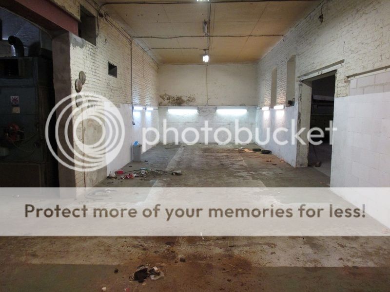

    The car has finally left the shipper's yard and is now stored in my friend's warehouse.
    The winch broke so it has to stay on the trailer until it gets repaired, but at least it's in a dry place now. This poor thing has probably seen more rain in the last 2 months than in 25 years in the desert...

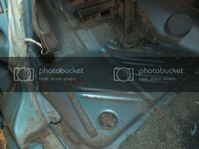

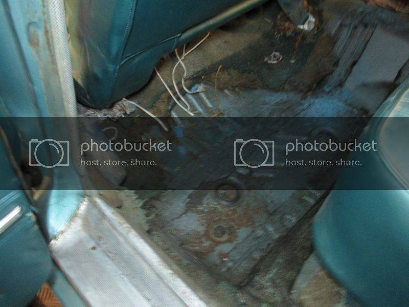

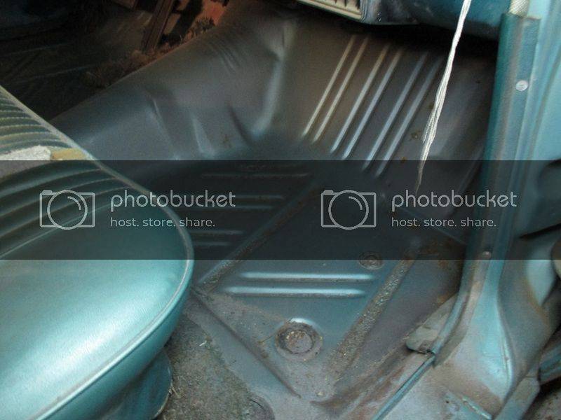

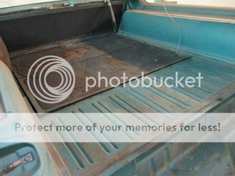

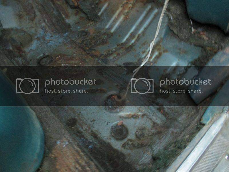

    I went there on saturday for a couple of hours for some much needed bonding. The first thing I did was rip out the smelly, dusty, old carpet. That thing was nasty!!! I still can't get the seats out so there's a bit of it left but the majority is out.
    I was quite happy with what I discovered :
    (excuse the bad pics, the place was really dark)
    The rear right side carpet was damp, and that's where most of the surface rust is located. The belt strips on that side are completely shot and this is where the water was coming from. It looks quite bad in the pic, but it actually just needs a good cleaning, I didn't find any hole.

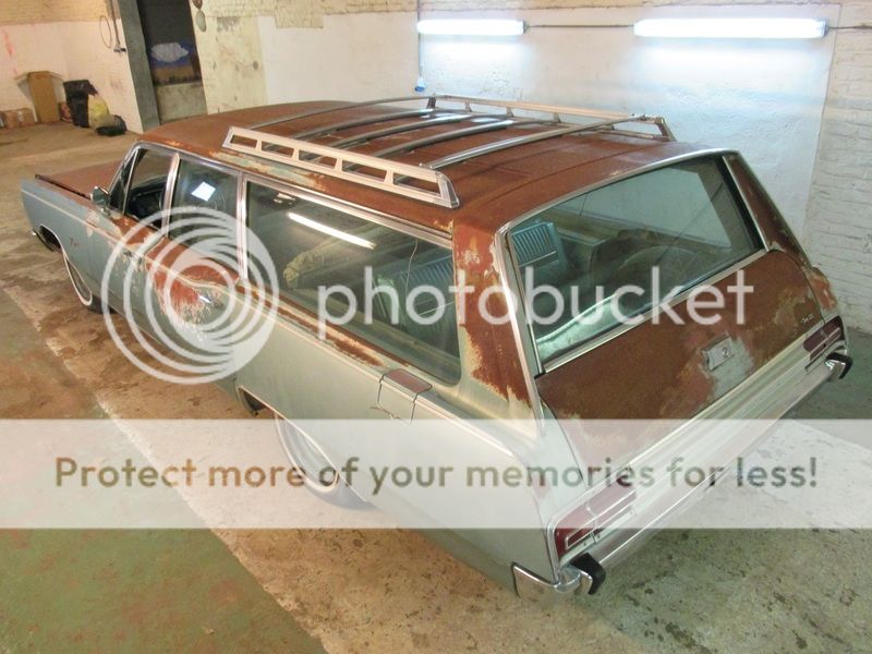

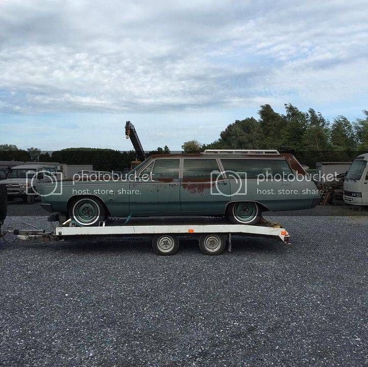

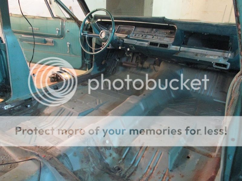

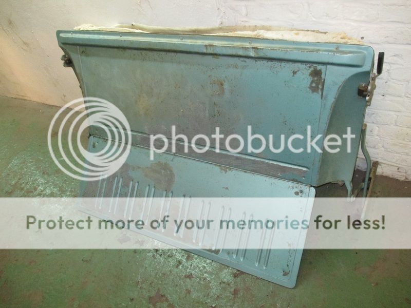

    I got the car off the trailer last week so I could put it in its temporary spot. That required another 2 hours of cleaning as it was a real mess.
    [​IMG]
    [​IMG]
    Unfortunately, I learned that my friend will not be keeping the place, which means I'll have to move the car again in the near future. It's a shame as this place is super roomy, dry, and not too far from my home.

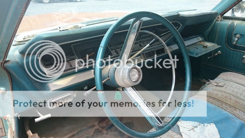

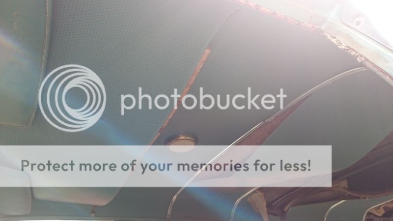

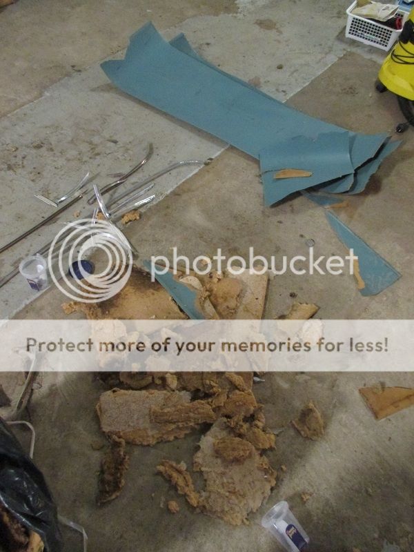

    In the mean time, work continues inside the car. I removed the remnants of the headliner, but unfortunately I could only save 2 plastic bows. They were very brittle and most just crumbled as soon as I touched them. I'll try to find some 2[SUP]nd[/SUP] hand ones (good luck with that...!) or find a homemade alternative.
    [​IMG]
    With the help of a friend, I also got the seats out so it's much easier to climb inside the car to clean and scrape the back of the seat panels. Next step is to wire wheel the surface rust on the roof and the floors.
    [​IMG]
    [​IMG]
    [​IMG]

    Just an FYI on those wagon headliner bows, you will never get the plastic trim off of the metal retainers so I just remove the end caps and unscrew the ends and take them off in one piece.
  20. yvre
    yvre New Member
    Messages:
    47
    Likes Received:
    48
    Joined:
    Aug 29, 2012
    Location:
    Belgium
    That's an excellent tip... that I'll remember for the next one... :-/
