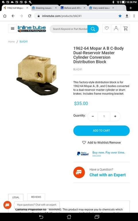

I did the single to dual master cylinder conversion today, all the brake lines came loose, the distribution block I got from inline tube fit perfectly, all the old brake lines fit into the new block(with a little persuasion) the new master cylinder fit, I got the right length lines to go from the MC to the block, didn't even have to bleed the brakes to get a pedal( but I plan to)

Keep an eye on the distribution block from inline. I got a couple from them for a 67 Dart that leaked terribly. My work around solution was to replace the copper gasket (mine was a two part block) that came on it with something I got from McMaster Carr and so far it is dry. Yours might not even have a copper gasket so you may not have anything to worry about.
Mine was one piece and no copper gasket, only fitment, problem was the bolt hole and tab were bass ackwards and had to bend the tab up and put it on backwards to get it to fit
I tightened it as much as I dared, but do need to keep an eye on that so it doesn't work loose and cause a brake line failure due to vibration
