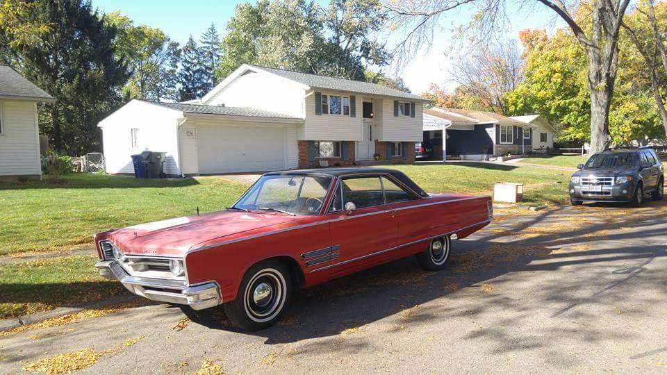

Maybe there is another thread for this already but I purchased this 66 300 and it is my first project car. There are a ton of things to do and I was wondering what type of order they should be in and possibly why. Also feel free to add to this list. Driver, not a show car by any means

I hope this helps, from the picture it looks nice.
