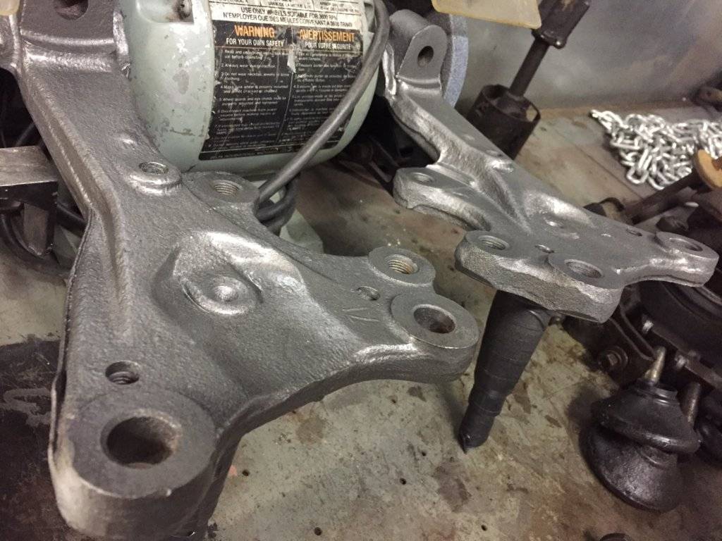

I finally am preparing the parts for upgrading the Polara for the 73 disc brake & rear 2 1/2” drum conversion

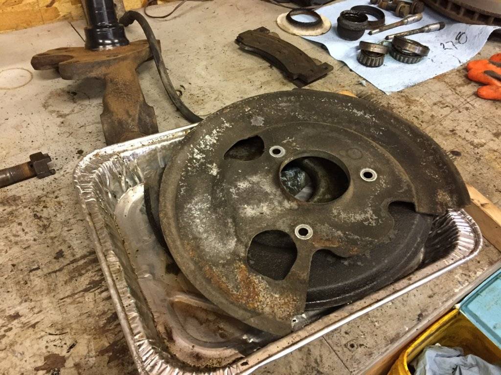

Getting the pieces ready for installation
I saved everything brake related from the 73 Newport from a few years back
Starting the job next Monday with the help of another car guy

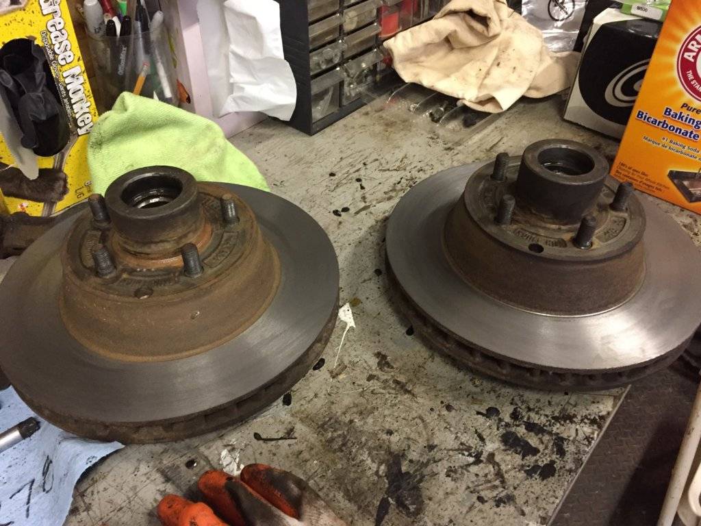

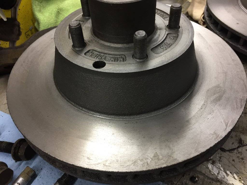

The rotors and drums were like new and needed just a light clean up to get ready saving me a good chunk of change :thumbsup:

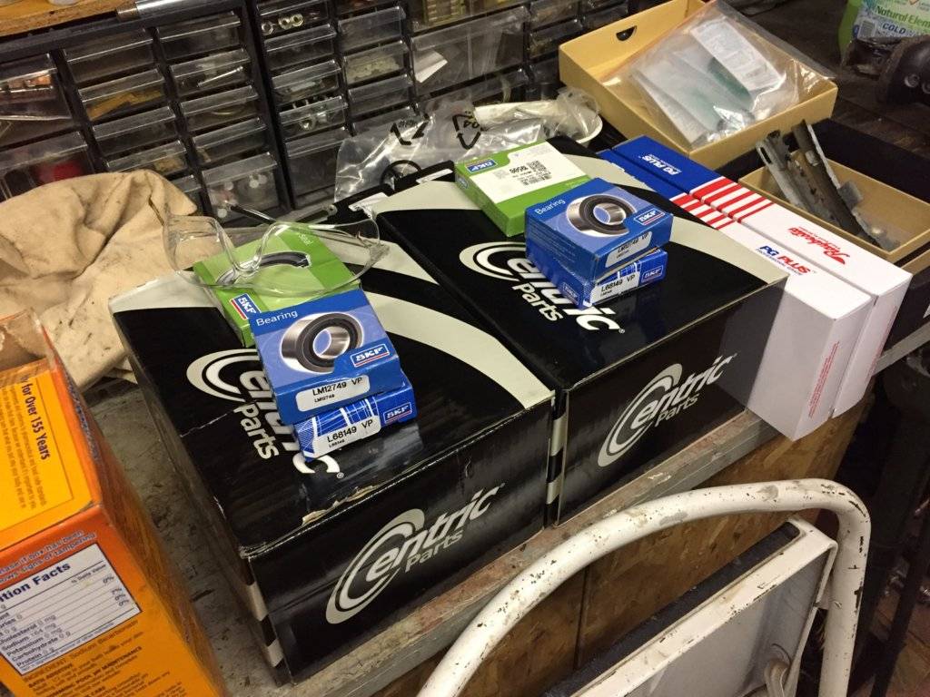

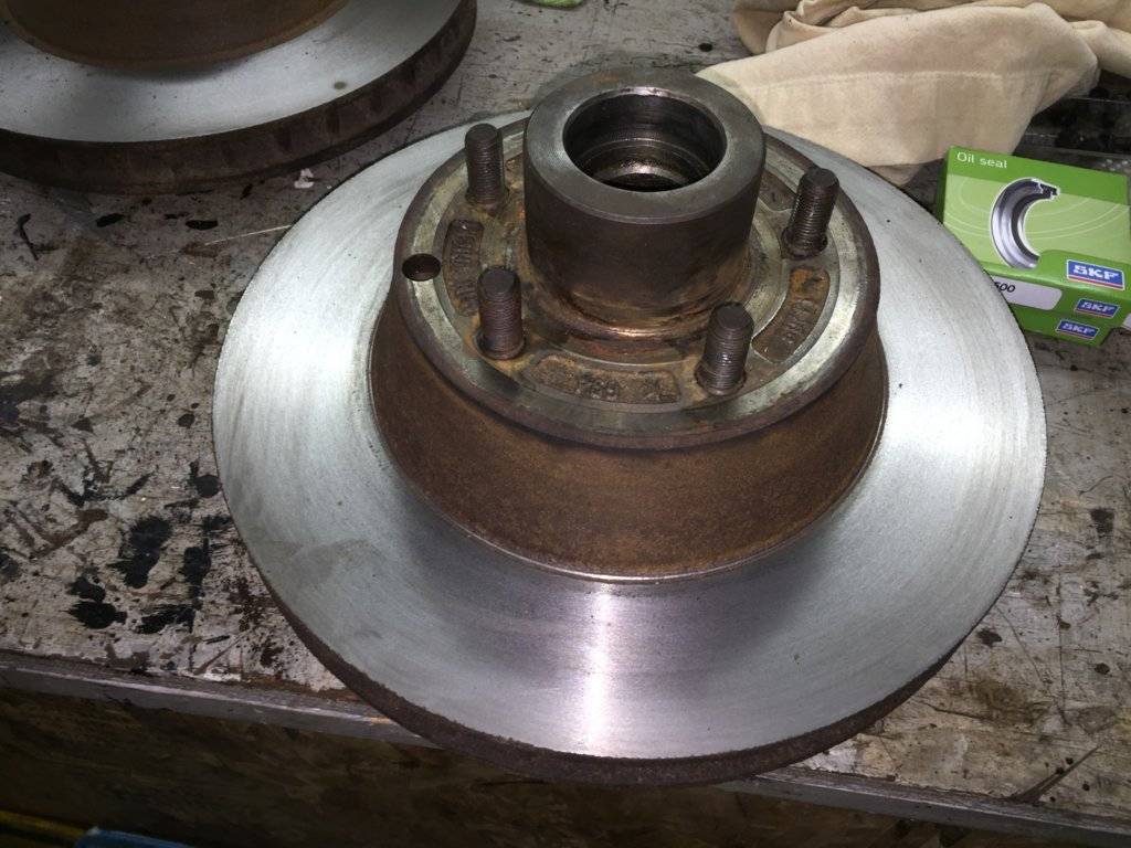

I bought the basics from Rock Auto
Strangely The SKF bearings I ordered came without the races???
Never seen this before
The refund is not a problem
They state if it isn’t pictured then it is not included

Probably because a new set of rotors have the races installed, but my timken set came with races. Good luck it has to go smoother than mine. :)

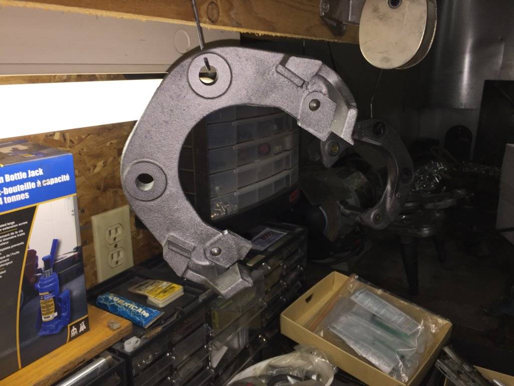

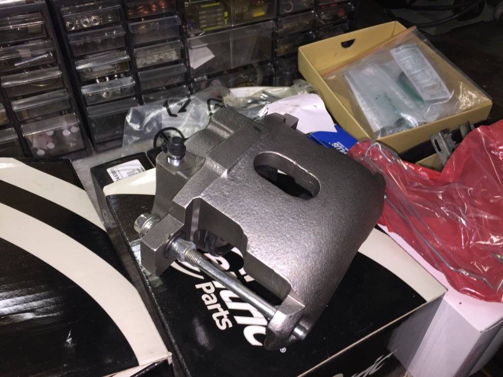

Here is a picture of the Centric calipers I bought. it lloks like they used sowm type of finishing on them to preserve the look.
Couldn't go wrong on the price $43.00 each

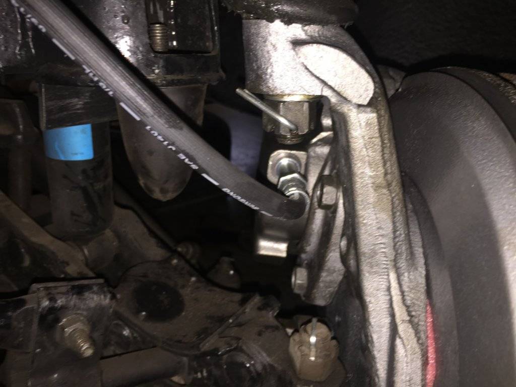

Pins, rubber bushings, flex hose washer with caliper.

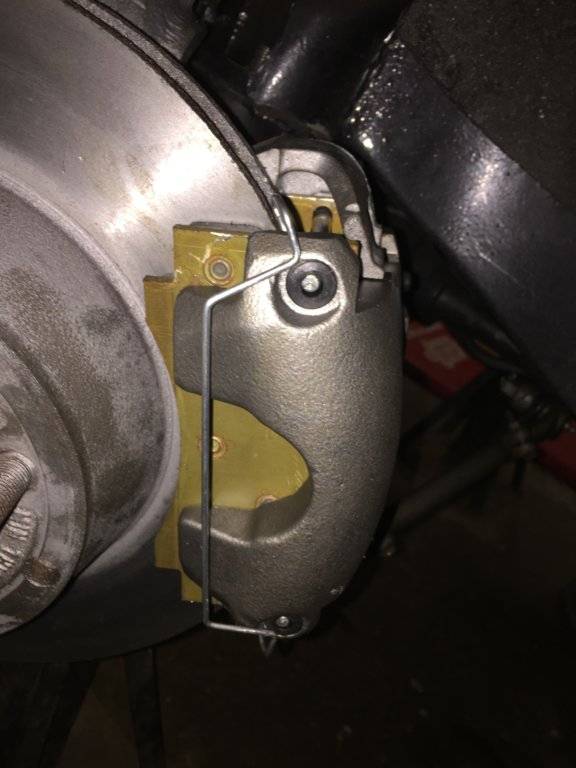

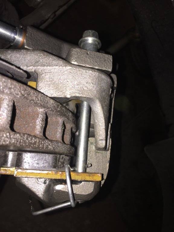

Even a clip was included that I have to figure out where it goes..

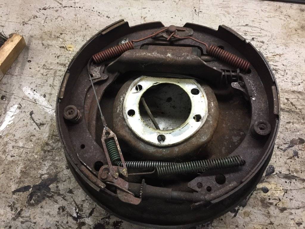

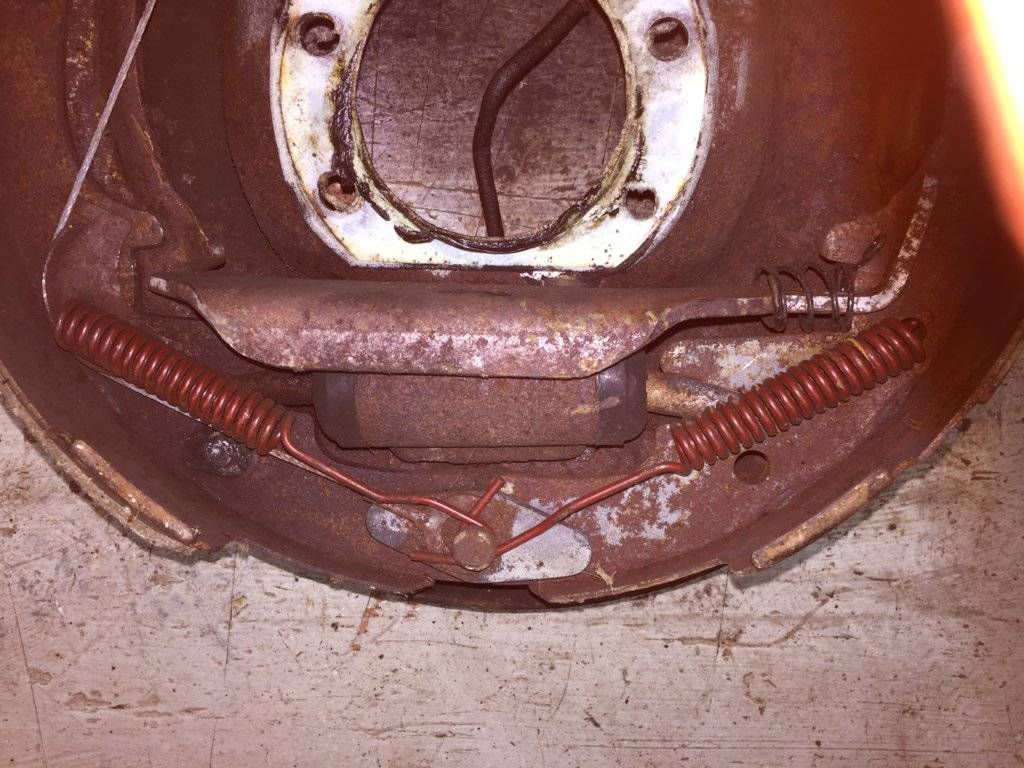

Onto the rear brakes now

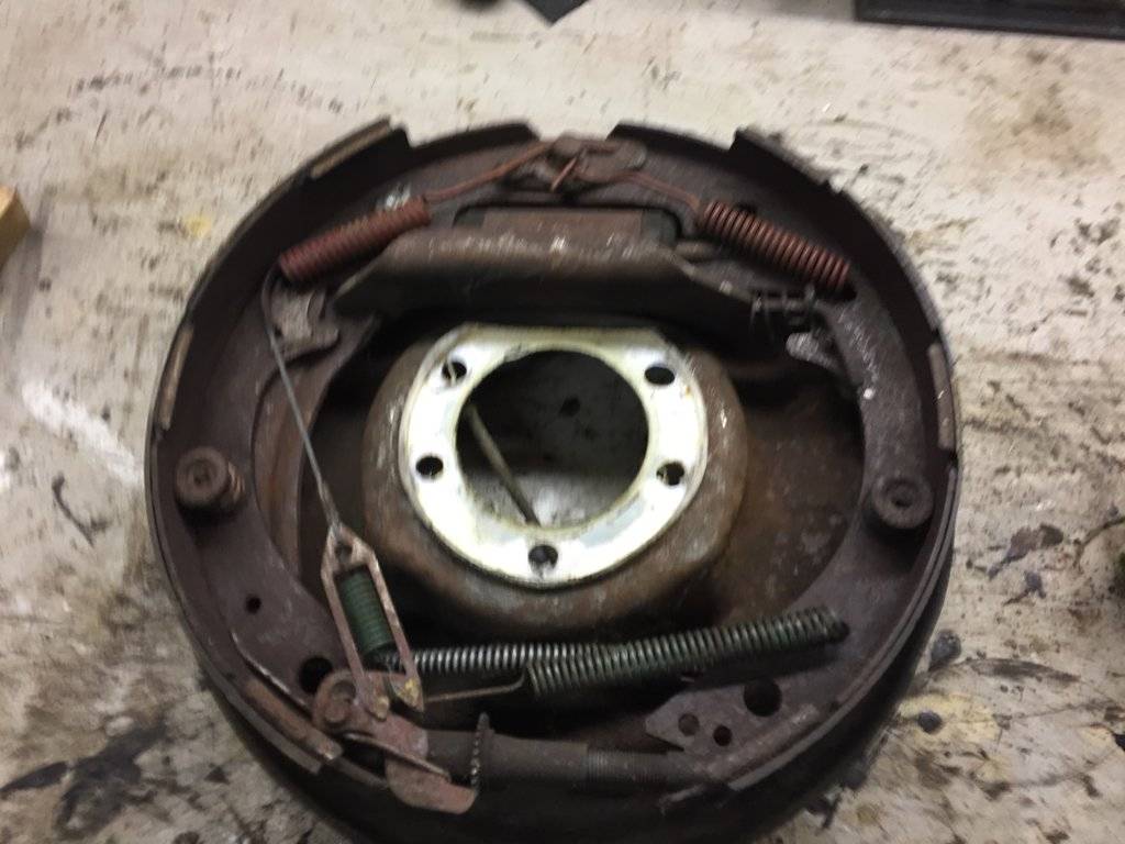

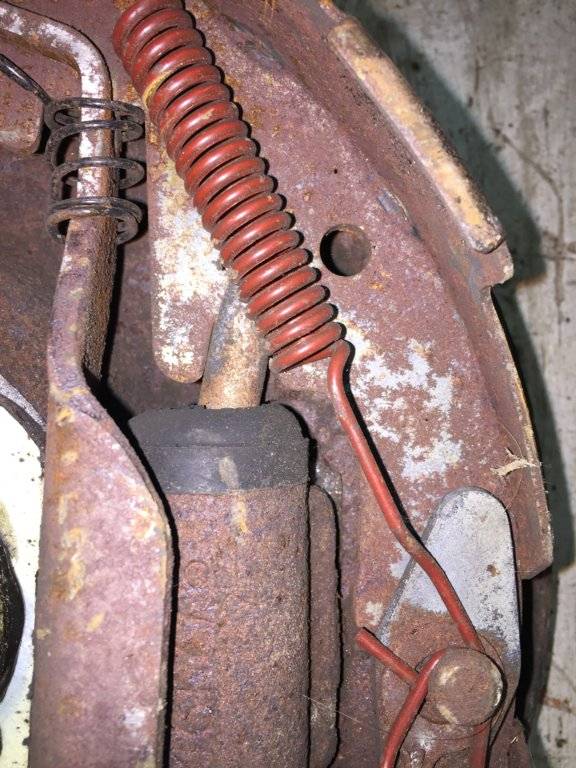

I noticed right away that the wheel cylinder pins are crooked on both sides on the left pins
Great work, sorry about the bad info on the clip. I intially installed them incorrectly, I may have taken the picture at that point. I will definitely check to make sure. If there are no clips I will know I left them in the wrong position. :)
It wouldn't surprise me if I did, just adds to my disc coversicon saga. Thanks for the detailed pictures
No worries Mike
I’m pretty sure you would have heard the grinding for a few minutes just before hearing the metallic thwang as they ground down to nothing and flew off onto the road :lol:
