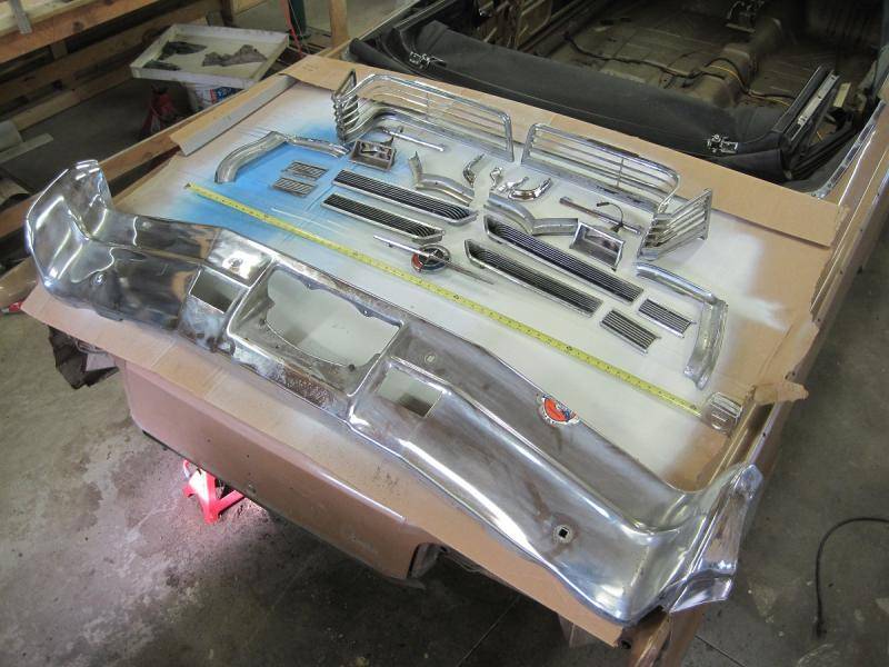

The trim is finally off the 300. I laid all the trim that I would like to get re-chromed. Most are pot metal pieces except the rear bumper. Overall the bumper is in pretty good shape, one small dent, a scrape and a couple of small rust spots. The worst of the pot metal is the rear back-up light assembly.

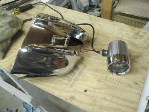

I worked on doing some polishing too. The performance indicator cleaned up perfectly. The front bumper is in really good shape. It is pitted but not on the list of chroming at this time.

How did you polish your pieces?
Nick
I use Maas polish. I have used a several over the years and personally like it the best. The bumper section had a light corrosion and I took a ball of aluminum foil soaked in soapy water and rubbed it to clean it initially. The aluminum won’t scratch the chrome. Here is a before photo.
