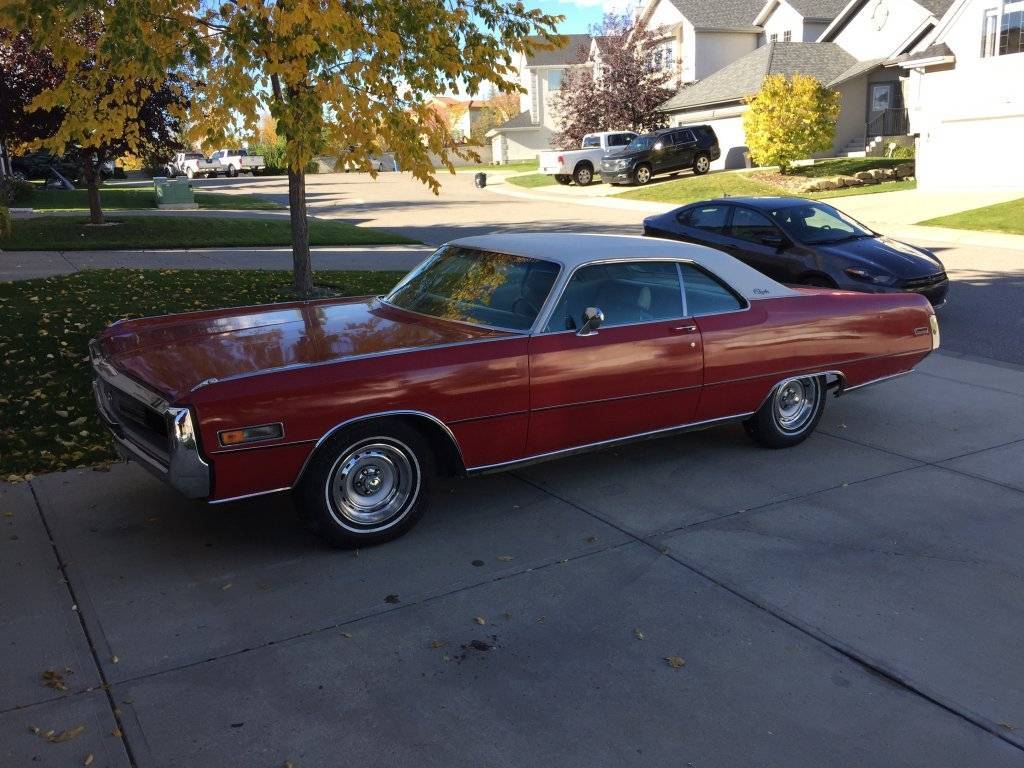

I thought it was about time (1 year later) that I begin my restoration thread of my 1970 Chrysler 300 2 Door Hardtop. Thank you to all the members here who have assisted me with everything from parts to advice to what's this thingy do. Scorch is destined for a complete nut & bolt restoration some day but for now here is my story...........
DAY ZERO (December 2015)

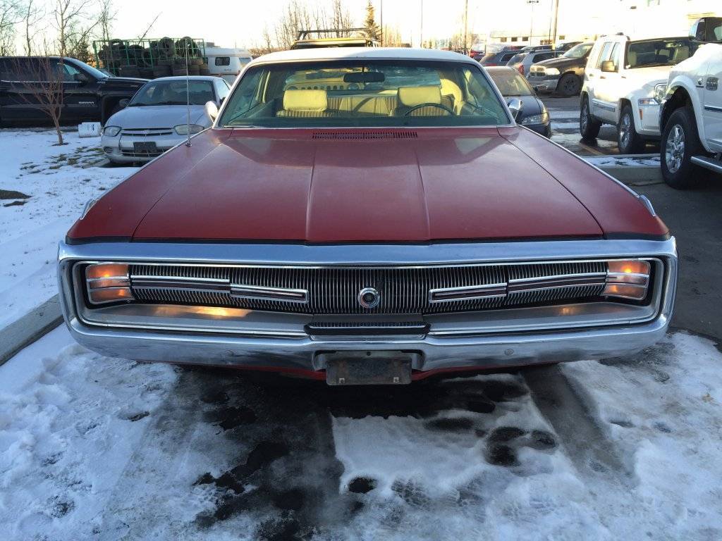

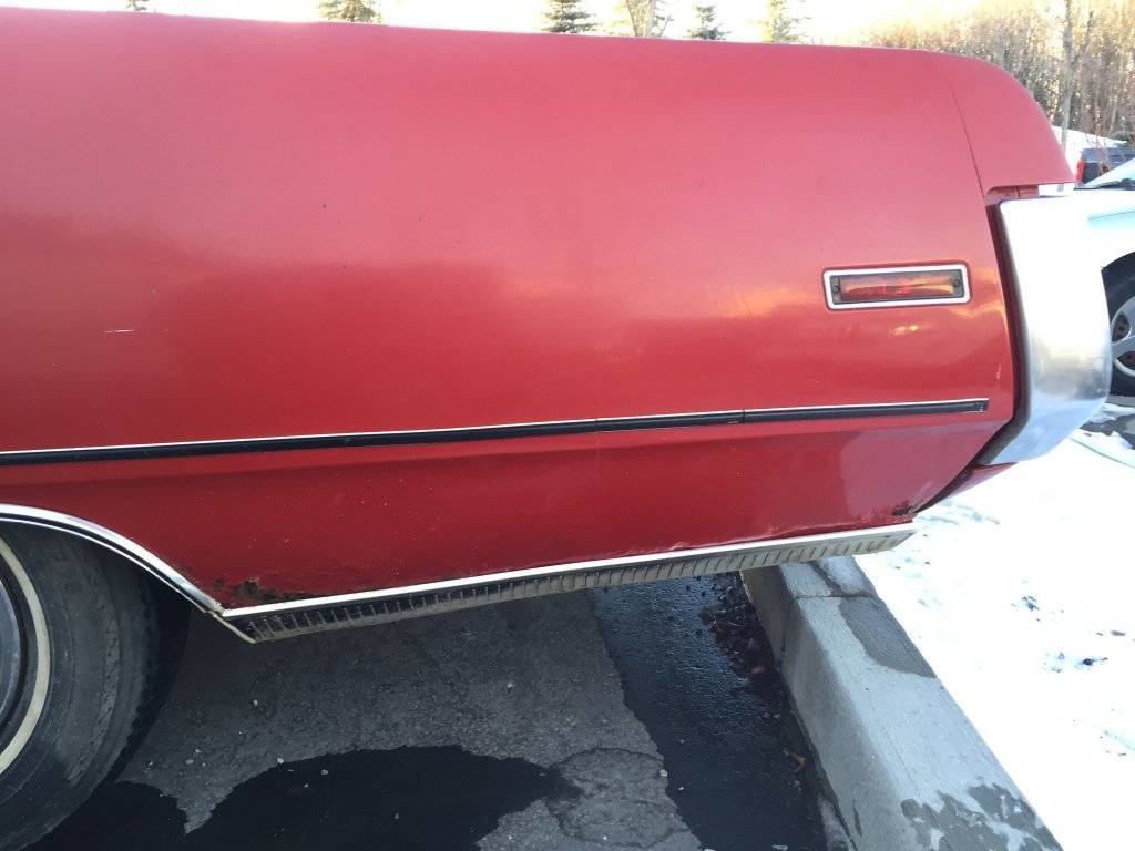

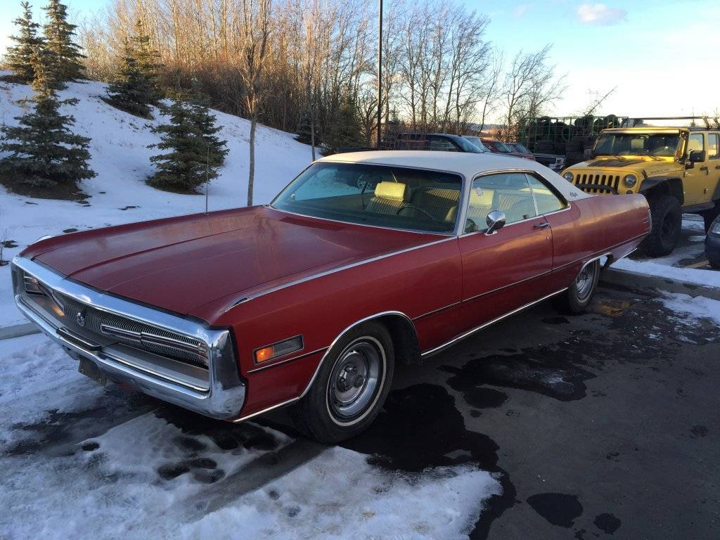

Even though I had just purchased 2 1966 Chrysler 300's this past August 2015 I was still checking the local classifieds for that special find and what parts might be out there for these girls.I came across an ad for a 1970 Chrysler 300 2 Door Hardtop for sale 20 miles away. The seller was asking $3900. I contacted the seller in my "Official" capacity as GSM of the local Chrysler Dealer to see what his intentions were. As it turned out he was a known customer of ours who was looking to make room in his shop for a new Truck. We negotiated a deal whereby he traded in the 300 for a new Ram 1500 and I became the proud 3rd owner of Scorch. He had bought the car as a used vehicle 43 years ago with 8000 miles on it. He disclosed to me that he had it repainted once in the late 80's and that there had been some accident repair to the panel behind the driver's door. My initial investment will remain secret but suffice to say he got a very good deal on his Ram and I got a very good deal on the 300....Win Win He loved this car and even took some "Glamour" pictures after the repaint years ago and framed it. He passed that onto me....
continued........
DAY 1

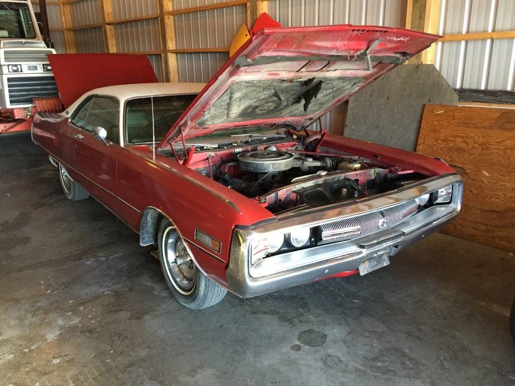

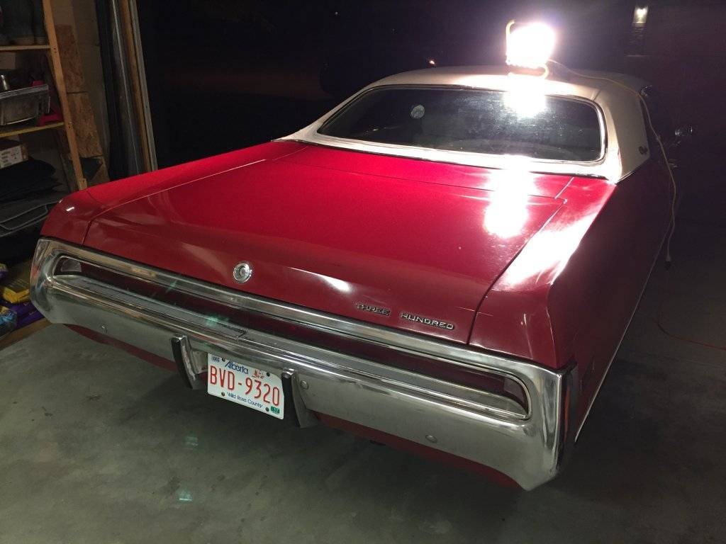

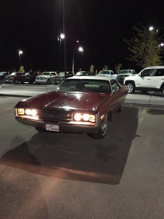

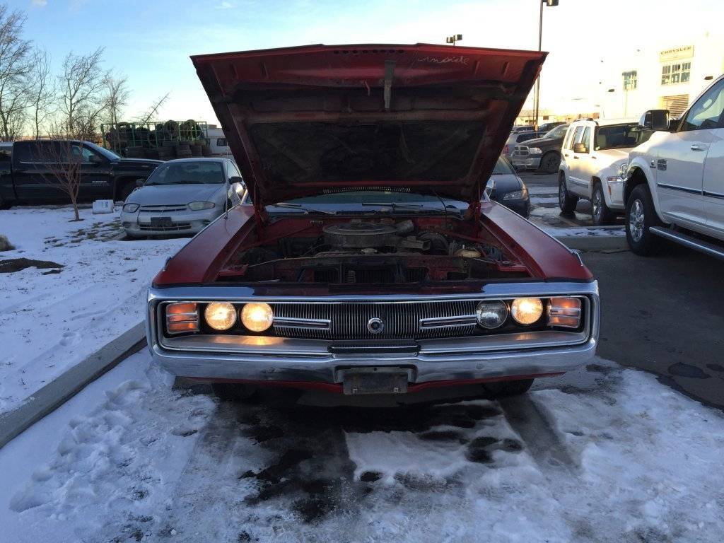

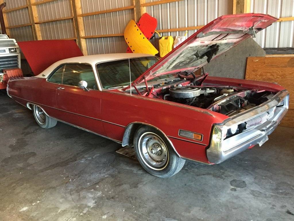

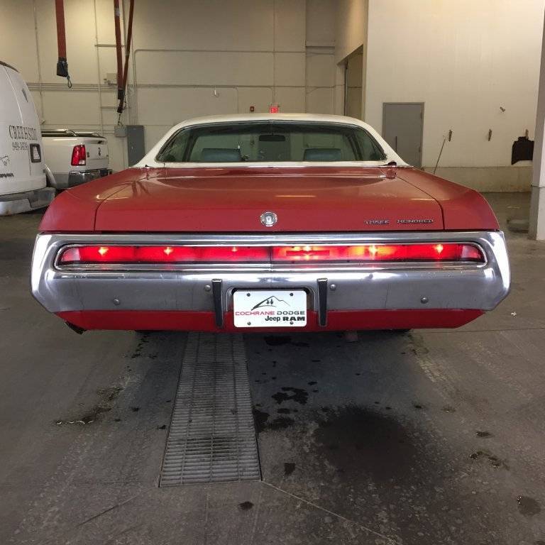

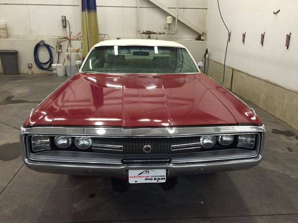

Here are some pictures of the day I went to see the car and made my deal...
DAY 2 The Journey Begins...

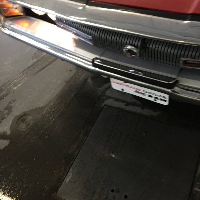

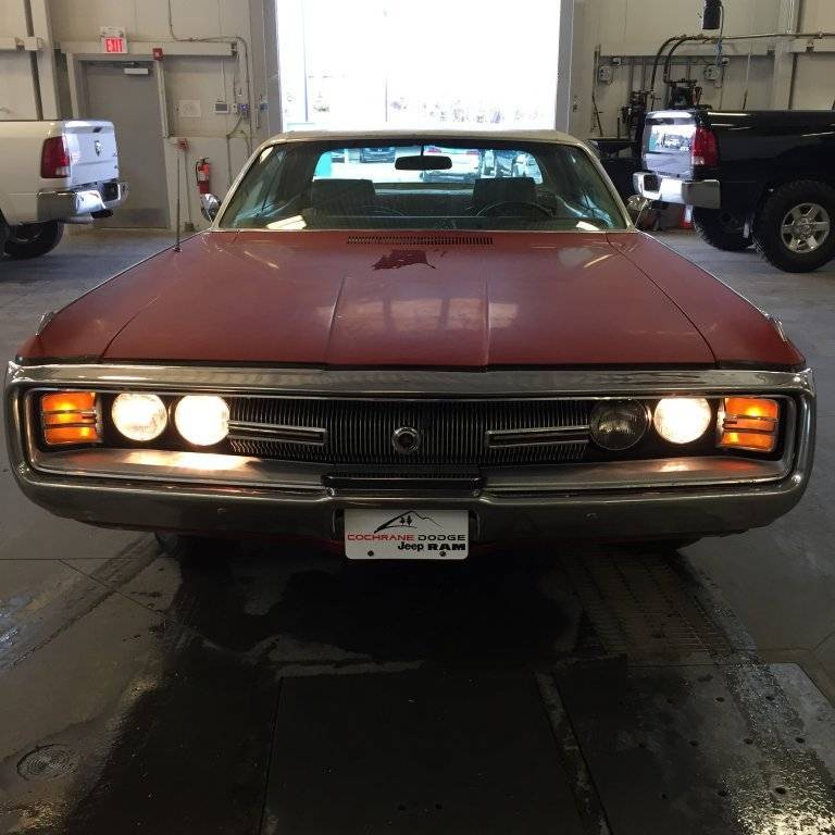

Scorch arrived at the Dealership December 4th, 2015.

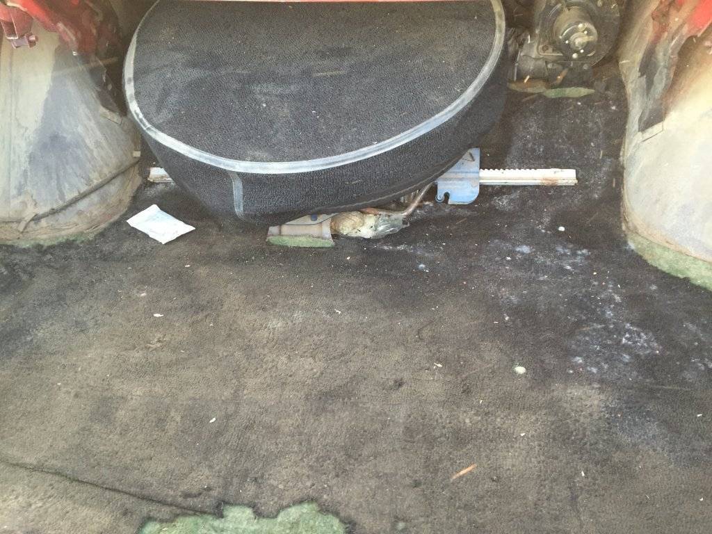

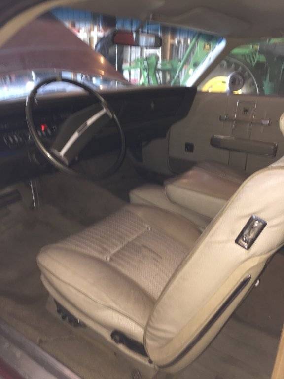

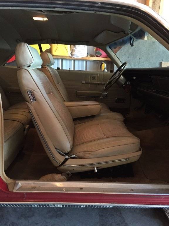

THE GOOD......

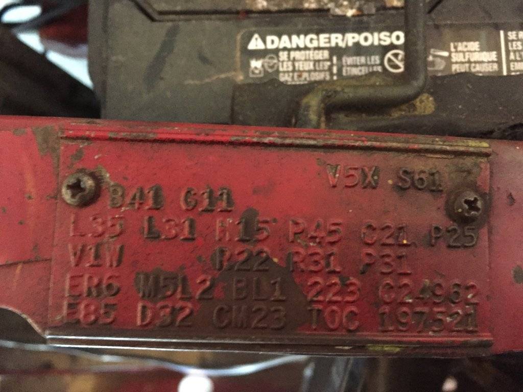

SCORCH VITAL STATISTICS
CLASS: CM23 Chrysler Medium 2 Door Hardtop (300 Hardtop)
ENGINE CODE: “T” 440CID 350HP
YEAR: 1970
PLANT: Jefferson Avenue, MI, USA
SEQUENCE: 197521
BUILD DATE: February 23, 1970
ORDER NUMBER: C24962 Canadian Market
E85: 440 CID 4 barrel V8 350hp
D32: Heavy Duty Automatic Transmission
ER6: Crimson Red Exterior Color
M5L2: Trim - Opt. Decor Group, Cloth/Vinyl Bucket Seats, Parchment
BL1: SandPebble Beige Int. Door Frames
V1W: Full Vinyl Top, White
R22: AM Radio with 8 Track (10 Watts)
R31: Rear Seat Speaker(s)
P31: Power Windows
L35: Cornering Lamps
L31: Hood/Fender Mounted Turn Signals
H15: Rear Defroster
P45: Power Deck Lid Release
C21: Center Front Seat Cushion
P25: Power Left Front Seat
B41: Front Disc Brakes w/Standard 10in RR Drum
G11: Tinted Glass (all)
V5X: Body Side Stripes, Black
S61: Tilt/Telescopic Steering Column

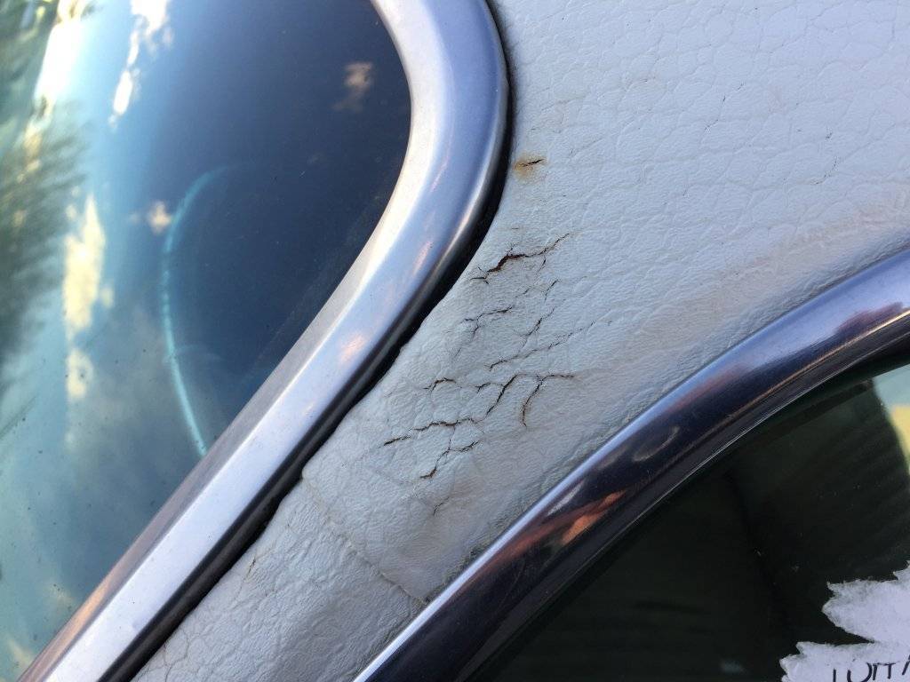

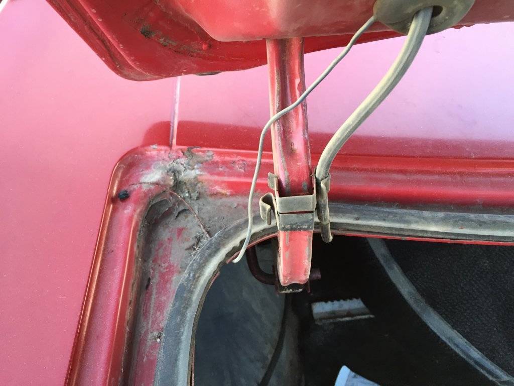

THE BAD.......

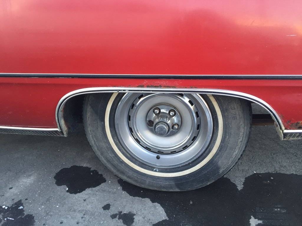

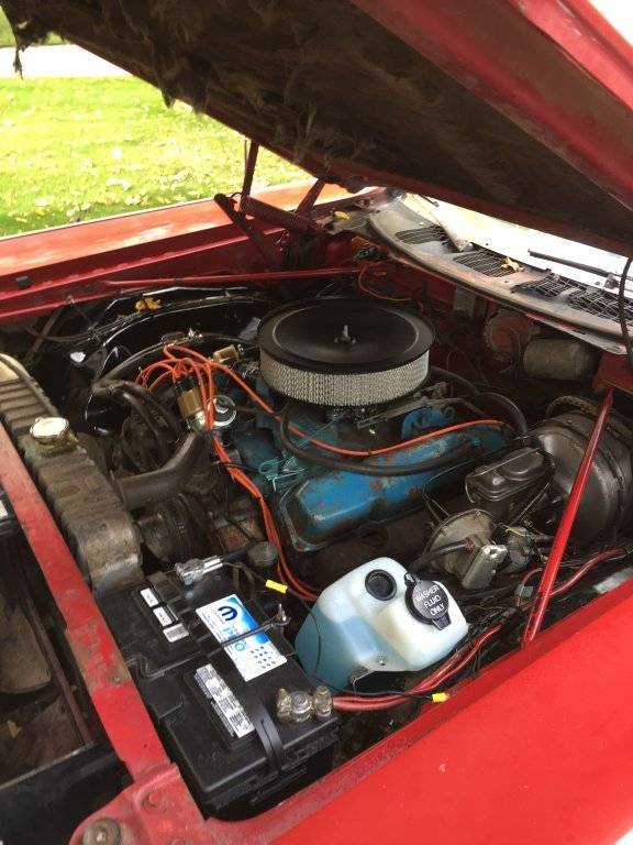

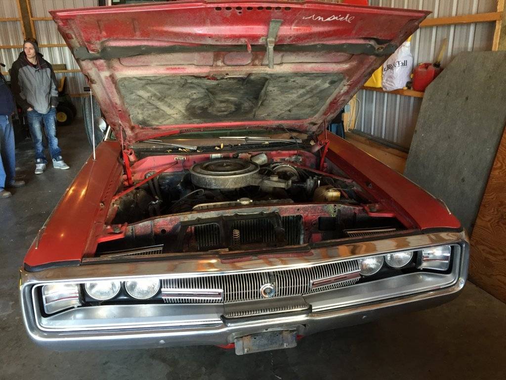

Scorch was not a Happy Camper the day she was delivered. She could barely muster enough horsepower to get herself off the trailer. Something was definitely wrong. Heavy miss under load...mmmm see my previous posts on the matter..
Bad Hesitation Under Load Advice Needed

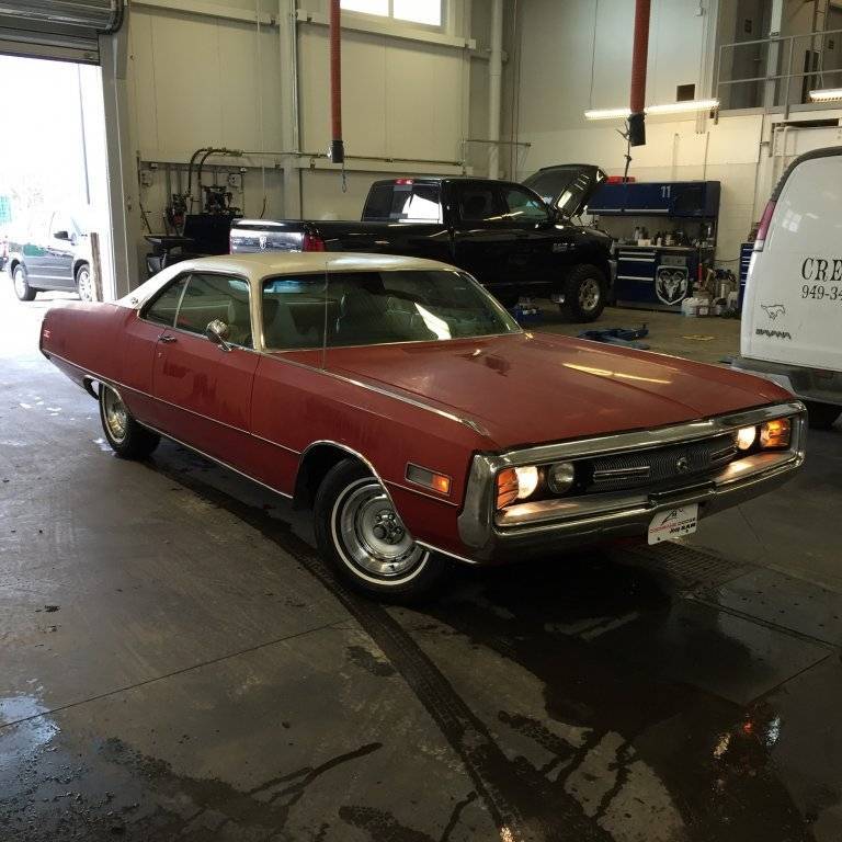

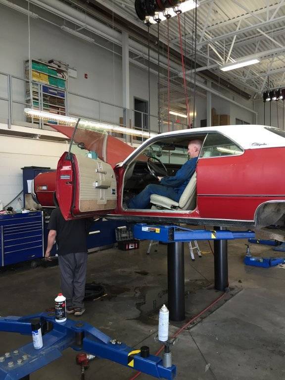

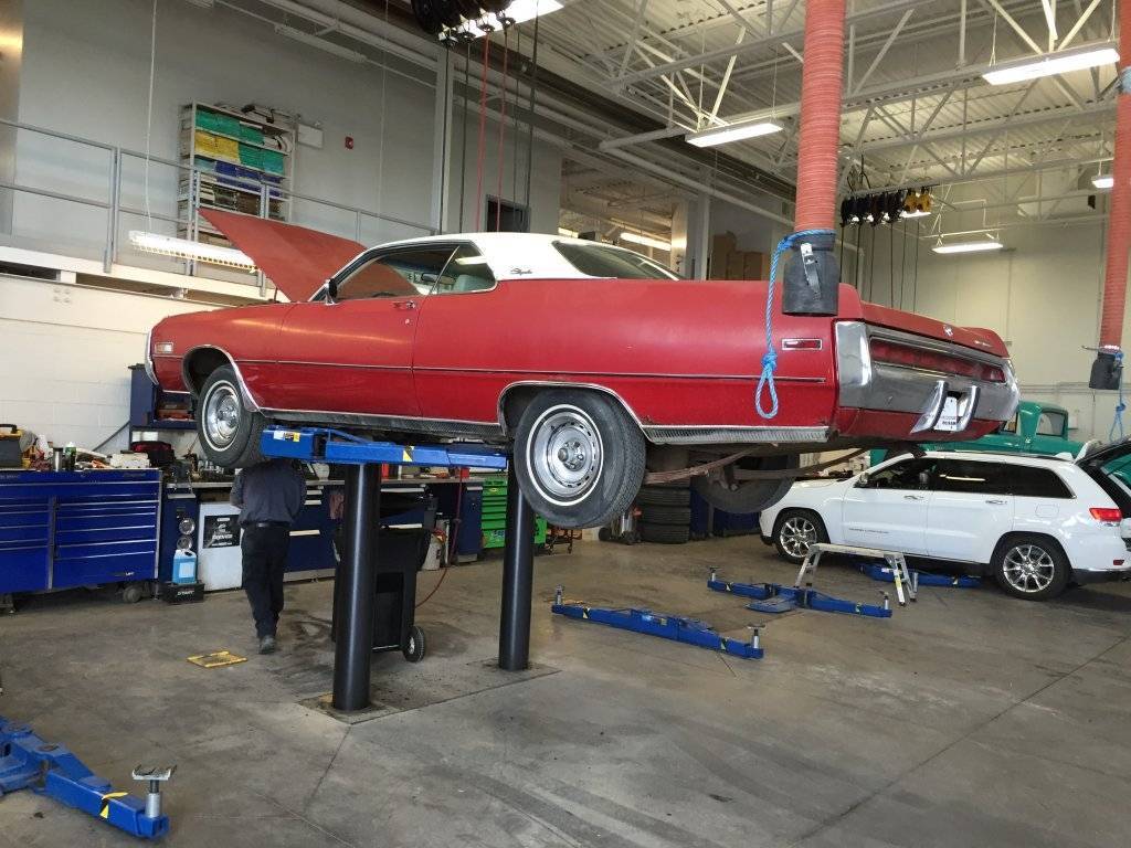

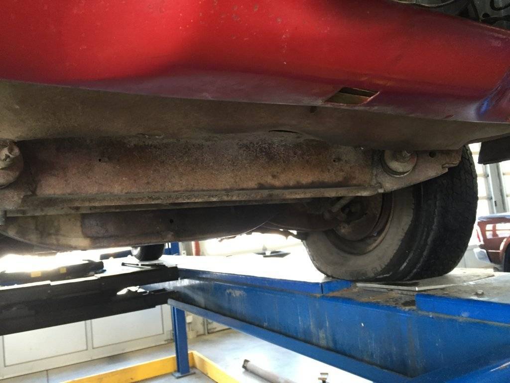

FIRST LOOK OVER IN THE SHOP....March 2016

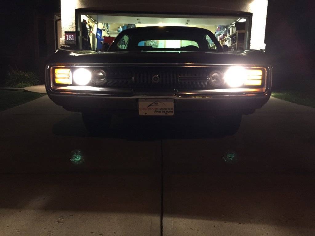

Pulled her into the shop to evaluate and determine first order of business...I'm pretty sure the first thing I fixed was the High Beam...lol

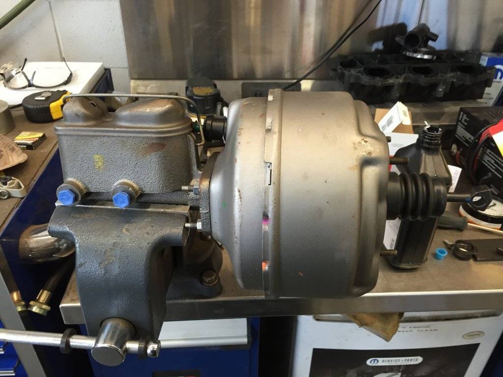

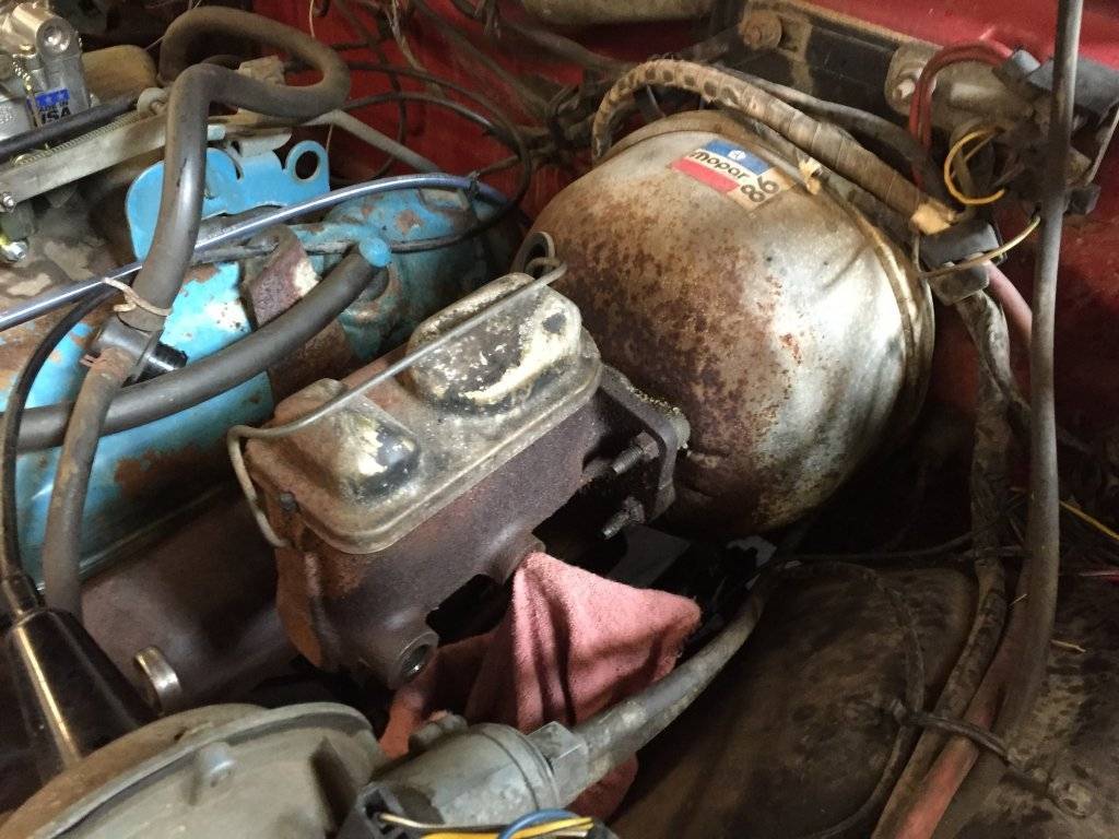

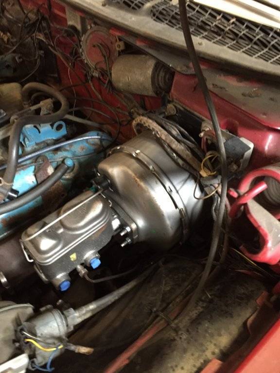

Replace Brake Booster for vacuum leak

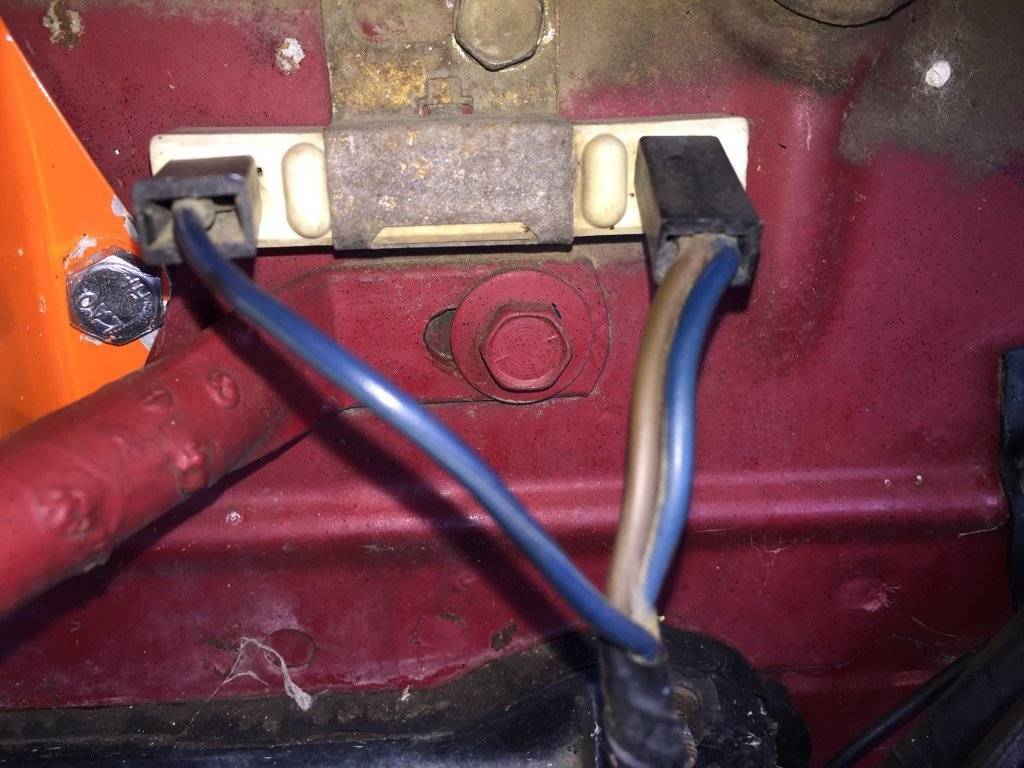

Headlight motor only works one way

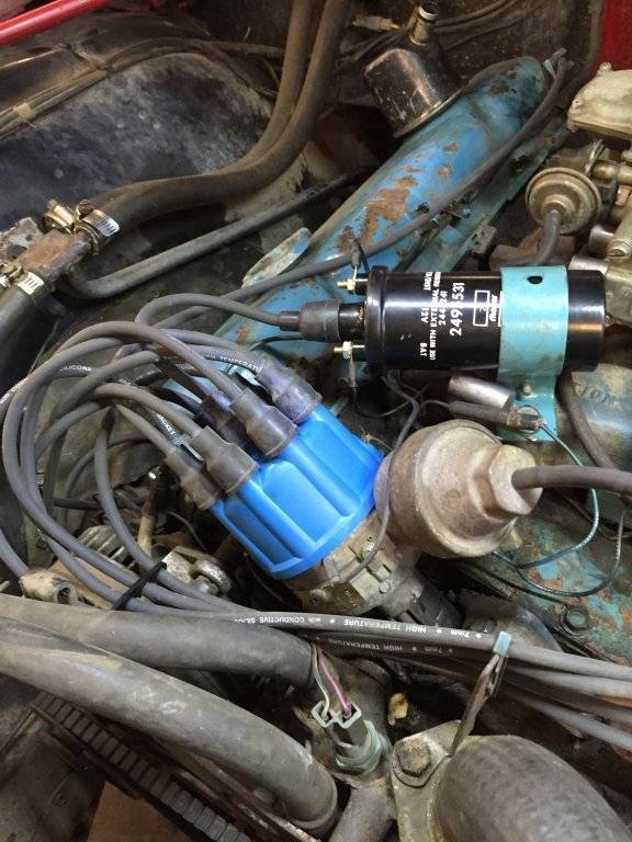

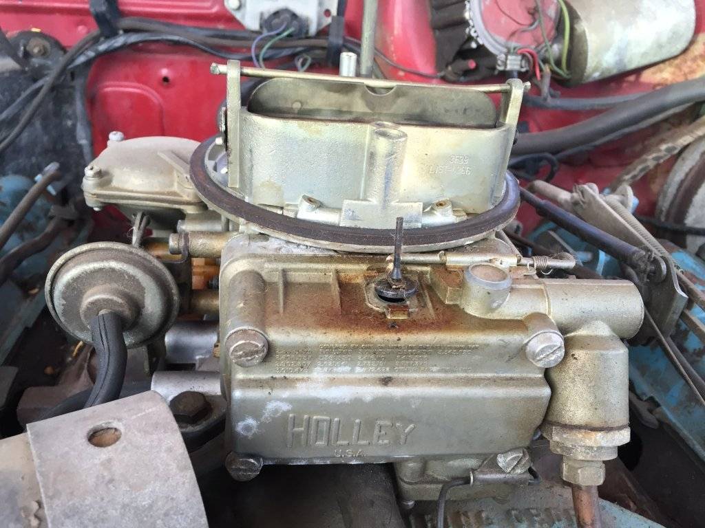

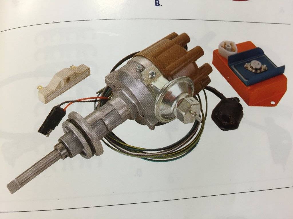

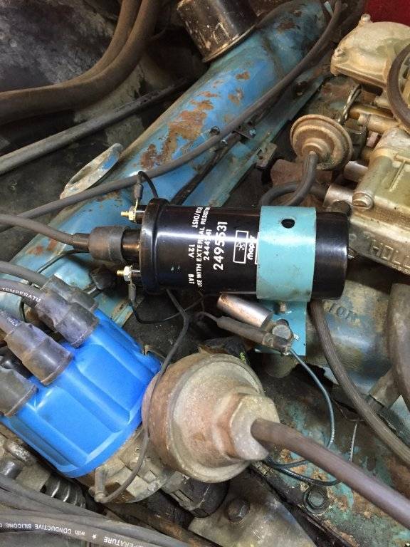

OK here we go. Replaced every friggin component regarding ignition no change in hesitation WTF?
Sorry Holley......Hello Eddy 1406

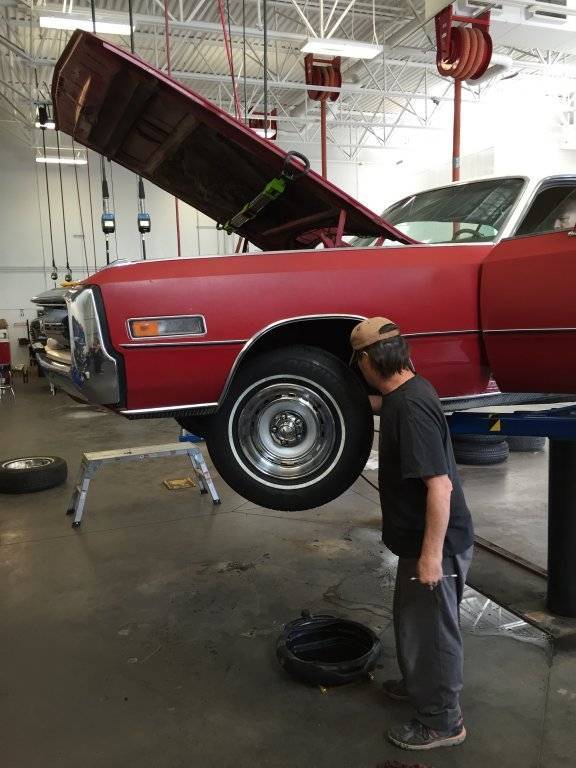

WHOA NELLIE.....BRAKE BOOSTER REPLACEMENT (STARRING CANCRITTER)

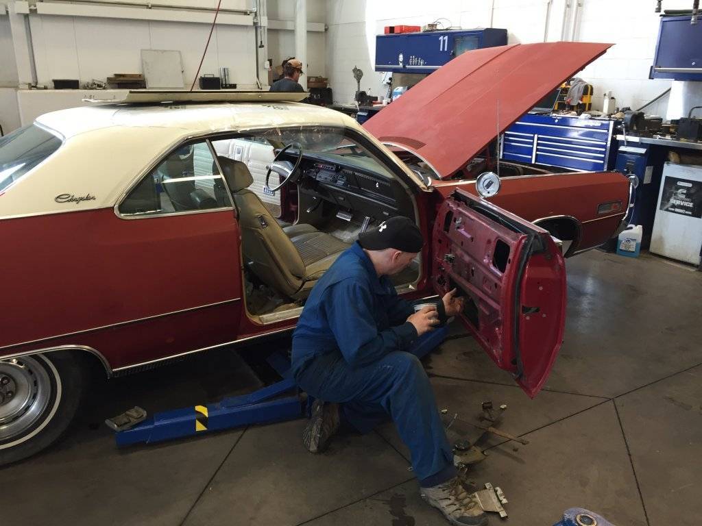

Picked up a new MC and Booster from Rockauto and had a special assistant to help install...

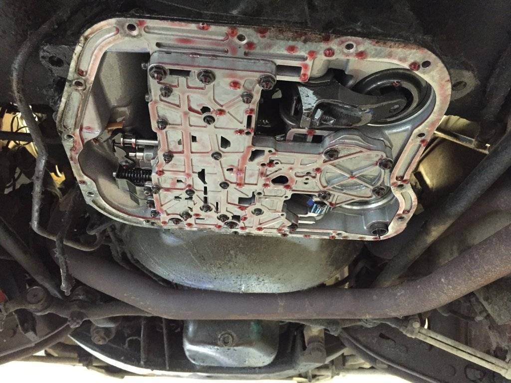

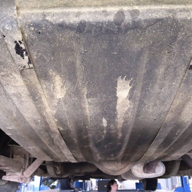

After 3 sets of plug wires and multiple hair pulling and chin scratching sessions Scorch is now running like a Champ! Tossed the NAPA and Echilin wires for some good ol Mopar originals still sitting on a Dealer`s shelf and she now purrs like a Lion. Wait what's this???? Red fluid all over the ground? WTF?
Thanks to the knowledge base here on the forum I quickly diagnosed the problem...Selector Shaft Seal Leak...Armed with my trusty seal replacement tool and my Shop Foreman Mike the seal and pan gasket were replaced in short order....except for the part where Mike dropped the ball bearing attached to the roostercomb down the drain.....we did use the A518 gasket with great results...Thanks Stan!

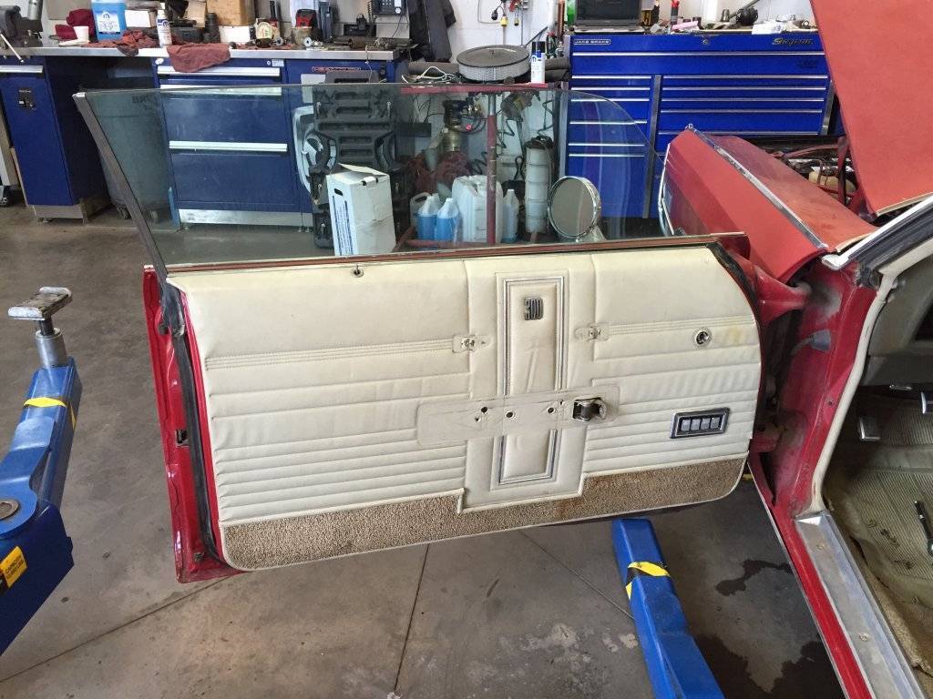

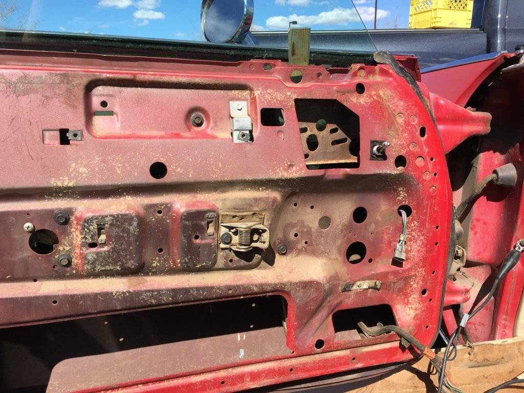

The Driver's side window was being held up with wooden wedges as the power window motor had failed. Using the information from this site we rebuilt the motors using the steel nut method. Worked great! Thanks again FCBO! (Stunt Double used during this operation)

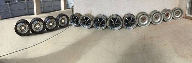

WHEEL AHOLIC......
During the last year I have been accused of being a wheel hoarder....it's true :)
I have acquired 3 sets of road wheels and several other miscellaneous Dodge wheels just in case...
I found a set of road wheels locally from a guy who tried fitting them on his 8 bolt B-Van :realcrazy:. He had fully restored them and put on new Hankook Optimas....the whole set for $400CDN

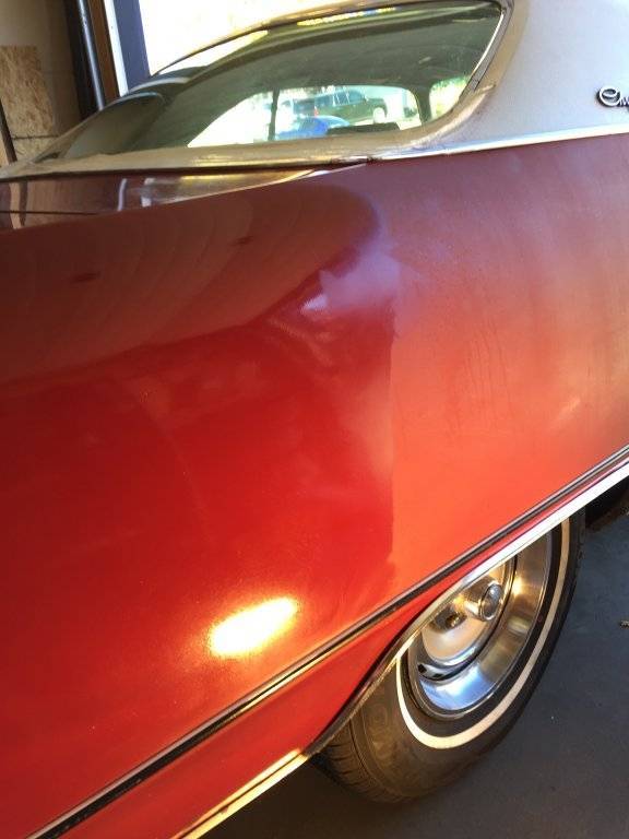

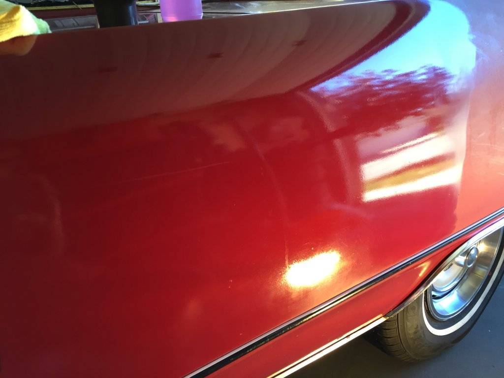

So after a very wet summer and very little free time I managed to start revitalizing Scorch's very oxidized paint. I was very concerned about how well it would come back but you be the judge. I have completed 2 stages out of 3 so far of polishing and about 30 hours of work. It is not perfect but certainly looks better.
Stage 1 - Claybar and decontaminate the existing finish
Stage 2 First Cut Polish
Completely Polished ready for Wax.......

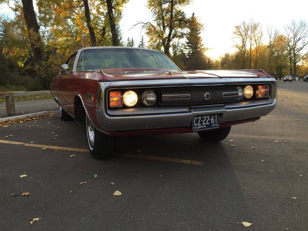

SEASON'S END...

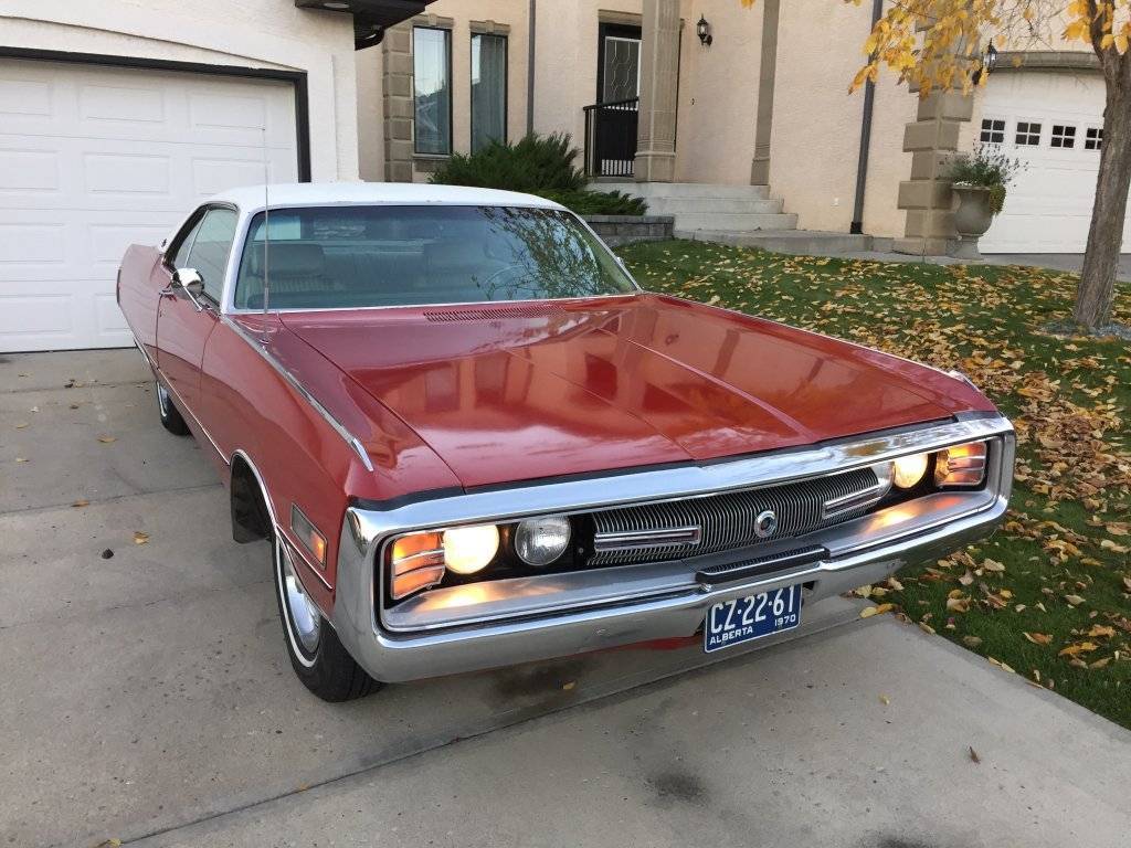

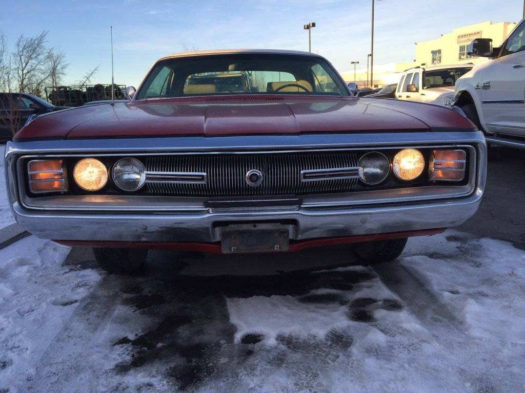

Well it's October 2016 and while a lot was accomplished on Scorch there is still much to be done as any project has. One of the last bit's of business was to replace the Headlight Door Motor. Critter generously supplied a spare from his SFGT build and even showed up to do the install! Gotta love Team FCBO

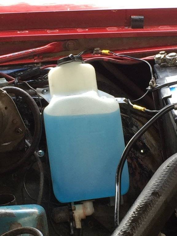

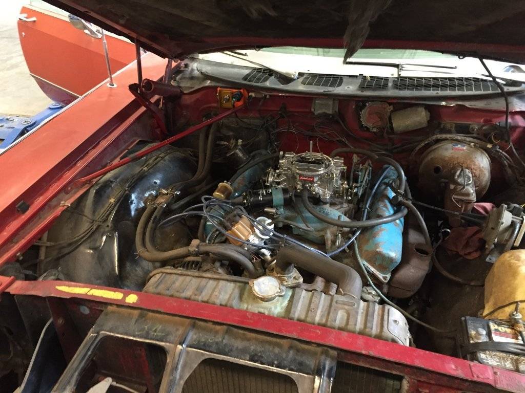

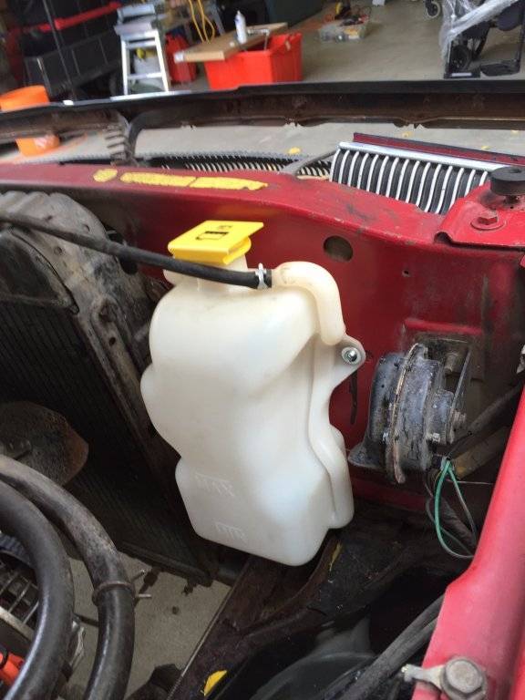

Installed a temporary washer bottle until a suitable replacement can be found. Came outta a 1981 Dodge D100
And a coolant recovery tank from the same D100
Starting to look OK under the hood....
Well that's about all I have for now. The story will continue in the Spring of 2017 in the meantime here are some miscellaneous pictures to enjoy of the journey so far. Thanks for reading and your comments. - Graham
