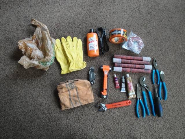

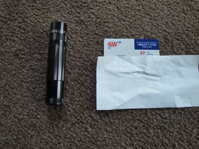

You've gotten great advice through this post. I made break-down kits for all four of my vehicles and here is the list. It could be more but I wanted to keep the size small enough to not be intrusive but small repairs could be made on the road to keep me going. I keep these kits in the vehicles all the time except to change batteries in the flashlight.
Shopping bag to put garbage in.
Leather gloves to work on hot items.
Hand cleaner
UV rated zip ties
Quality duct tape
Silicone rescue tape for emergency hose repair. Rescue Tape - The World's #1 Self-Fusing Silicone Tape
Shop rag.
fold able razor knife.
Emergency tool, mainly to help others in an accident.
Locktite threadlocker.
Permatex Form-a-gasket.
Pliers, crescent wrench, and six way screwdriver.
Small tactical flashlight that you can hold in your mouth. (WITH FRESH BATTERIES)
As someone else said, AAA card.
Some additional things that I would ad for trips would be:
Quality socket set.
Boots.
Old clothes to work in if possible.
Rain gear.
50/50 pre-mixed antifreeze.
Oil.
Trans fluid
PS fluid.

Thank you, Shooter for that exhaustive list of stuff.
