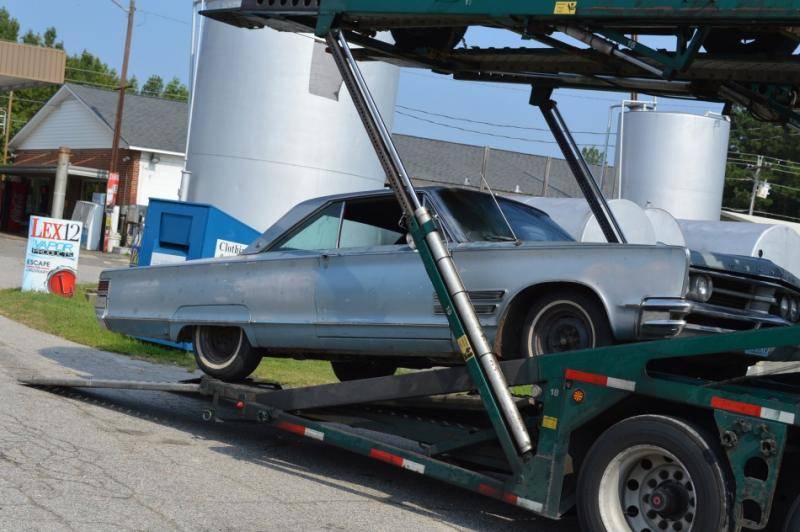

Bought this car sight-unseen from a Craigslist ad in Sedro-Woolley, WA back in July. Had seen the car a few times while searching but dismissed it since it was out on the left coast and I'm on the right. When the seller dropped the price by a grand it became feasible to ship it within my project budget.
Shipping ended up being quite an adventure and taking over a month as I stumbled through the learning process. Ended up going directly with a trucking company named Coast-to-Coast Auto Transport for a reasonable price and with excellent service.

Here are a shot that I don't think has been posted in the other threads. Because we all love pictures!

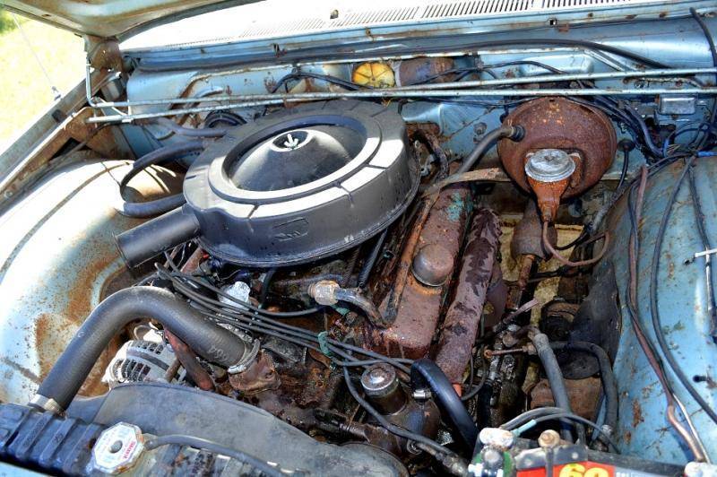

So a quick assessment showed numerous issues needing attention beyond the mentioned cracked windshield, leaky heater core, non-working fuel gauge and radio. For starters, the car didn't want to run for any length of time. When it did run for more than a few seconds it ran very rough. Also the ammeter is the only item working in the gauge cluster. Nothing else, no oil pressure light, temp lights, high/low beam, not even the illumination. Console lighting is also not working,
Biggest issue up front was a hood hinge off its pin and with the torsion bar popped out. Seller did mention this but I had no idea what was involved. After the hood nearly took my head off while checking out the engine bay with a prop under it, I decided that was the first project.
Here's a link to that thread:
http://www.forcbodiesonly.com/mopar...opeye-Help-Needed-with-Hood-Hinge-Torsion-Bar
Though I was sure it would be a 5-10 person job to wrangle the huge hood around and get the torsion bar back into place, I managed to get it done by myself. A good confidence builder and the first positive step since the car arrived.

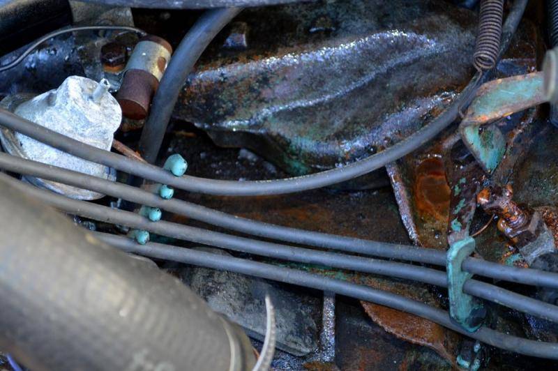

Once the hood hinge was repaired and it was safe to get back underneath, I started digging around the engine bay to see what was going on. The heater hoses had been disconnected from the engine but not removed, leaving them free to flop around under the hood, hang down underneath, lay on hot manifolds, etc. Knowing that the box needs to be removed from under the dash anyway, it made sense to take the hoses off and get them out of the way. No small feat, I might add. Ended up making small cuts in the connected ends to get them free, and then it was still all I could go to get them free. A/C hoses are also flopping around, they're next.
The biggest problem was keeping the car running for more than a few seconds. Though we were able to transport it two miles from where it was unloaded to my driveway, it wasn't without problems like the car running out of gas when we made a sharp right turn. After that it ran rough but got here.
Decided to take a look at the carb and fuel set up. Immediately discovered the vacuum advance had been disconnected. Upon removing the the air cleaner another discovery was made: the carb had been changed. Been sorting it out in the Engine section with a great discussion about different types of vacuum. Rather than repeat it all, here's the link to that thread:
http://www.forcbodiesonly.com/mopar...Course-Please-Vacuum-Advance-Line-Bolcked-Off
Got a little time to work on it last Saturday. Started by swapping out the suspicious fuel filter. It was a huge mess and appears to have been the main culprit that was keeping the engine from running well or at all.

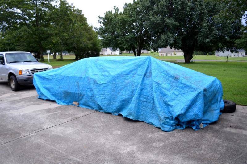

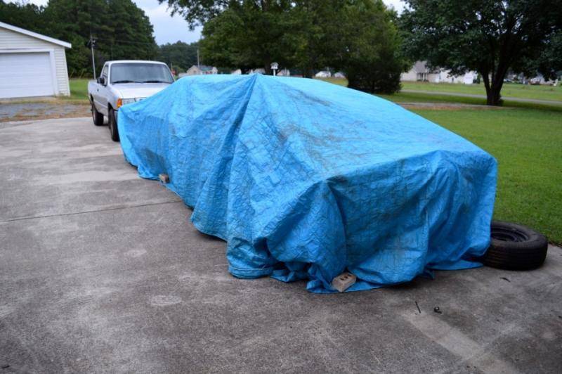

Meanwhile the 300 sits in the driveway beneath a blue tarp since it appears to have a leak or two. Rear floor behind the driver's seat had water under the rug every time it rained. Suspecting the rear window gasket since the side window area was always dry.
Here's a couple shots of it all tarpped up. Looks like a blue aircraft carrier in the yard. You don't realize how long these cars are or how low until you take away the features by covering them up.

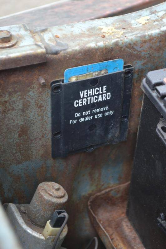

Been researching the CertiCard owner. A plausible history is emerging to explain the neglect, based almost entirely on speculation. Getting info from the seller is like pulling teeth.
A plausible history is emerging... based almost entirely on speculation
:laughing4:
If you think about it, that is really funny.
Plausible based on speculation...:poke:

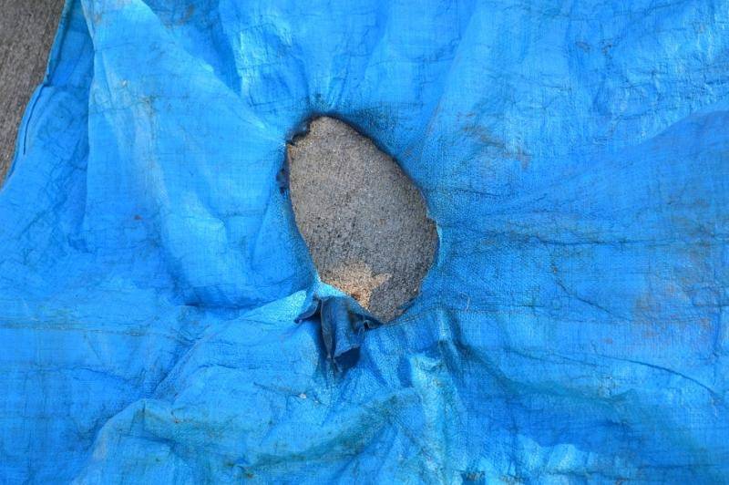

Note to self: before starting a big car with a big, hot motor, remove blue tarp *entirely* from car. That exhaust pipe apparently gets a lot hotter than you'd think.

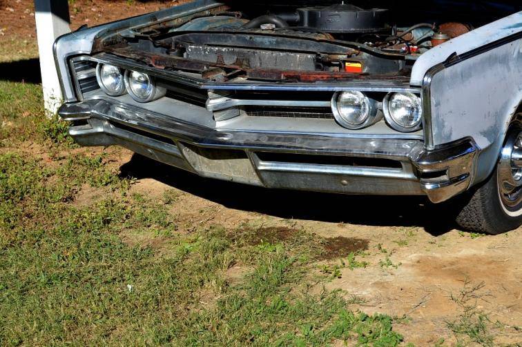

After the dealing with the blue tarp and moving all the hold down implements (bricks and a couple spare tires) from the driveway, I decided to move the Shark over under the carport to remove the need for covering it to keep it dry. Drove out across the lawn, into the carport, and was suddenly overcome with the crazy desire to take the old girl out for a drive. After all, it was now legally registered and I'd put a couple more gallons into the tank so I figured it was safe for a few miles. Put the air cleaner back on, closed the hood, fastened the mega-seat belt, eased console shifter into 'D' and headed down the drive.
Went a couple miles down the road to a new school and turned around in their lot. Headed back to my road but feeling bold, decided to head down the looooong straightaway and get up to speed. Made it to 60-65 somewhere, felt an occasional 'skip' but otherwise it went well except for the stopping part. Forgot that the brakes still need bleeding from the new calipers the PO installed. Those T intersections will wake you up fast.
Cruised back home and under the carport. Popped the hood to check the radiator bulkhead and surrounding areas as it had gotten quite hot previously. Cool as a cucumber, nice.
Then I got stupid. Figured since I'd been cranking the engine more than running it lately, I'd let it idle for a few minutes while I did some other things, just to charge the battery. *BZZT* wrong answer. I was around the corner in the yard when I noticed the car sounded like it wasn't running. Came around the corner to discover coolant pissing out the bottom in a few places. A quick check showed the overflow hose was doing its job. However, the car sits at a slight sideways angle and there was coolant leaking higher up the bulkhead.

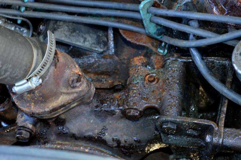

Peering down between the condenser and radiator I saw it: a nice stream squirting out on the left side, a couple inches above the lower tank. Great. Something else to fix.
Not sure if the radiator is plugged somewhere or there are other issues. Did notice that the clutch fan is AWOL and has been replaced with a standard 4 blade fan. Looks small inside the shroud. So I'm wondering it the smaller fan along with the AC condenser in front are to blame for the overheating. Surely my lapse of judgement in leaving the car unattended had nothing to do with it.
At this point it looks like the radiator will come out next to be checked and repaired. Need to replace the heater hose bypass kludge while I'm at it. At least I got the AC hose off that was clunking around under there.
