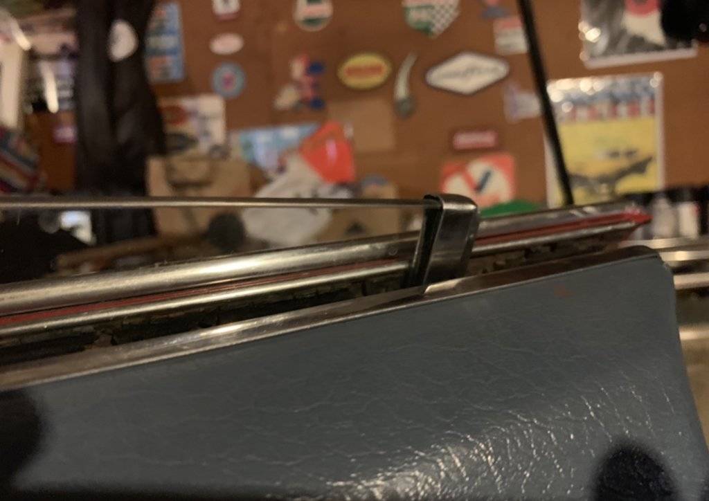

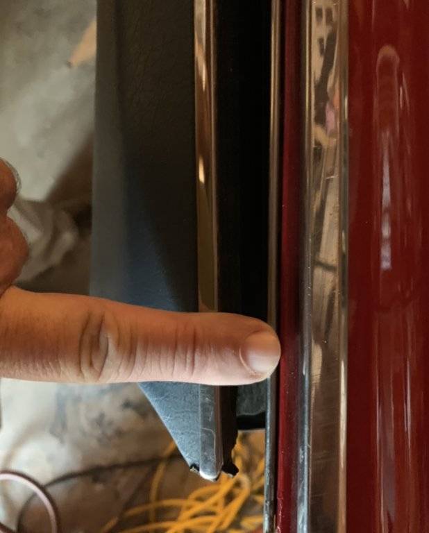

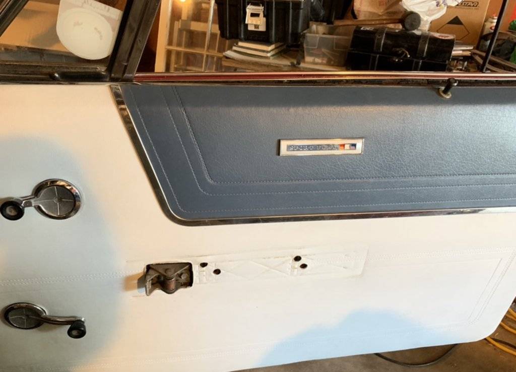

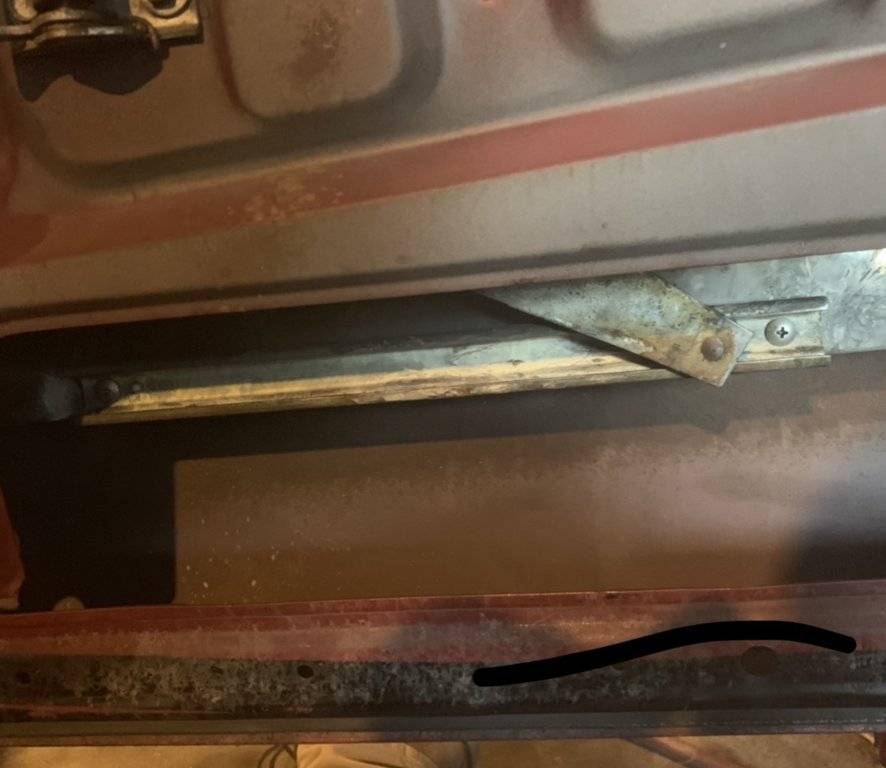

Pass side window on my ‘69 convertible fell off the track and will not roll up or down. I thought it was the missing door gasket thingy (can’t remember what it’s called even though you guys figured it out for me) pinching the glass. But same gap taper on drivers side so I should do some troubleshooting after I do the repair. There you go perfectly backwards.

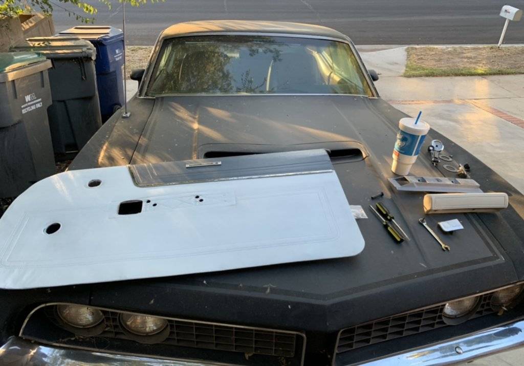

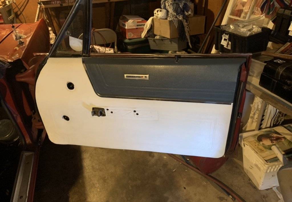

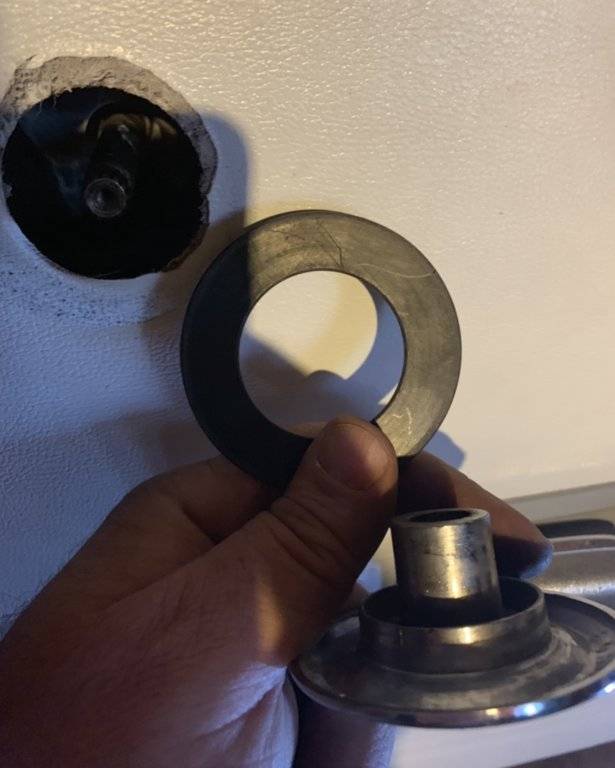

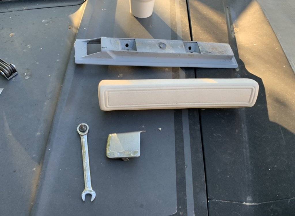

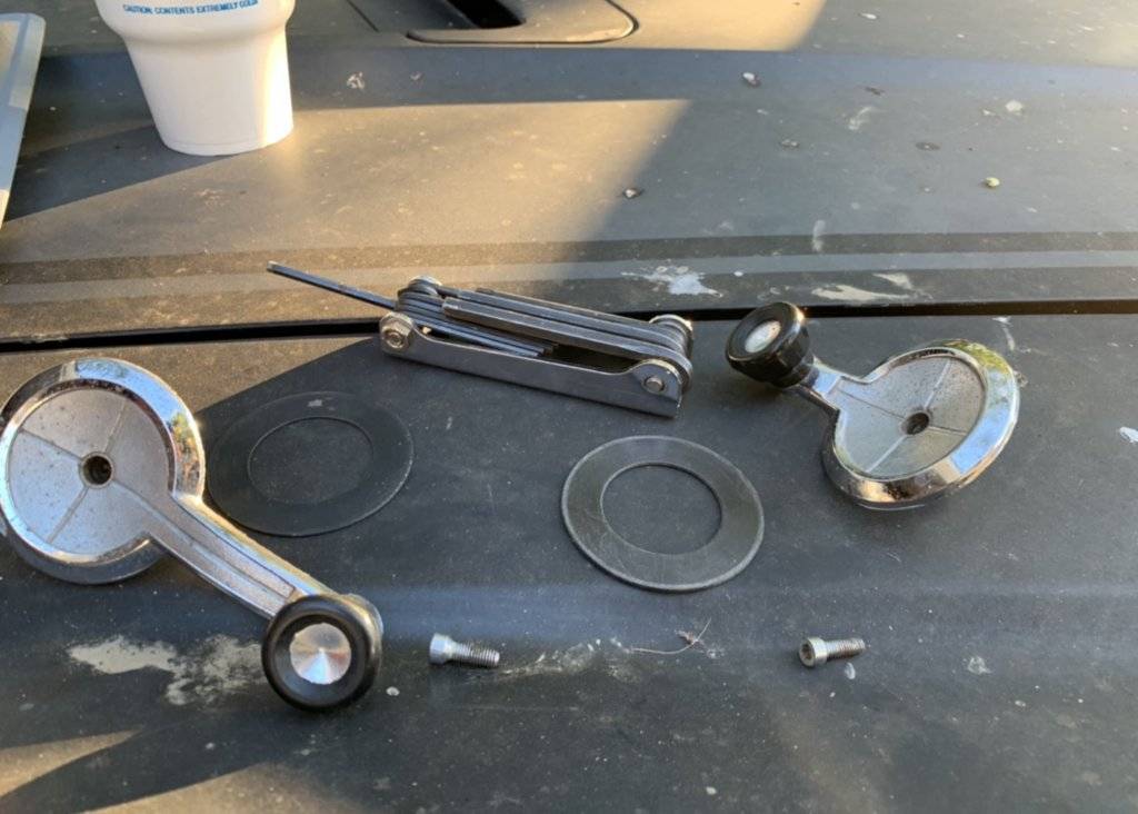

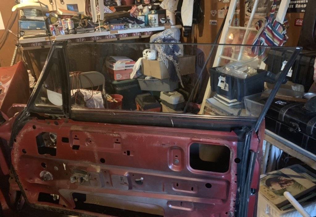

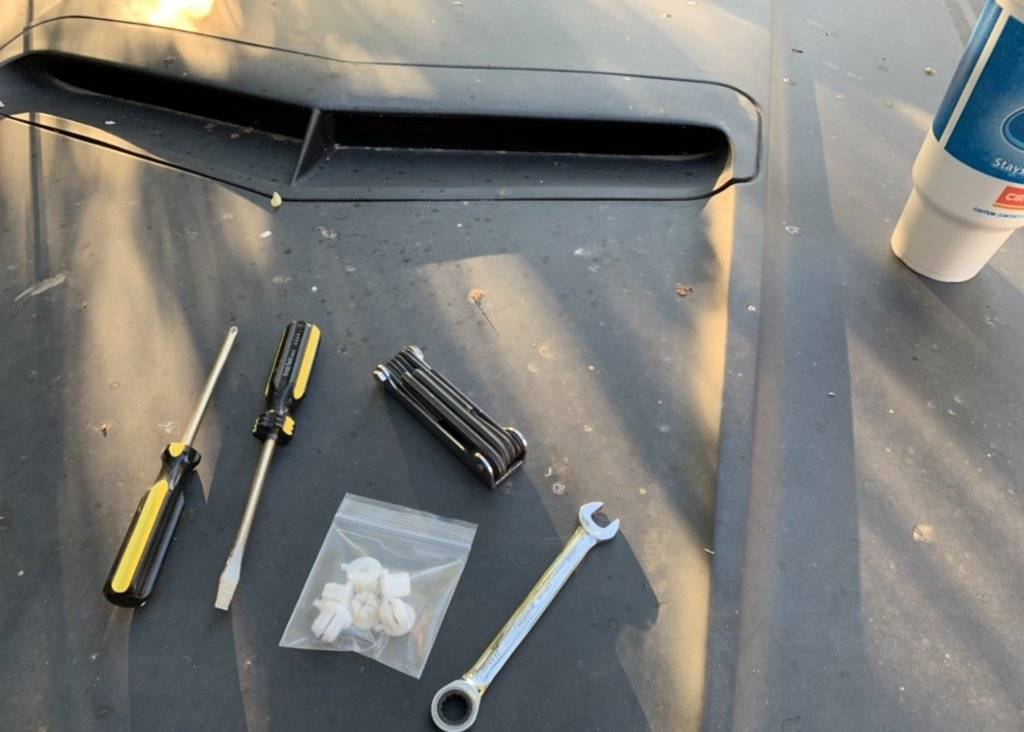

Ok here we go. The job can be done with basic hand tools. Lay everything out on your work table and don’t lose any fasteners Ace doesn’t have replacements.

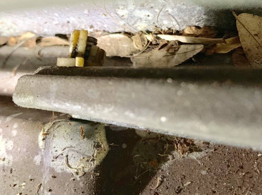

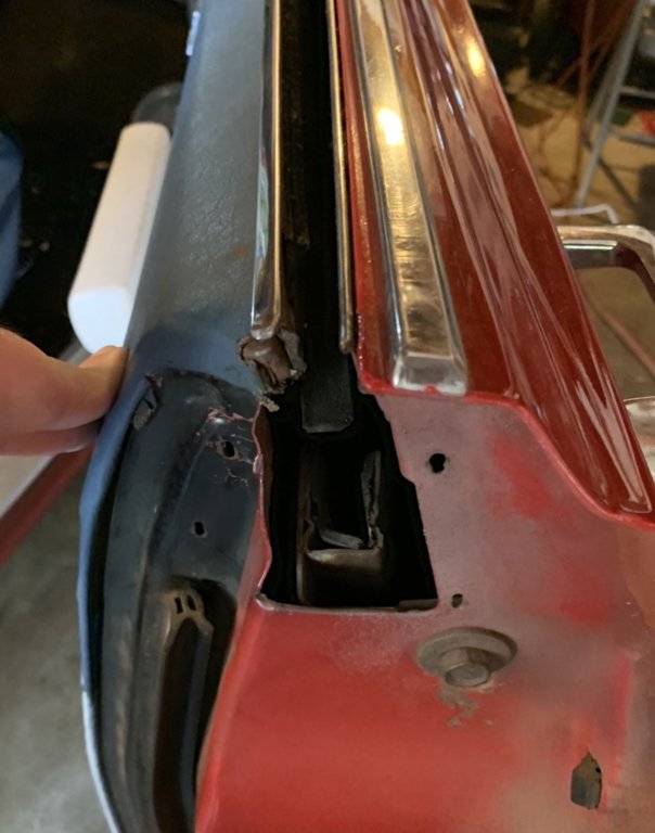

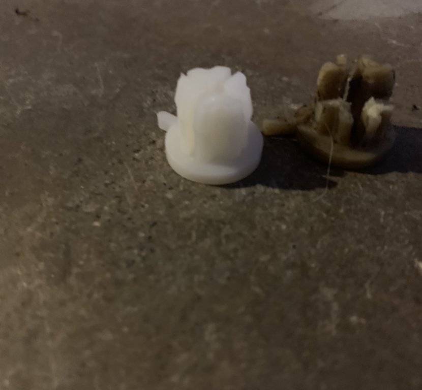

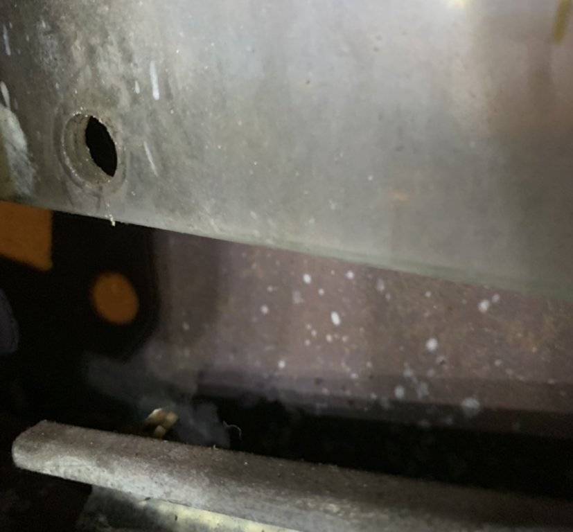

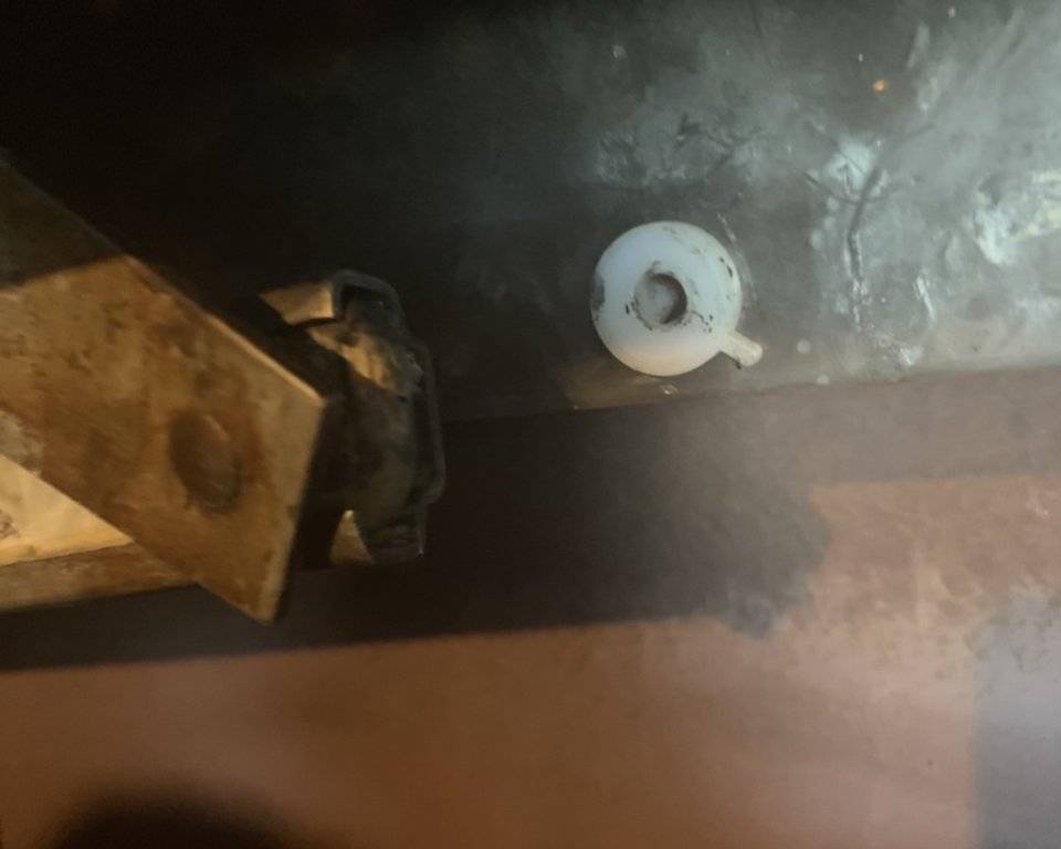

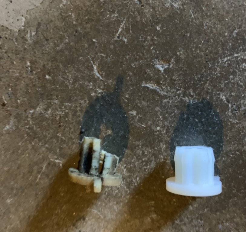

Now time to survey the damage. The glass rivets are plastic and old. This equals brittleness and it’s actually a good thing. I’d rather lose a rivet than break the glass...

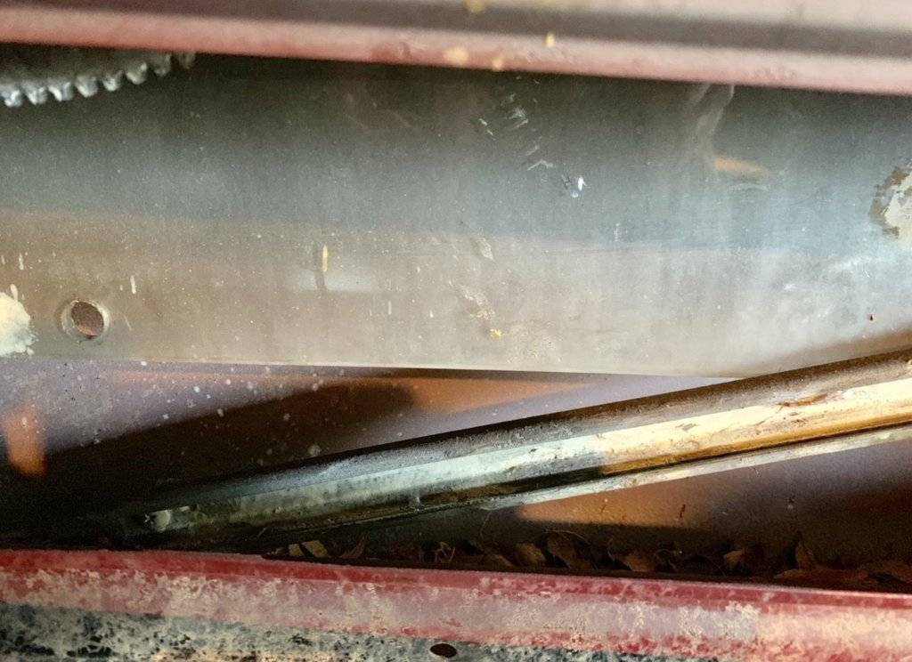

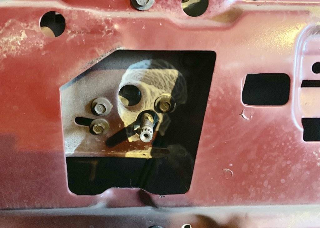

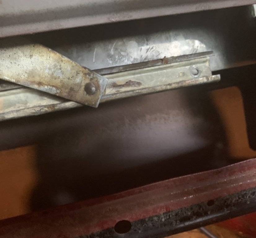

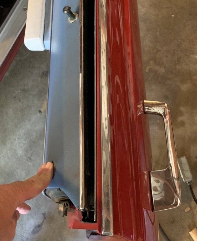

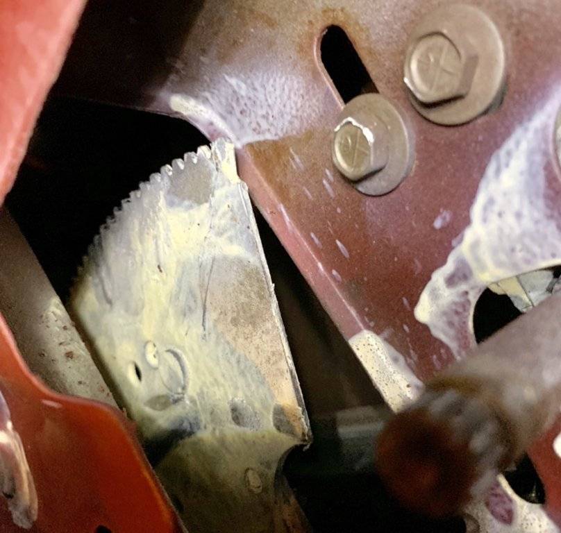

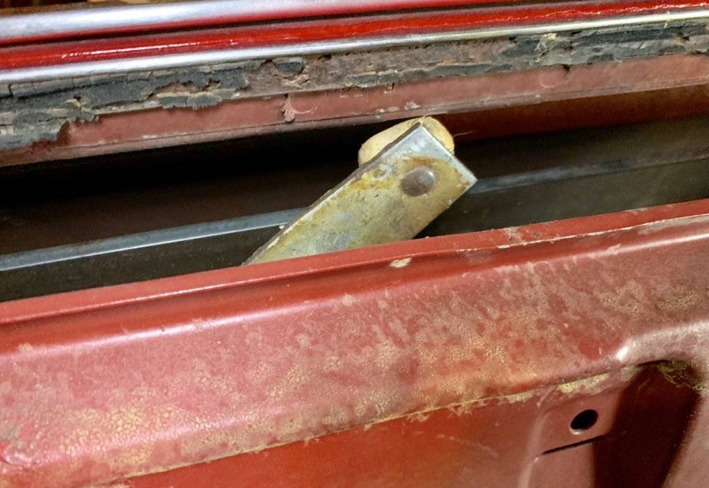

The arm had swung all the way up as a helper turned the crank while it was off the track. It’s like wet paint - - - why do they have to touch it. Anyways they set the arm off it’s gear by cranking it while it was disconnected. No harm no foul just feed it back onto the gear. Once done it’s a good time to lube everything. I use spray chain lube because it sticks pretty well.

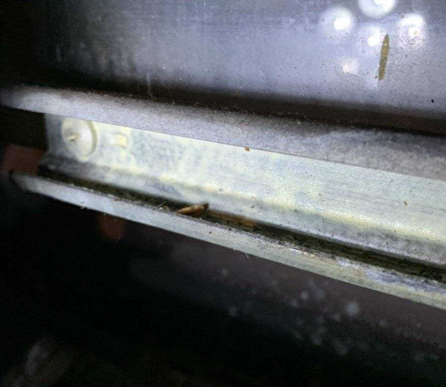

Feed the arm slider block onto the rail.
Then pop in new rivets and screw the rail back on to the glass. Not too hard just nice and snug like a factory line worker would do it.

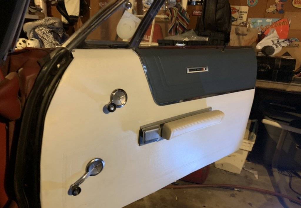

Now throw everything back on in reverse order and you’re good.

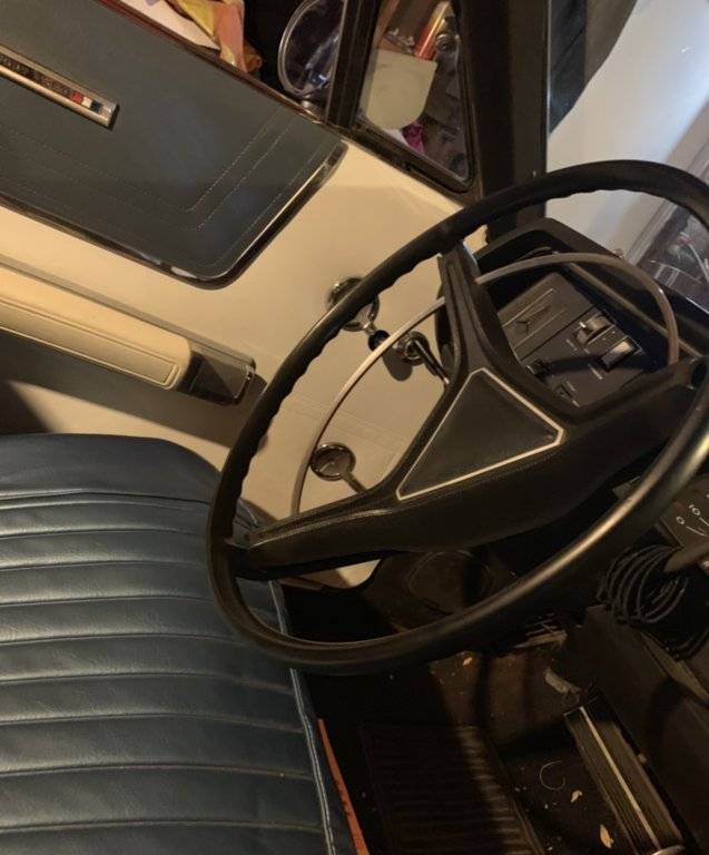

Make sure and look at the other side and clock your cranks people. This is what separates us from the animals...

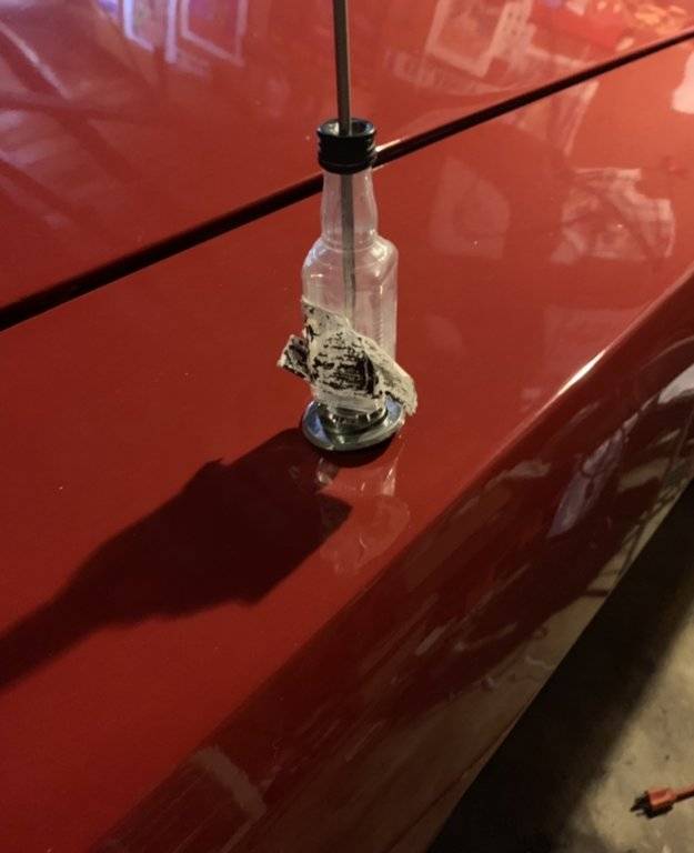

It’s time to replace my neat little antenna topper.
I liked the old one so I purchased the same type. It’s a solid choice.

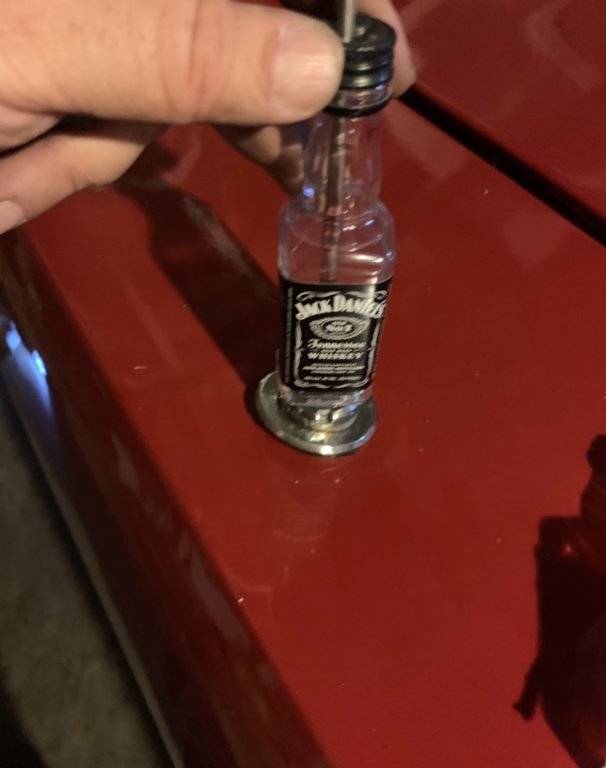

Locate the factory pilot hole.

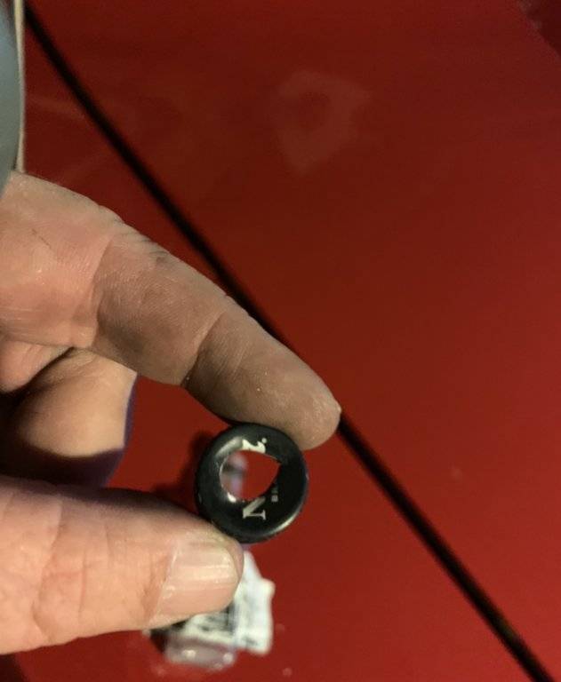

Use proper tooling to bore a precision hole.

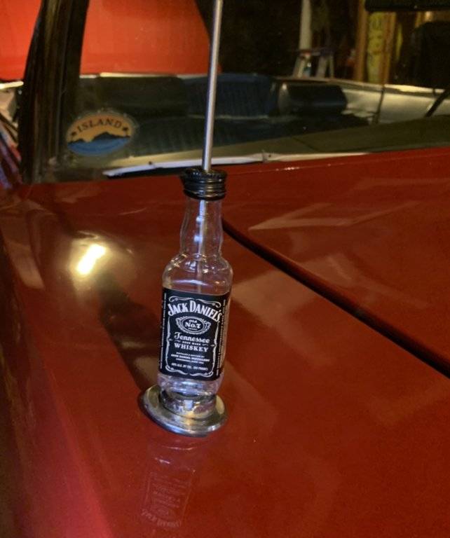

Reuse the old cap out of laziness and call it a night !!!!

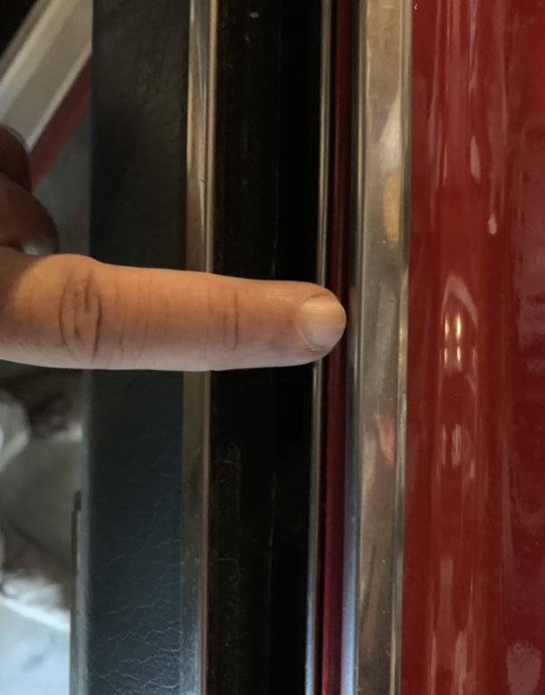

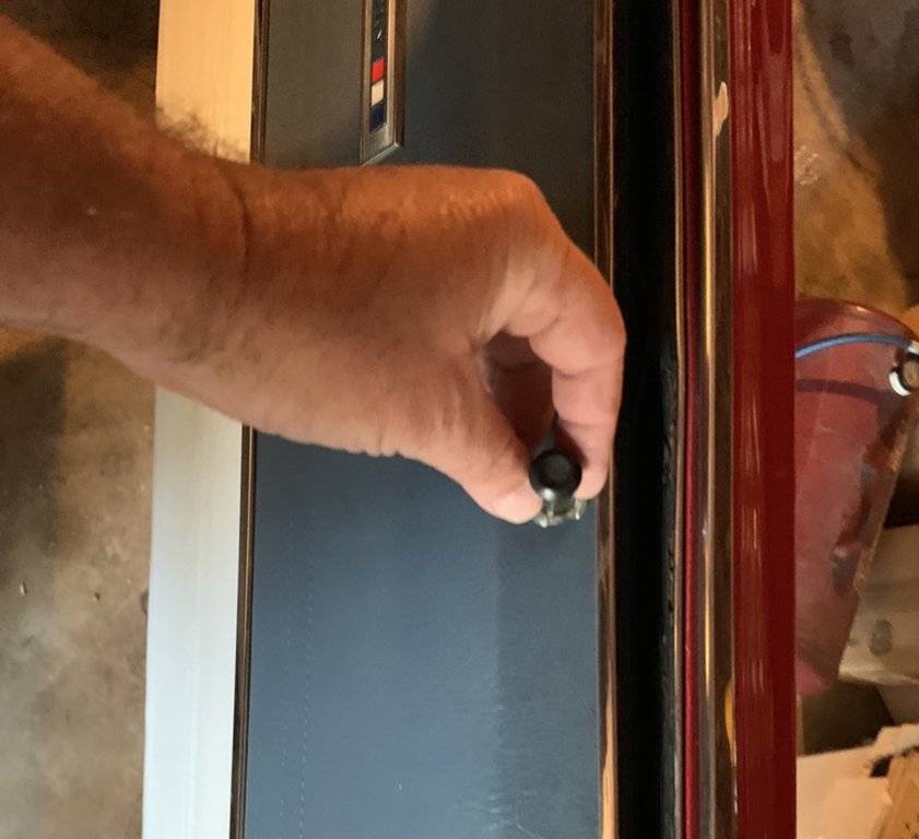

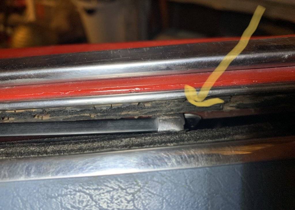

I did troubleshoot the problem. The whiskers pretty much roached and it’s keeping the glass from rolling up smoothly. The rivets did their job and failed rather than breaking the glass. I’m not fixing it for now as if you pull the glass towards you a bit it rolls up perfectly fine. I’ll add it to the driving list. You all know what I mean. That list of things one must do if your gonna drive my car.
The real fix will be a new set of whiskers the door jamb thingy was a red herring.
