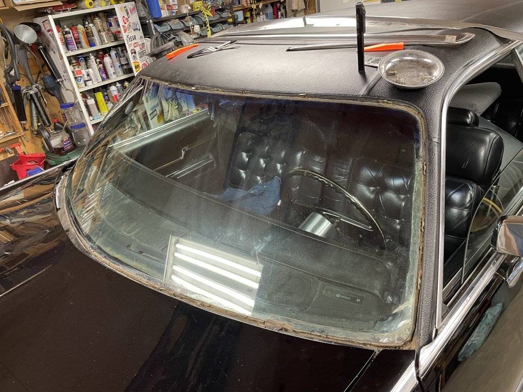

I have been working on TB, my 1973 Imperial. I am working on the loose windshield. I have been taking it very slow and patiently, removing trim and getting the glass to slowly unseal the last few inches.
I was so close I tell ya, close. Then pop goes the crack. Uugghhh!!!
Sorry but I need a windshield.

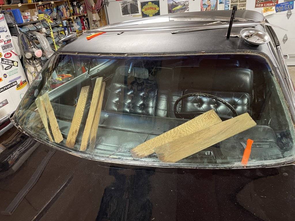

I set the windshield up on on of my shelves wrapped in moving blanket and supported the curves with 4x4's while we did the headliner and roll cage in my Challenger. I went to uncover it and it was cracked from top to bottom just sitting on the shelf. I understand your disappointment.
As soon as that first one inch crack pops, you then get the smack in the head of "WTF. What were you thinking? Why did you do that? "
I then saw my fault of going at it from both sides.
It was going well, but slow. The upper two thirds were compleatly unsealed, and when I lightly pushed with the shim it would release farther along. I continued this slowly around through the lower half. I sprayed deep creep along bottom to help with the shims, as it lubed and showed me where seal was free.
4" remained.
I then left it for three hours to seep and with light pressure on on glass with shims. I should have removed the right side of shims before I applied more pressure to left side shim. It did not take much but It was plenty enough to pop.
Dumb ***.

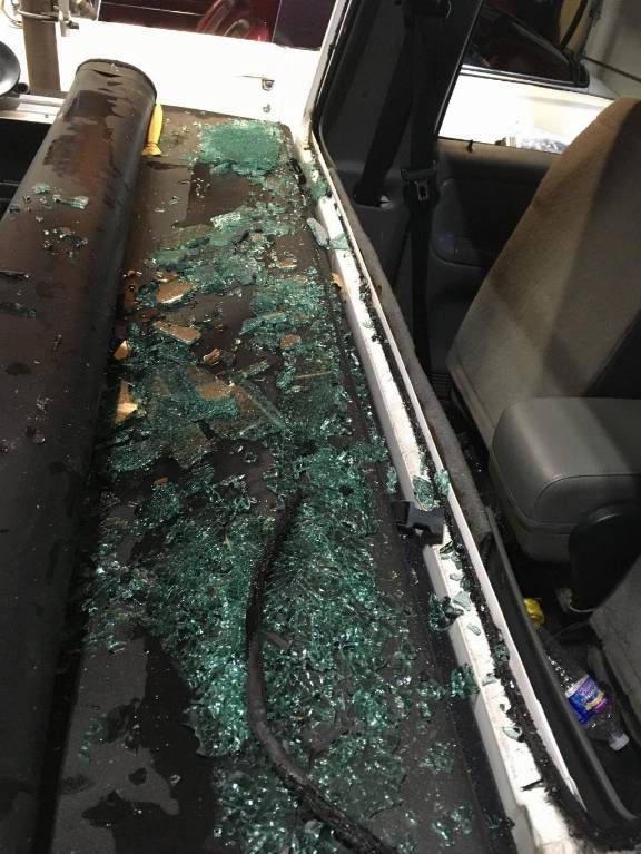

The side and rear windows are tempered glass. One layer of heat treated glass that breaks into small, non lethal pieces when it shatters. The pic I posted is the rear window of my 2010 Ranger and that's a good example of broken tempered glass.
