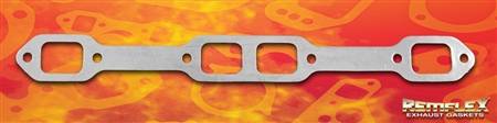

Any idea how these exhaust gaskets are from 2 Bolt?
Home > Manifold / Header Gaskets > Mopar (Chrysler, Dodge, Eagle, Plymouth) > V8 >
PN 6002 -- Mopar 361ci ('57-'67), 383ci ('59-'71)(Jensen '70-'71), 400ci ('72-'80), 413ci ('59-'65), 426ci Wedge ('63-'65), 440ci ('66-'80)(Jensen '72-'76) 2/set
MSRP $47.29
They look pretty thick and maybe work well for my HP exhaust manifolds?
The company's name is Remflex, that was just a specific link. I've used the head to manifold gaskets twice, on a 360 and a 440. Both time's I only used one due to noticable exhaust leaks and broken studs and not wanting to remove the head. I can't say enough good things about them. No complaints whatsoever, they smell a bit initially, it goes away though. They are thick, but crush down a bit, or alot. With what you're doing, I'd consider the thinner, harder one's that have the tab that sticks up and supposedly helps protect spark plug wires. They're made specifically for the HP manifolds. Sorry, I don't have a link. I do know that welderguy runs them!

With respect to the posted link, how do we know the compressed thickness of the gaskets pictured? Just curious.

Yep, both time's I used the head to manifold gasket the manifold had a slight bow to it. With the middle being high, and the outer ports touching the head. Throw a broken stud or two in the mix and you've got an exhaust leak. Like mr. fix it, I also try to flatten out the manifold as best as possible, a belt sander is your friend in this instance.
As for the compressed thickness, they start at about a quarter inch thick, and I don't think you would want to compress them to more than an eighth of an inch. They would start to flake. I still have two in their packages, I'll see if there is more information from the manufacturer.
