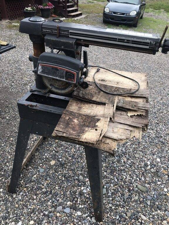

    I picked up an old Craftsman radial arm saw for free a while back, had been left out in the elements for a number of years.

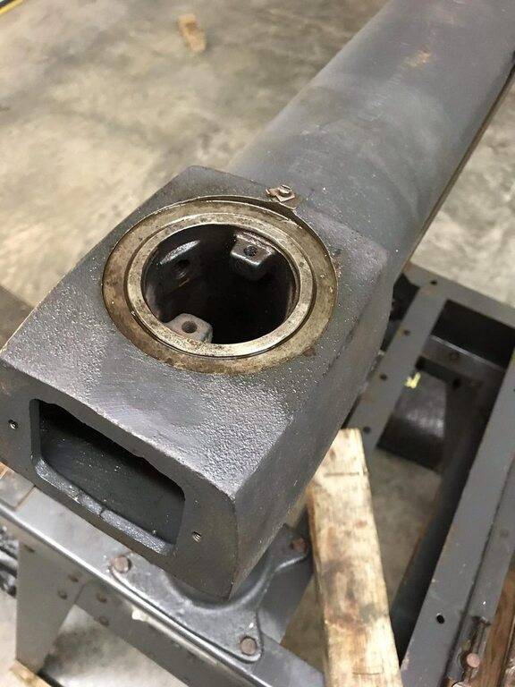

    I have been working on getting everything cleaned up and working as it should and have only one area I can not get working again. It's the arms left and right movement that is seized solid. I have heat cycled it a dozen times or more with torch or heat gun then soak in PB Blaster, Tranny fluid, and other penetrating fluids, used brass hammer and punches to smack around the offending area, run it twice now through an electrolysis bath for several days but no luck.
    As it currently sits...

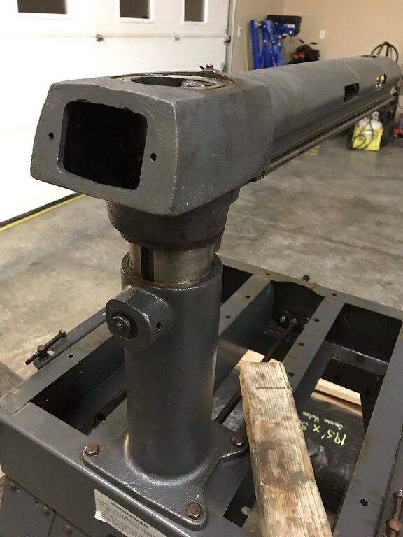

    Yes the locking mechanism is completely out, all the parts and pieces too and that is going to be a PITA to re-assemble. :( As mentioned I have heat cycled that area a dozen times or more with the torch but it just won't let go, I think the tolerances are so tight between those two parts that the little bit of rust that has formed between the two has essentially welded them together.
    If I had a press out in the shop I would try that but can't figure out how to make a back yard press that won't ruin the assembly.

    if you can keep the base solid, put pressure on the arm with a ratchet strap while soaking 2-3 times a day with pb blaster. try to give the strap another click each day. once it moves a little , put the strap on the other side and repeat. i freed up my drill press that way. i wouldn't recommend using a press. you'll likely break the casting.

    That is a great idea...had been trying to think of a way to put pressure on the arm in one direction or another, seems obvious now that you mentioned it...:) :thumbsup:
    Just have to come up with some way to secure it, probably put the forks on my skid steer and fasten the saw to a HD pallet, then use the ratchet strap tied to the skid steer as an anchor point.
