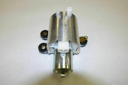

You can pay enormously overinflated prices for Mopar original or reproduction pumps, or buy one from the Mustang parts vendors for WAY less, and swap out your Mopar stamped bottom plate.

The other difference is the brass grounding strap is in a different location. Who will notice? I don't think ANYBODY would notice either that, OR the nylon connector surround...

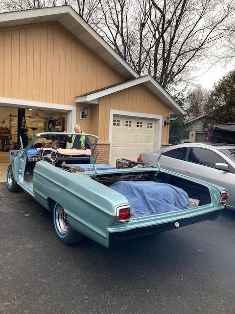

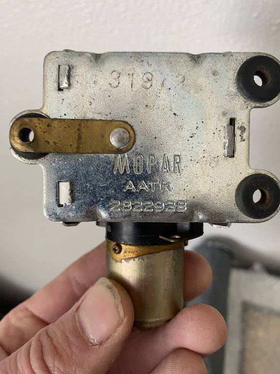

Turns out I have 3 of them. I wasn't sure what it was at first.
I'll need 1 for my Drop Top Fury I'm restoring.
I'll power them all up tonight to see what works.
my part numbers are.
two of the 2496152 numbers
one of the 2822928 number
Pick of my 66 Sport Fury

2 out of 3 washer pumps worked.
I'd like to keep the 2822928 for my car.
I still offer the 2496152 washer pump.
Is your electrical connection horizontal or vertical to the motor shaft?
mine is horizontal. 2822928

It’s horizontal. Thanks for checking, I’ll have to order from CJ Ponies.
