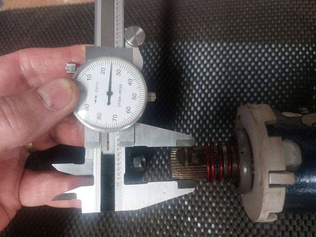

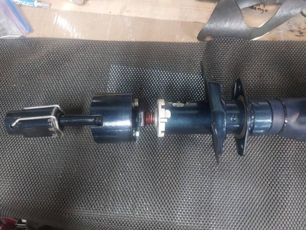

What is the size of spline on the rag joint. I need to remove the rag joint for space consideration. Hitting the flange of the hi po manifold. Would like to buy a borgeson coupler. Or something like it rather than just cutting up a perfectly good rag joint.
Mine specs out at .720" ???
Is that considered 3/4"

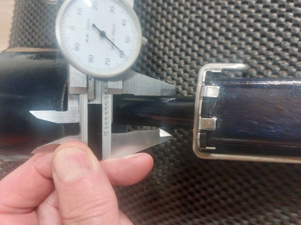

The shaft itself is right on .750
My previous column did not have a rag joint in it. I didn't think to test fit this before I rebuilt the new column.
Anyone ever have to do this?
I would call that 3/4" diameter, and if you count the splines, i believe you will come out at a 36 count.
