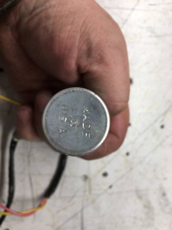

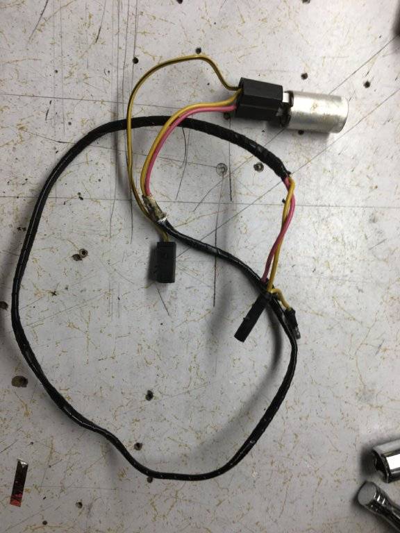

It isn't really a relay. It's a little round silver thing less than an inch in diameter and about 1 1/2 inch long. It gets a ground from the driver side door jamb switch that makes one of those 'bi-metalic' strips get hot and supply power to the key light. When it cools off (after door closes-removes ground), it is supposed to disconnect. Yours is probably stuck or the wire from the door jamb switch is shorted to ground. It is generally supposed to give you a 15-25 second 'delay' (light stays on for that amount of time-delaying turn off).
Here is what they look like I have a couple in a drawer. On my 69 fury it was to the left of my speedo taped to some other interior light wires . It was a pain to get at. Had to go in from beside steering column and straight up As far as I could reach . Napa sells them as well
