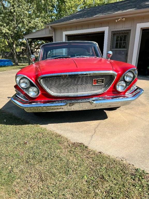

Had my 62 Newport 361 engine rebuilt stock and upgraded to 500 cfm 4bbl Edelbrock carb. After the first 100 break in miles I started noticing hesitation and sputtering above 55mph. Runs strong and no issue until highway speeds. Initial timing set at 10 btdc. Can't seem to find a vacuum leak. I have the distributer vacuum advance attached to passenger side carb port. Any help on this one appreciated.
Yoop
