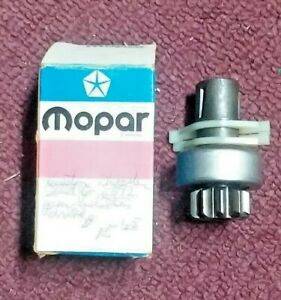

Could be loose starter bolts.
It's probably a broken starter drive.
In my experiences, they break when the engine "kicks" or backfires when starting.
the motor still cranks but Elijah (my brother) and I think the starter isn’t staying engaged long enough to fire over the motor. It cranks then whirs. Cranks then whir. If it was a broken starter drive, would it still crank or just go directly to whir or whatever noise it makes
