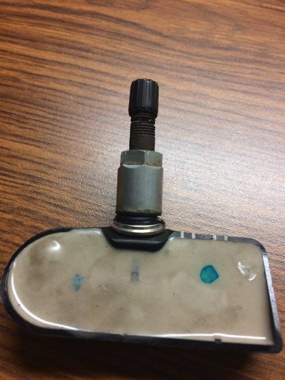

Long story short....my wife's mini-van (2008 Chrysler Town and Country) needed a tire stem replaced. The threaded part was broken and since we are taking a 900 mile trip to Florida tomorrow I thought it best to get it replaced. (See pic of old stem).

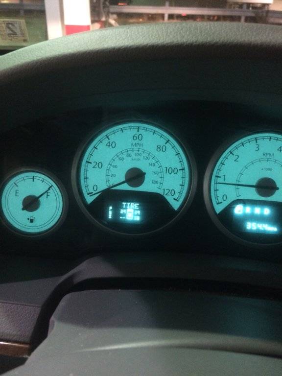

Well I drove over 700 miles to Florida and it didn’t correct itself. According to the manual the module will pick up the sensors after a period of continuous driving. That didn’t happen. Now the one in question just shows a dash as if it doesn’t even see a sensor.
If these sensors have to be told which wheel they are at then my theory is that the system is picking up all the old sensors but not the new one. Even though the tires were rotated and the old sensors are now in new positions the computer thinks they are still at the old positions. Hence it can’t find the sensor at the left rear tire since it was removed.
Thanks for all the replies. Driving with the warning constantly on is annoying but I will have to live with it while on this trip. When I get home I will dig into this deeper and see what can be done. At the least I will try and get a better explanation from the mechanic who did the work since all I understood through his broken English was that I needed to replace the other three.
View attachment 193385 Well I drove over 700 miles to Florida and it didn’t correct itself. According to the manual the module will pick up the sensors after a period of continuous driving. That didn’t happen. Now the one in question just shows a dash as if it doesn’t even see a sensor.

Did you go into the routine "Reset Sensors" or just desire the vehicle to reset itself?
CBODY67
I think the aftermarket TPMS they installed is incompatible with your Van. What is happening is the the TPM is seeing only 3 sensors so its assuming the 4th is not present or defective as it knows you have 4 wheels. OEM is likely the only fix or 3 other aftermarket TPMS then the scantool to register them with the TPM. Your local Dodge Dealer should be able to solve the problem in short order.
If it can't recognize a sensor, it will put "- -" for that wheel position. It will only recognize what it's programmed to recognize.
CBODY67

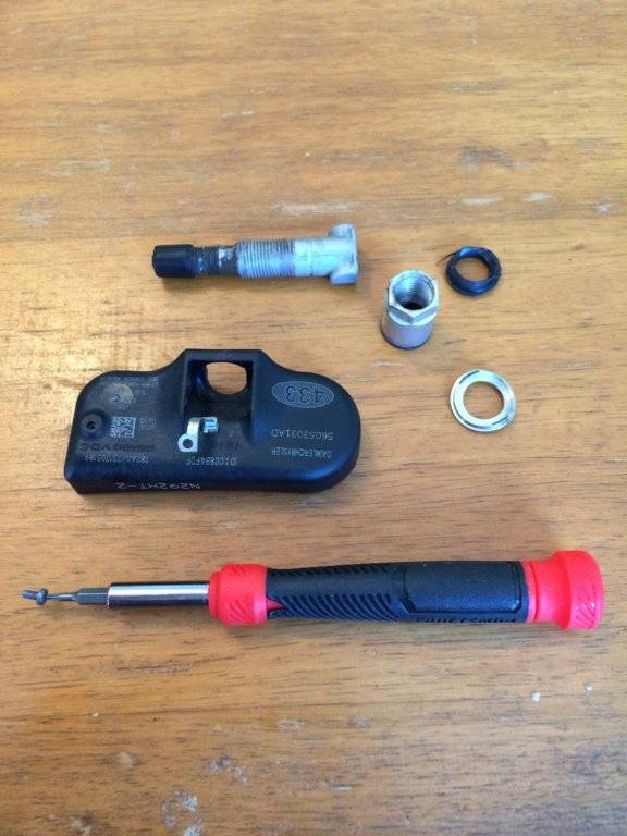

Just want to let everyone know I finally got this situation resolved. Fairly inexpensively too...

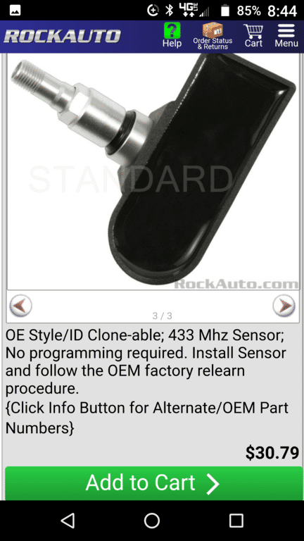

I figured that the sensor the shop put in with the new valve stem was not matching up with the other sensors. So I went online to try and find the OEM sensor but instead found that I could replace just the valve stem itself. Cost was $10.95
https://www.amazon.com/gp/product/B00WGRJ8AI/ref=ppx_yo_dt_b_asin_title_o01__o00_s00?ie=UTF8&psc=1
Removal requires a small torx screwdriver and possibly - reading glasses.
Finding someone to remount the sensor was a bit of a hassle since the closest place to me wouldn't do it. They claimed they couldn't work on customer provided parts - ???
So I then went to NTB and they did it for $35.
Sure enough the sensor that was removed was a 315MHz unit and not a 433MHz like the OEM ones. That was the problem all along.
Now my wife can drive the van without the annoying TPMS warnings.
