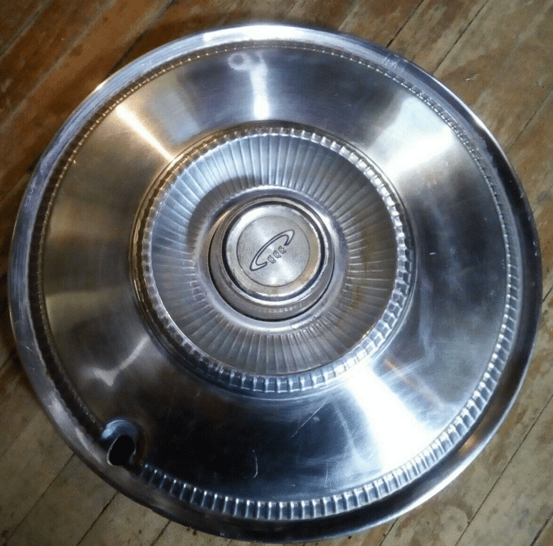

Hubcaps are out there.
These hub caps in 15 inch are made of this metal often known as "unobtainable"
Not so much worried about biting the bullet as I am about keeping the original hub caps on the car. And I don't think they ever made them in a 15 inch
The only 15" wheelcover for your year are the classic Disc Brake ones with the red centres.
Your originals were only ever 14". To keep them you have to have custom 15" wheels made with a rim ring to allow 14" wheelcovers.

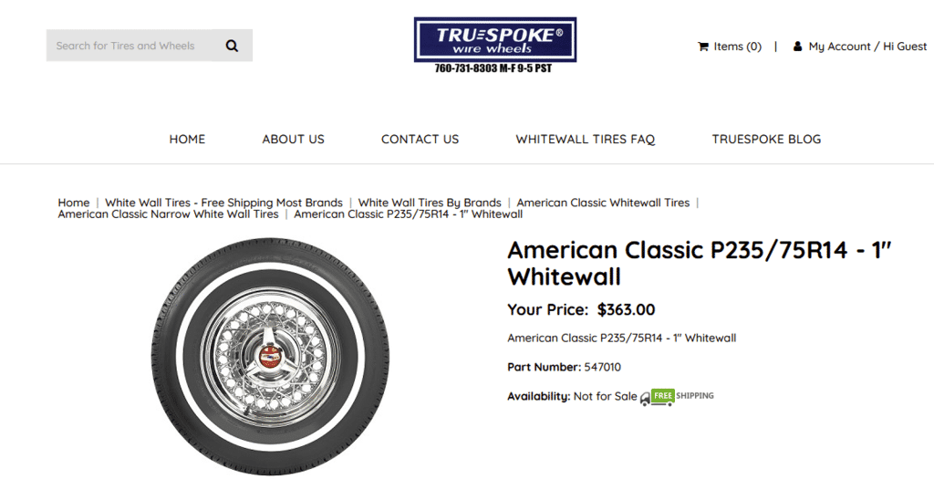

In terms of 14" tires with a narrow white wall, you're pretty much relegated to places that sell reproductions like Coker Tire. Be prepared to pay.

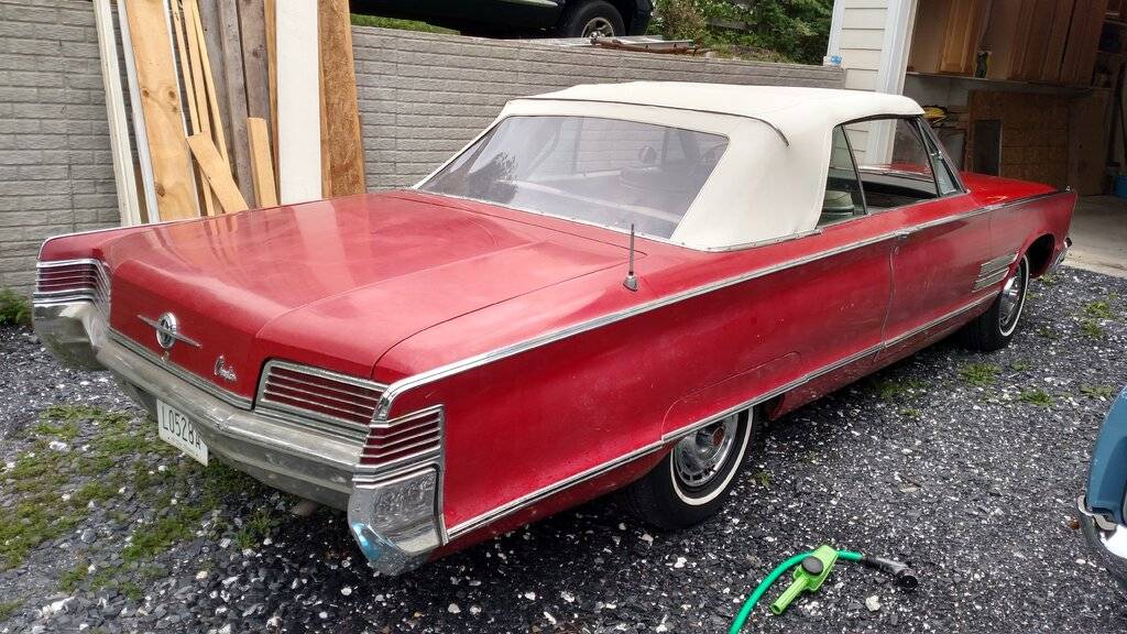

In '66, disc brakes were an option, and they came with 15 inch wheels.
What car is in that picture? That is a very different tail light configuration than my 66 Newport
