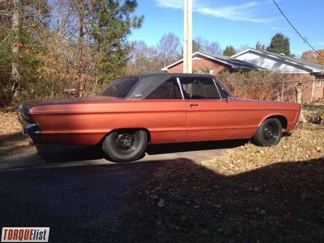

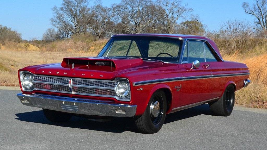

Really want to do more of what I call super stock look or race look over what I have now. The issue is I have a clue what size tires and setup to go with tho. Below are a few photos of idea of wheel combos I like;) if anyone has similar setup would love to see them.

I understand, but I've been unsuccessful in finding any Cbodys with these kinda setups or look. Most have either newer style big wheels or class keystones and cragars
Well that and the stance I guess. Really just like the look. I'm sure I can run a 15x8.

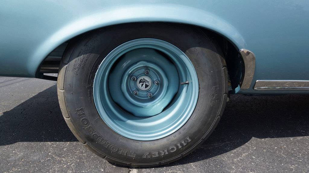

Would 295/15 work in the rear without modifying it? Below is what size I would like on the rear end (blue wheels) and wouldn't mind the fronts on the other car just not sure what size those are.

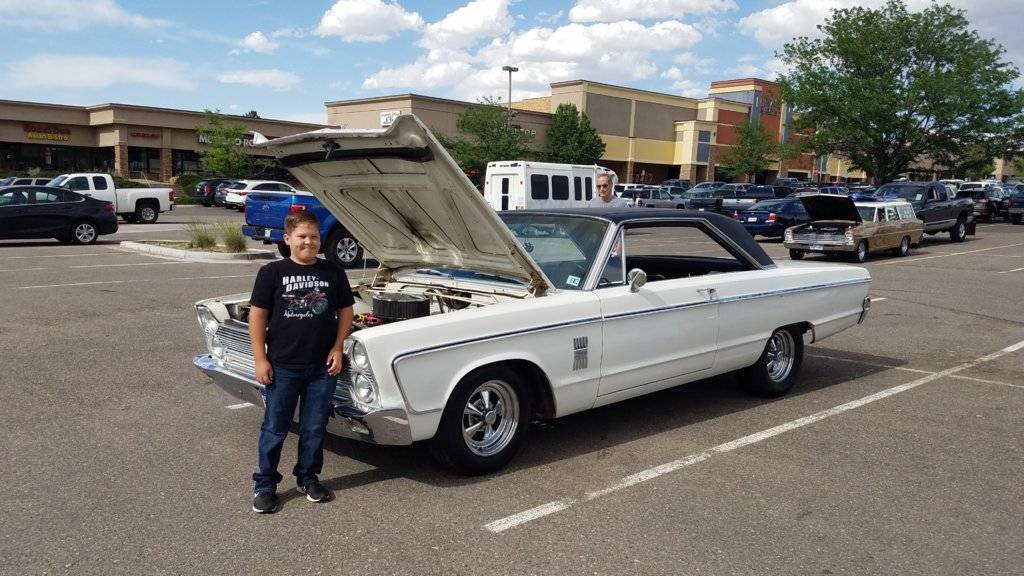

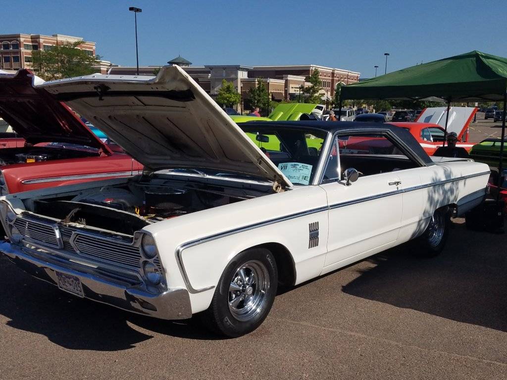

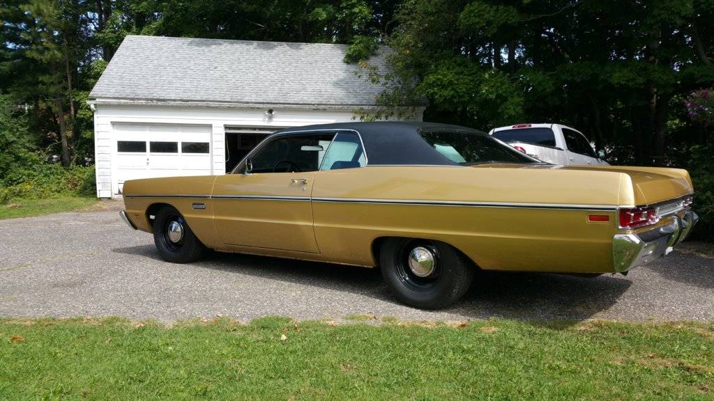

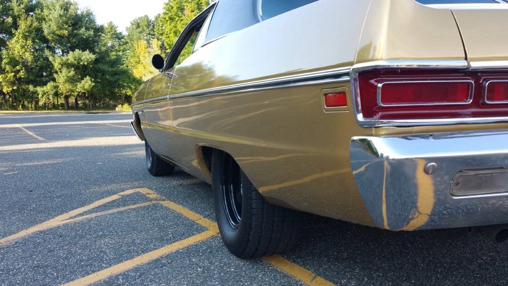

I have on the rear 15/8's on my 69 Fury III with 275/60/15's. 15/6 in the front with 235/70/15.

Might be able to run a 15x10 on the back if the offset I guess is correct and then I could run possibly a 295 tire? By the way your ride looks sharp

No, 275 is pushing the limits, you might squeeze a 285 with just the right rim, I have a 14x8" rim and I have millimeters on the fender side, and about a half inch on the inner side, I'm wondering if the 15" rims I got for the rear will even work as the offset puts the wheel inboard more. Tire clearance isn't an issue anywhere else. I like the look you're going for, it might be worth it for you to spend a hundred bucks or so on one of the wheel/tire measuring tools, unless you like collecting wheels that don't fit, like I've done!
So 275/60/15, would those fit a 15x8 inch rim then? I forsure am not into collecting of wheels lol.
Well the tires fit my wheels just fine,but like LocuMob said I do wonder if they will fit in your body style. Your car is a bit smaller so I can only guaranty the fit for a 69 Fury. I had found what would work on my car here following a build of another 69 Fury 2 door. He installed the wheels on his car that I liked very much. So I just ordered what he had just bought and installed them , so for me no guess work.
I believe the rear wheel wells on your car are smaller than my Fury's are so do your research to find out what works. I know the data is here in this forum somewhere or one of the experts here of your year car will chime in.
